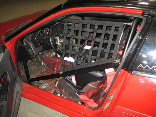

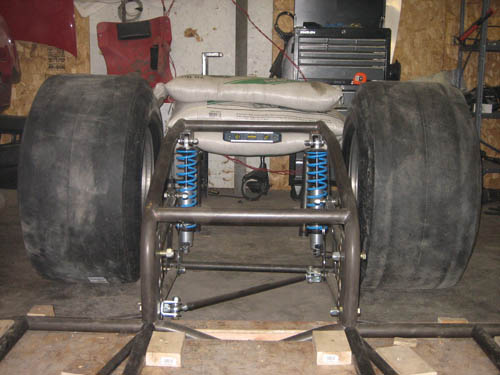

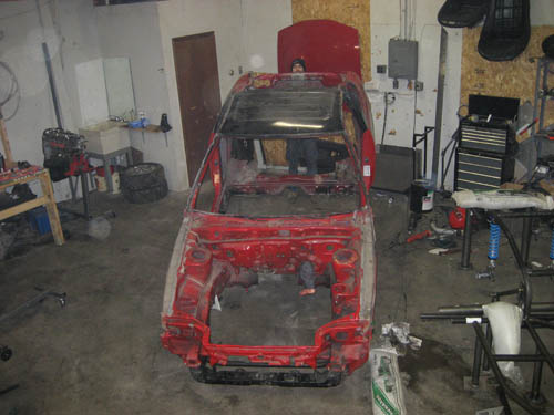

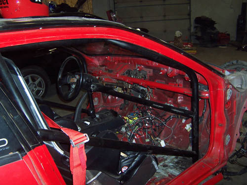

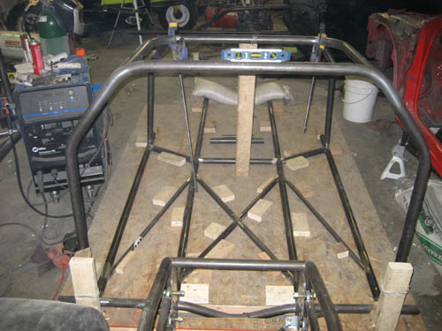

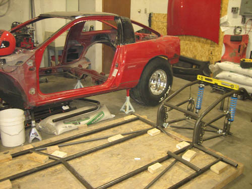

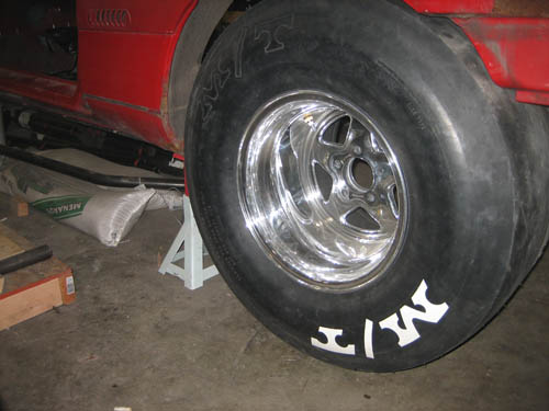

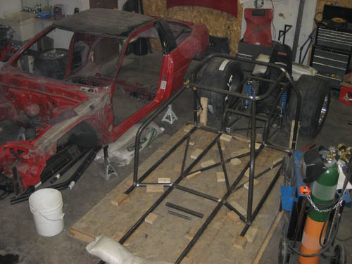

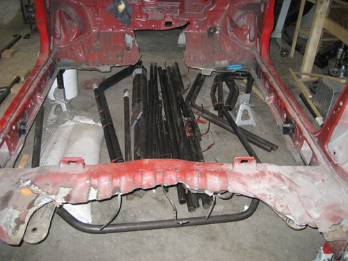

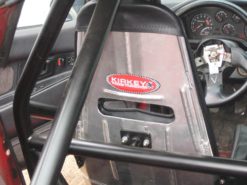

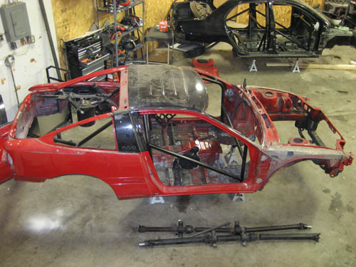

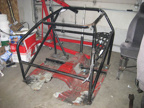

I figured that since Tim let the cat out of the bag ... I might as well too. The GSX is getting completely hacked apart and becoming a RWD tube car.
Here is some history ....
I got the car from Steve Hill and had the moronic idea of having a nice 12 second daily driven car. After buying a 3" Thermal it was all over. The car got a built motor, an FP3052 & some supporting mods. It made 451WHP and ran a 12.1 ... later on that was not good enough .. the madness continued to an 11.5, then an 11.2 ... and 11.1 and finally a 10.97@128.99. Best trap was a 129.98 with a whopping 1.88 60ft time
I stripped the hubs of my Quartermaster this fall and the car was down for a while. So Tim (EvilEvo) and I decided that both the EVO and the DSM will get lighter and get bigger turbos. Initially we both wanted to partially tube the front and cut out the rear floor. Then somehow with the help of a lot of Vodka-Redbulls we decided that we should go RWD ... then later it all evolved into lets hack the cars apart, sell all the stuff we don't need (everything), buy a welder ... learn to TIG weld and build 2 full tube chassis cars.
My FP30 and some other parts turned into a Miller Syncrowave 200, we rented a garage, bought a ton of pipe from the local FleetFarm, a chopsaw, united all the tools and started practicing. Initially there were some really disappointing moments, kinda like WTF did we just do ... but as time passed we got more confident and started seing the light at the end of the tunnell.

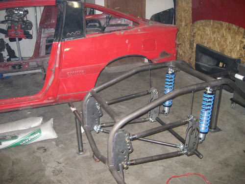

Enough with the BS ... back to the project at hand. The idea is quite straightforward. Remove floorpan fron the DSM, cut the front, built a 25.1E tube chasis from chomoly ... fit it in the DSM, get big-ass tires and auto tranny, a beefy rear-end, a GT4202RV, fab whatever is necessary and go fast.
Here are a some pictures of the progress ... Hopefully it will be road-worthy later on this year and be in the single digits.

Fleetfarm sells Chrome Moly DOM tubing? It looks like you can re-use your lower frame jig, looking good.
~John

Fleet Farm does not sell chromoly (although if they did I would be their #1 customer). We just bought quite a few 10' sections of crappy pipe to practice notching and welding different angles.

Damn Vassil, I was wondering what you were doing when I saw you selling stuff off on NABR. Are you going tuck the slicks way under, or leave the back high like Buschur's old RWD? I'm guessing by the slpe of the fenders inward toward the roofline, you'd either have to mount the slicks way inboard, or keep the rear fairly high. Looks awesome, you guys have got balls. Let the Grey Goose flow!!!!
