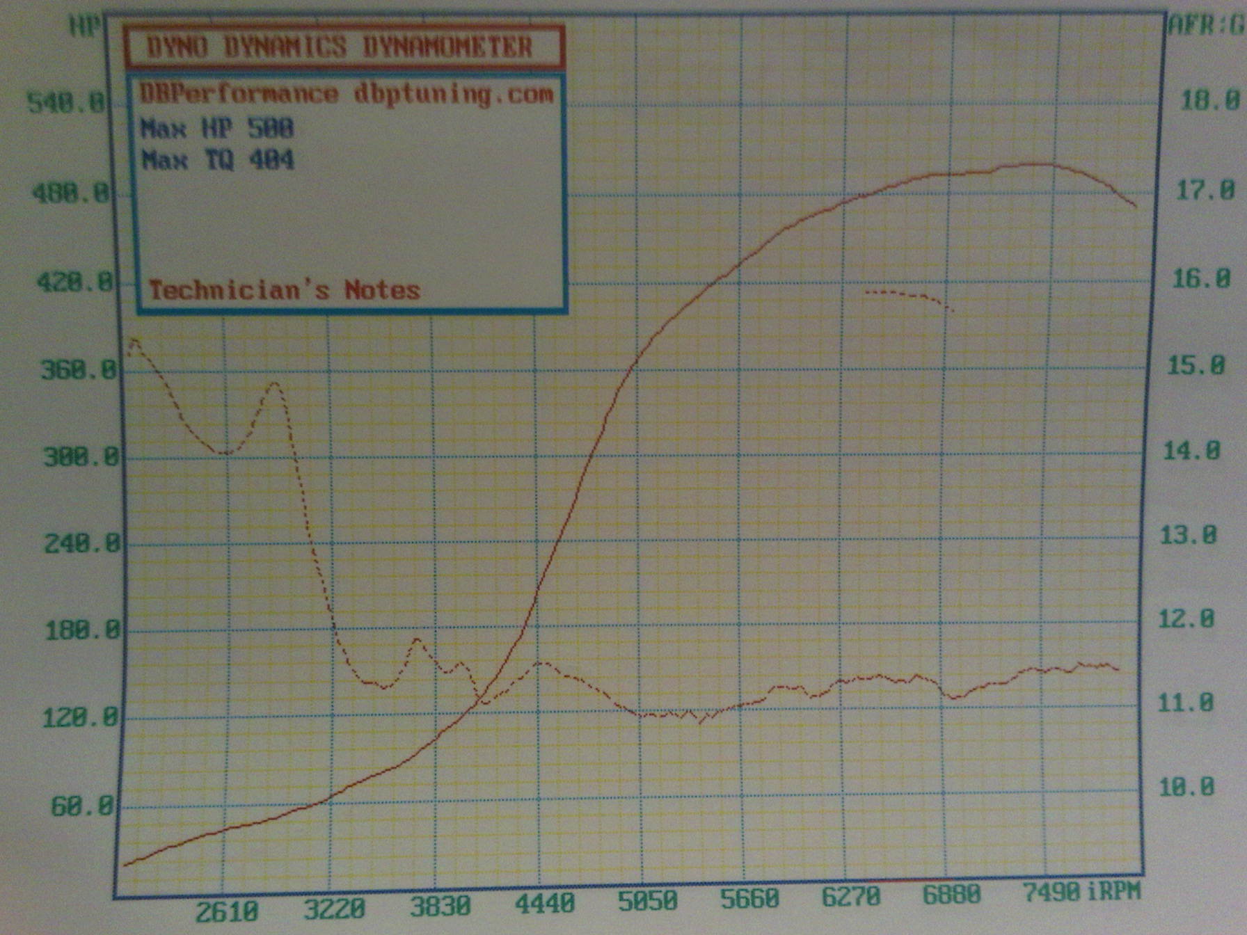

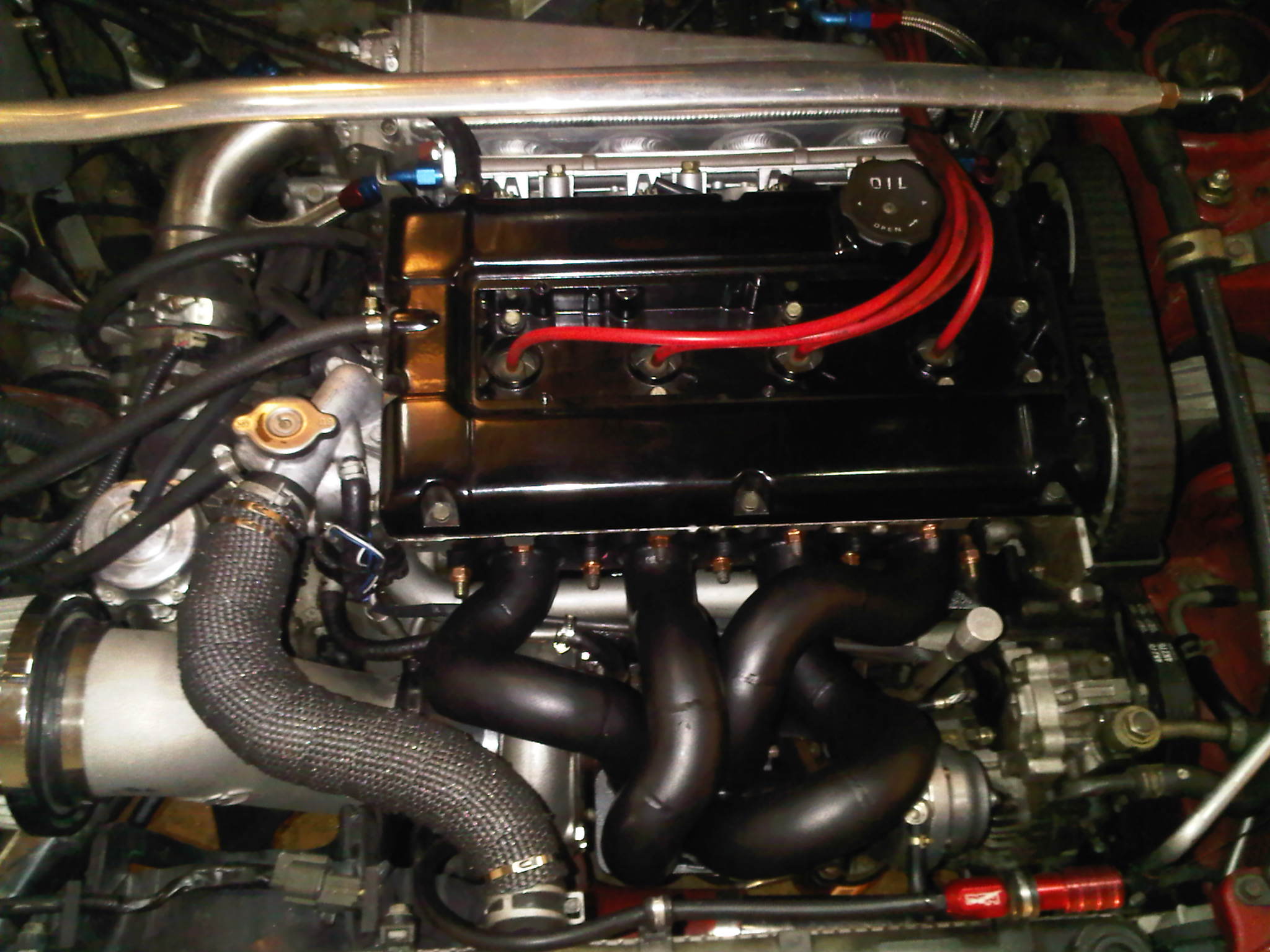

Got the car converted to E85 over the winter and had Shane re-tune it today. The car orginally made 513 at MAP on pump/meth mix last fall and since then I took out the Meth, went to 6an feed line and modded return line, added a Bosch 044 inline and swapped out to 1450 Bluemax injectors. Also had MAP ceramic coat the hot parts. The max run we did was only about 32 psi as the car was starting to push a little bit of coolant. Managed to just break 500 whp ( 583 whp converted ). Was pretty happy with the results, but I need to upgrade to some L19 studs and I need to work on my crankcase ventilation a bit.

Badass! Can you post a basic mod list? Fantastic numbers. Get some L19s in that thing and come on the cruise!

gt35r ( .63 hotside )
Punishment T3 mani / 3in o2 housing into 3in full exhaust
Tial 38mm wg ( external dump )
BC 272 cams ( straight up )
BC springs / retainers
Mild port work on head ( 7 bolt )
Wiseco 8.3:1 pistons / eagle crank / rods
JM SMIM
2.5 IC piping / Tial 50mm BOV / spearco front mount
GM MAF / translator
DSM link V2.5
255 intake ( rewired )
bosch 044 inline ( seperate relay/full time run )
6an feed intank to rail
Aeromotive FPR
PTT twin disk
shep stage 3 tranny w/ 4 spider conv.
hallman mbc
I am missing a bit, but that's most of the important stuff...

Nice engine bay and plenty of power!

It's a 2G 7 bolt. Thanks for the compliments, I am pretty happy with where the car is at, but I still want to see just how much I can squeeze out of this 35R. With the small hotside alot of people have said that it will choke you up top pretty good, but from what we were seeing there is plenty left in it... plus can't complain about 30+ psi at 4400 rpm. I am trying to have the car ready for the cruise, but it's a DSM so we will see
