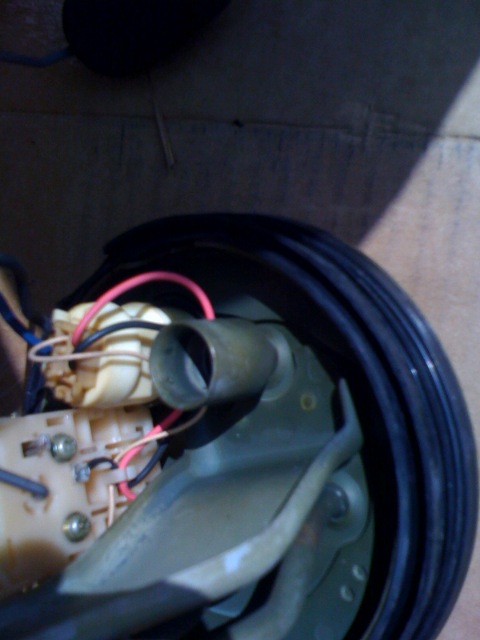

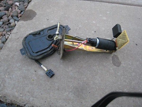

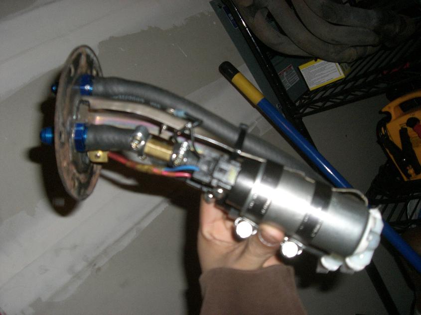

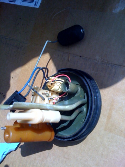

I have a 96 Talon AWD, so the fuel sending unit is under the back seat, passenger side. This past weekend Halon and I were going to install dual 255 fuel pumps (I'm switching to e85 and 1600cc injectors), but we discovered the fuel sending unit is a bit different than on a 1g, so we decided to just install a single 255 for now.
The first picture is of the 1g assembly, taken from Halon's thread. The next two are the 2g version, you can see how there isn't a long metal tube to cut off and connect fuel hose to. Has anyone done this in a 2g without spending $$$ on a custom fabricated unit?
I thought about cutting off the end where the pump mounts and welding on a small metal tube to make it look like a 1g setup, think that would work?

Why not find a piece of hose that is big enough to fit OVER that piece on top, run it to an appropriatly sized T. Then feed the two pumps into that? Curious to see how you gonna do this.
The evo one is similar, but the whole bottom section is plastic. Wondering how to do this on an evo next, possibly....

Use an AN bulkhead fitting, and just eliminate that socket part that the pump plugs into. As shown in my setup here

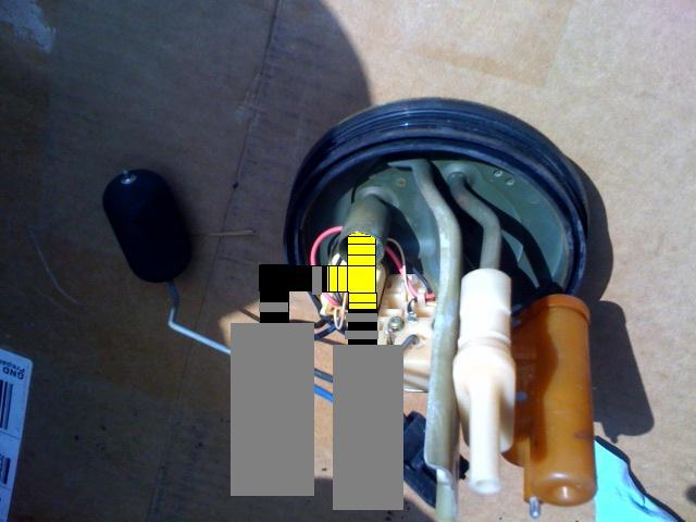

I also figured out a way I can make the dual pumps fit, since the T fitting is the same size as the output on the walbro pumps, I can just seal one end of the T fitting up there instead of a pump, shouldn't be too difficult. Obviously it'll fit a bit better than my sloppy picture.

Your MSPaint skillz are incredible!
