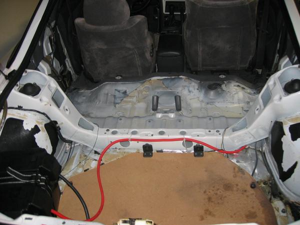

This car will be used as a daily driver/Race car for Drag Racing.
The car looks like it's in nice shape. Why gut the interior (judging from picture 3)?

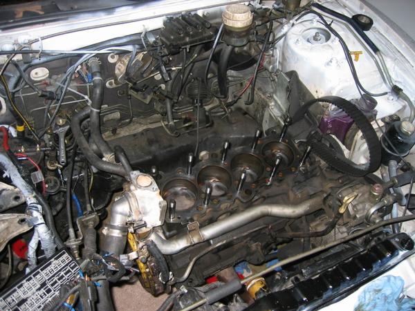

Heres a couple new pics of the progress.
I have thought about a couple things while the engine is out, And, im am thinking it may be time for a new clutch (southbend), and perhaps maybe going with an SCM61 turbo, which then means bigger injectors, (possibly 1000cc) and some other fun stuff. Im am kinda contimplating it right now. but its likely going to put the project back another month before being complete.
So i have come to a couple questions:
Do you guys think it is worth going from a PTE 50 trim, to a SCM61?
Which injectors should i be looking to get?
Should I wait on the clutch and turbo and just get the car in great running shape, or should i say fuck it and get everything done while the engine is out?
Is there anything else i am missing that you think i may need.

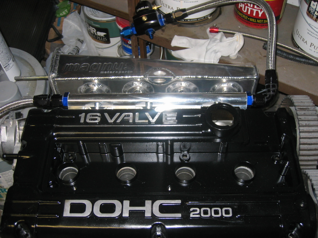

ID:	5191   Click image for larger version

Looking good!
Yes, I would go with the SCM61. They arent really all that laggy.
Is the Magnus intake made different? Looks weird, like it has a patch between 2 and 3 runners. Interesting.
