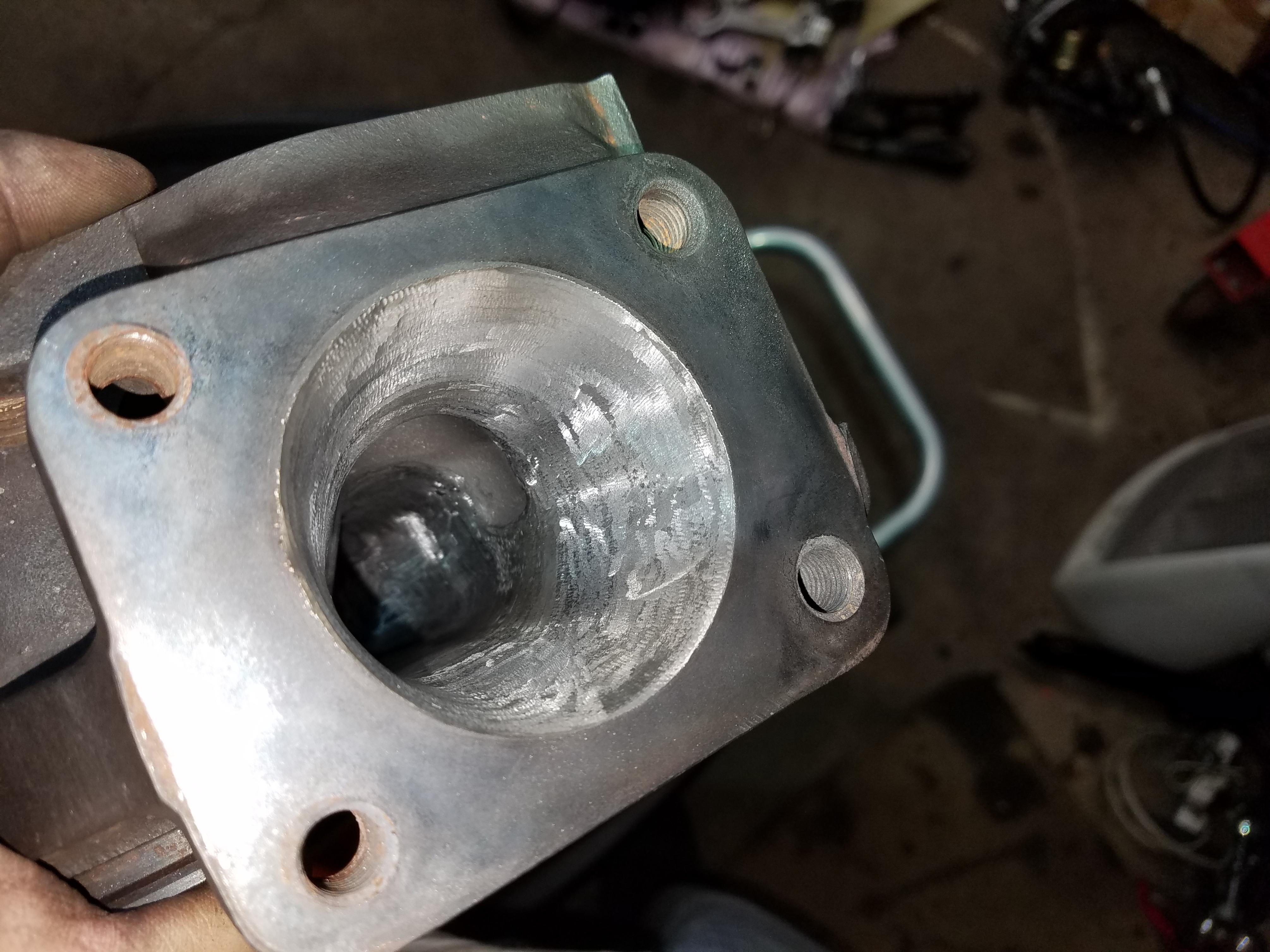

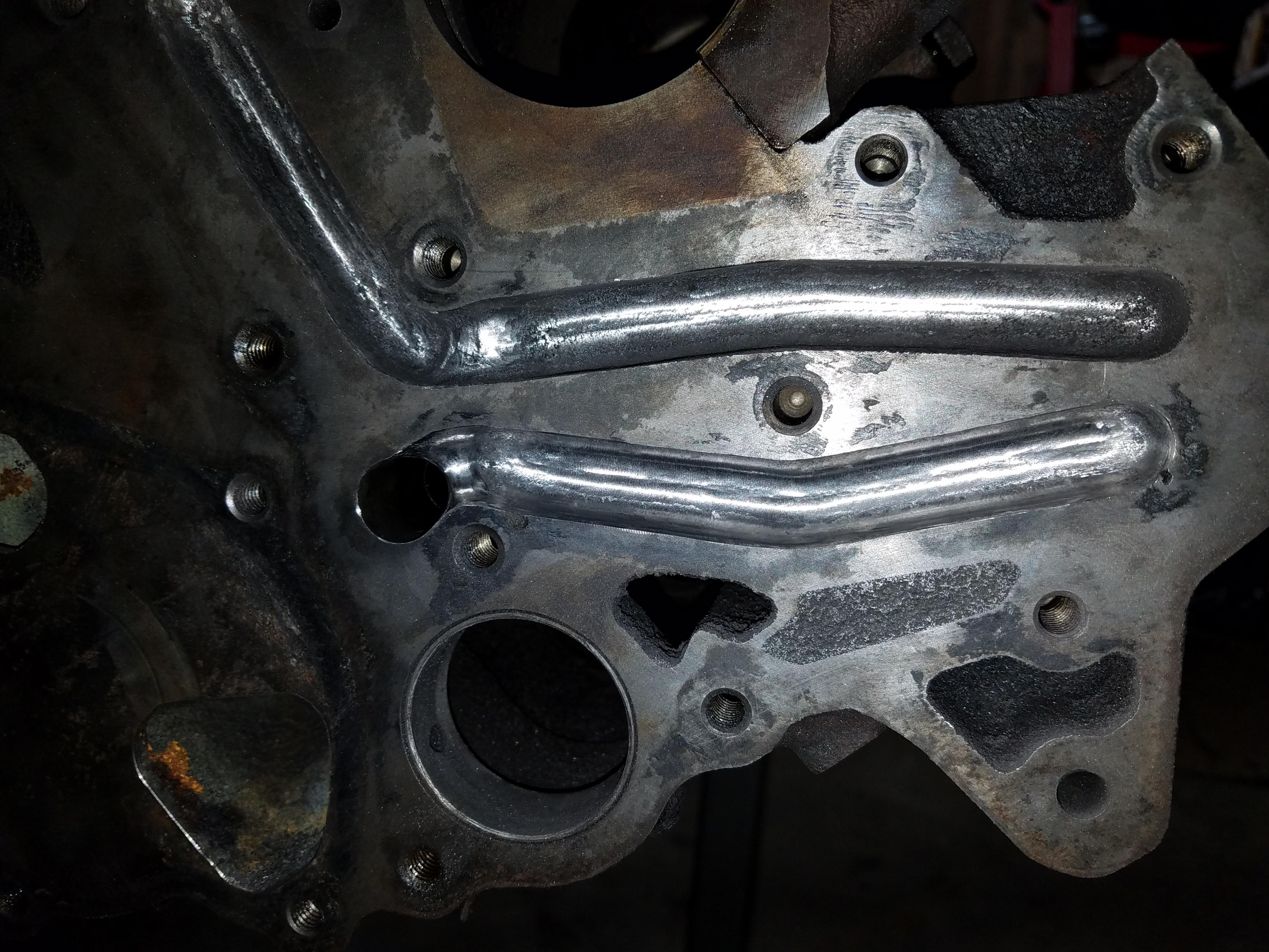

So on to my current status. Reworking a different block.
One of the main issues I believe plaguing my old motor, was the oil delivery setup. Sure pressure was fine when I drove it normal. But spending some time above 7k, and add some corners in the mix and I caught the gauge twitching alittle. This didn't lead to iminent failure. But 3 sets of rod bearings wrecked on cyl #1, suggests oil delivery is a serious possibility. So this winter I am trying to head off any oiling issues short of going dry sump (anyone want to borrow me 5500 bux?). I am doing some oiling mod's learned from jafomobile. Grinding the oil delivery hole smooth. I will be adding chamfers to my crank.
So speaking of cranks. After wrecking a couple, I was on the hunt for another one. This time armed with a 1-2" mic and knew where to measure the rod pin. After looking at a handful of them. I realized my eye alone doesn't tell the whole story. Even the best least abused looking cranks did not measure within spec, they all showed wear on the compression stroke part of the journal (were undersize just in that 1 spot). So with this I decided to have 1 of my old cranks ground 01" under.
And of course, I got a case of since I'm in there's... Girdle, arp mains, align honed (at least checked), deck and fire ring job.
Current question lately is what to do about the oil pan. Can we get a group buy on pan's by Mark? I am seriously considering getting a moroso but I question fitment in the car, looks like it could be fun to fit on the car. Anyone ever use one? Thoughts??

2004 R6 - sold
1992 GSX - sold
1996 GST - sold
1995 GSX - sold
Best 1/4 - 11.7 on 93oct
Best 1/4 MPH - 120mph

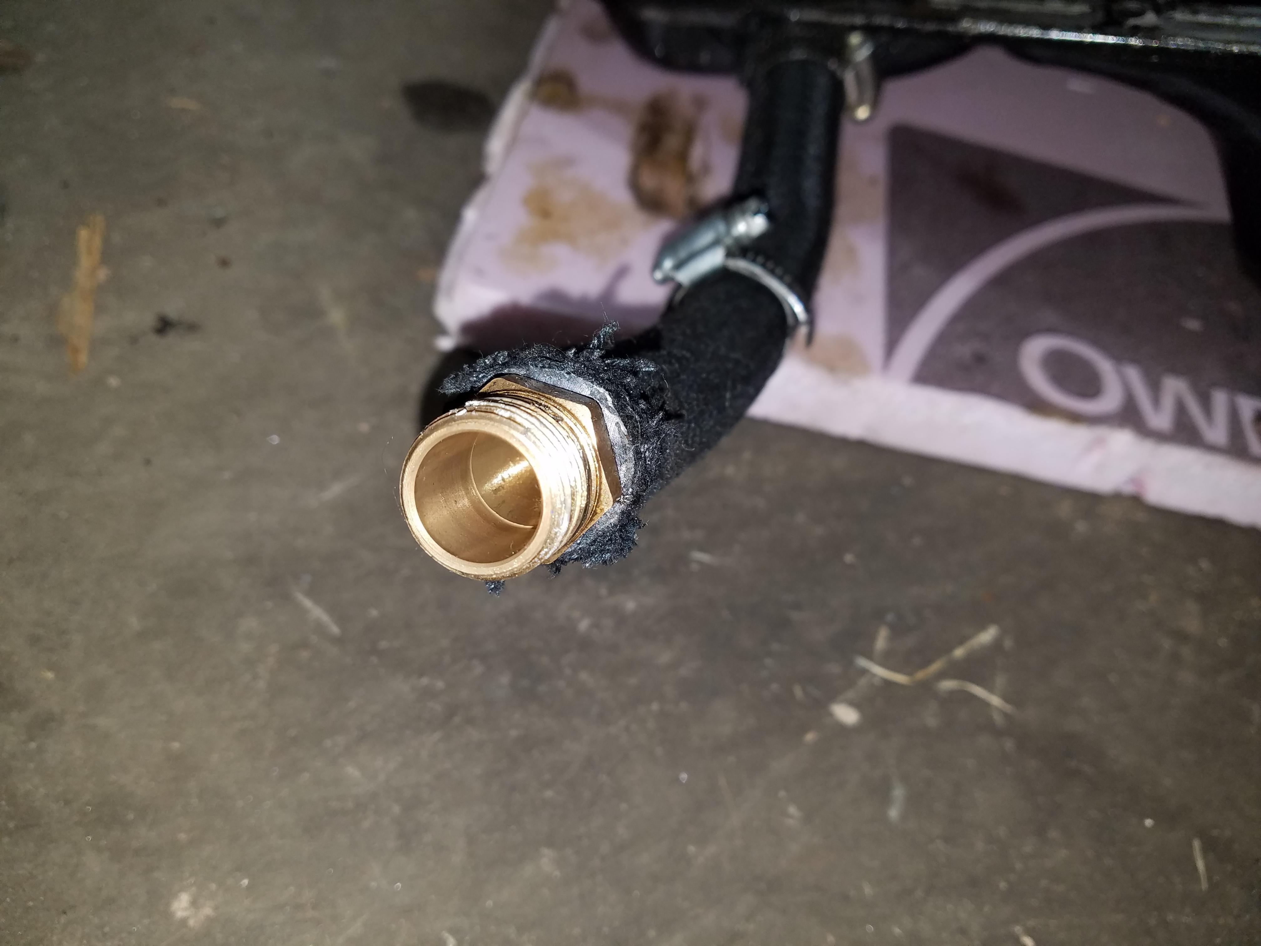

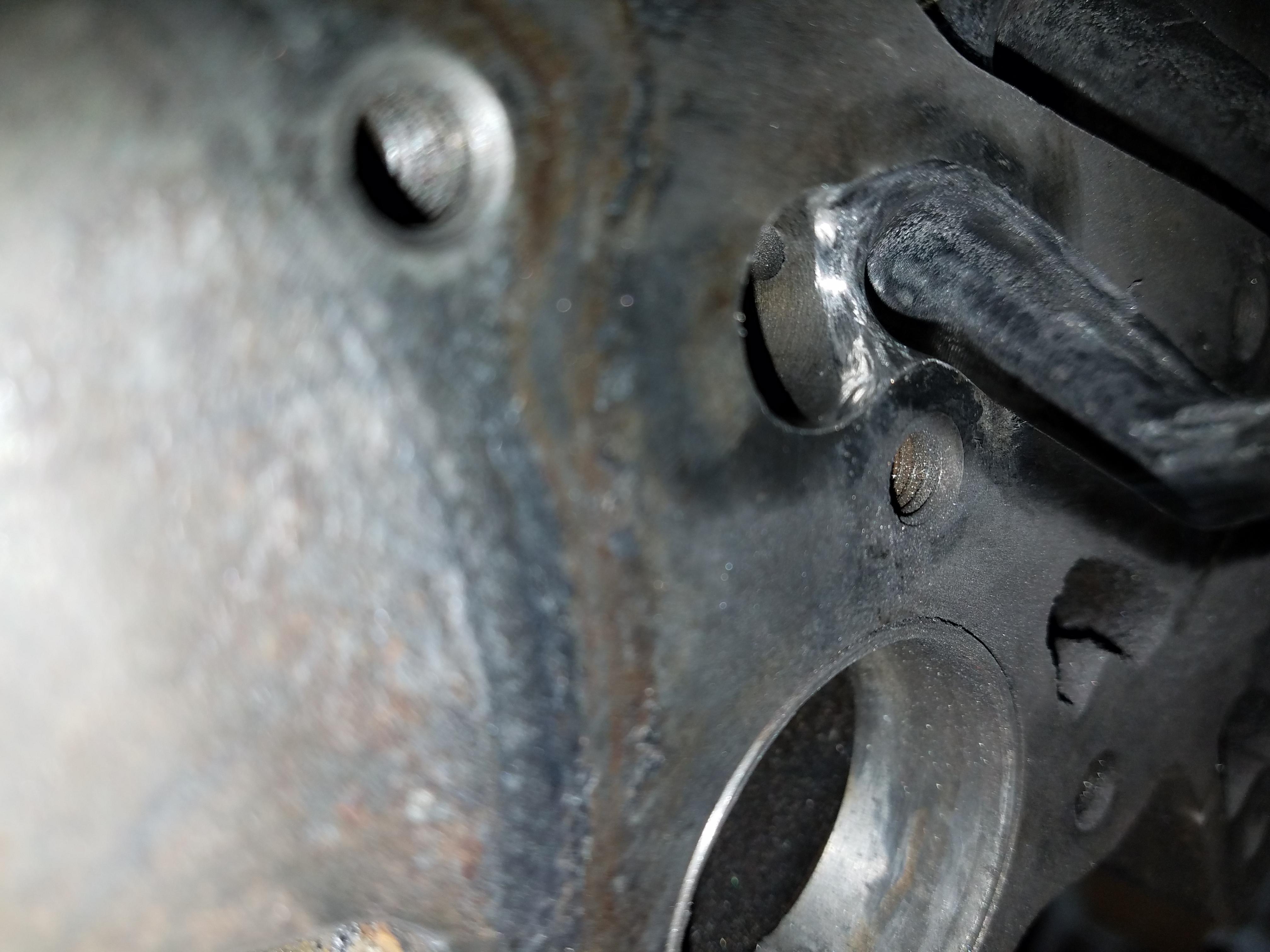

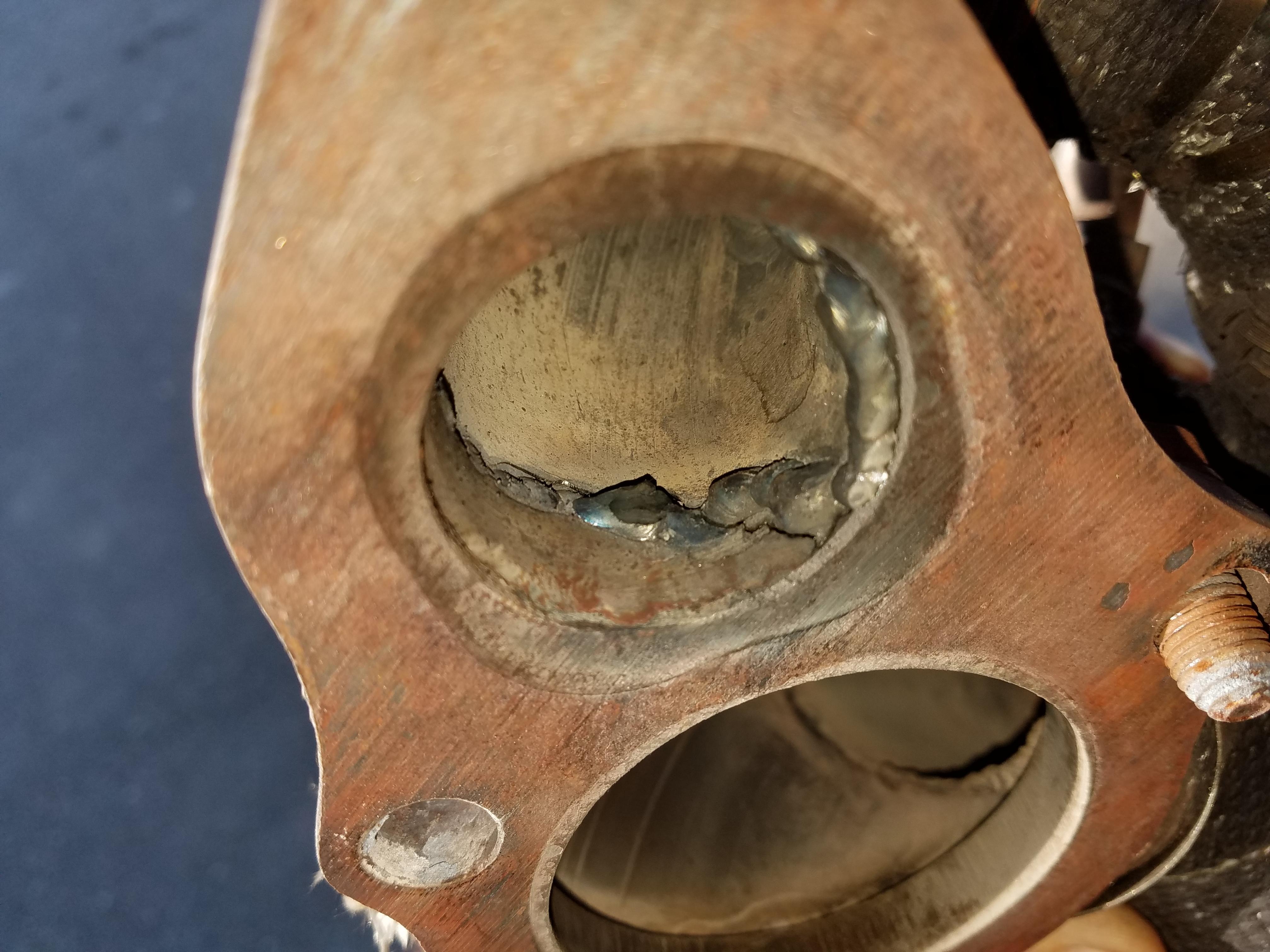

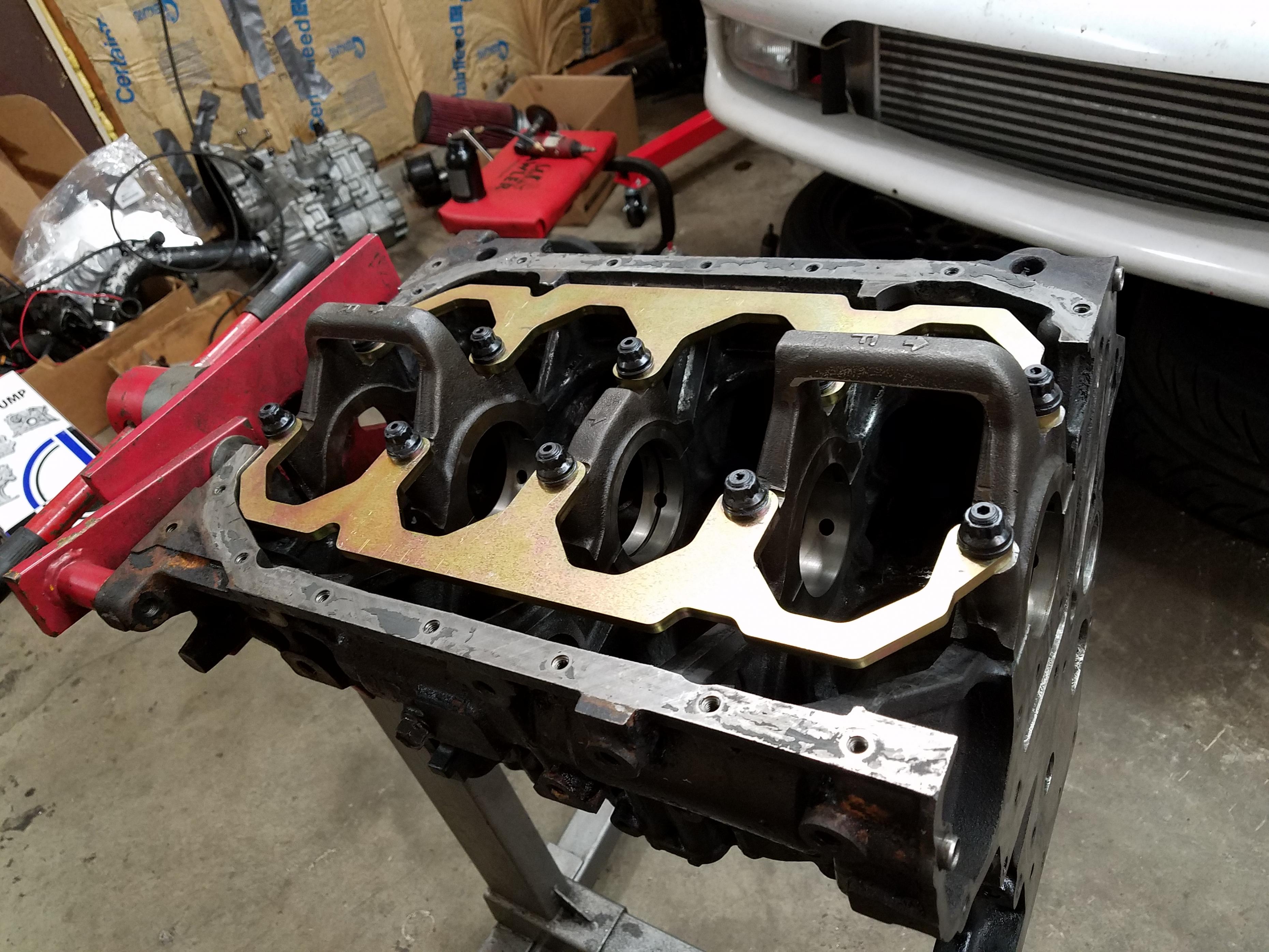

Been a busy past few couple months, but I have a few updates for the dsm. In an effort to help this tiny 8cm housing breathe better with the huge compressor strapped to the other side, I took the grinder to it. I tried to open up the narrow part just after the waste gate vent as much as I dared. Manifold I didn't do much more than take the gating off a couple of the runners and smooth things out, didn't figure there was much to gain there.
Block is back from Gosh. Did a nice job with the rings on that, don't mind the hone job, it wasn't mint to start with, making hp, and piston sealing has never been an issue with any dsm I've had.

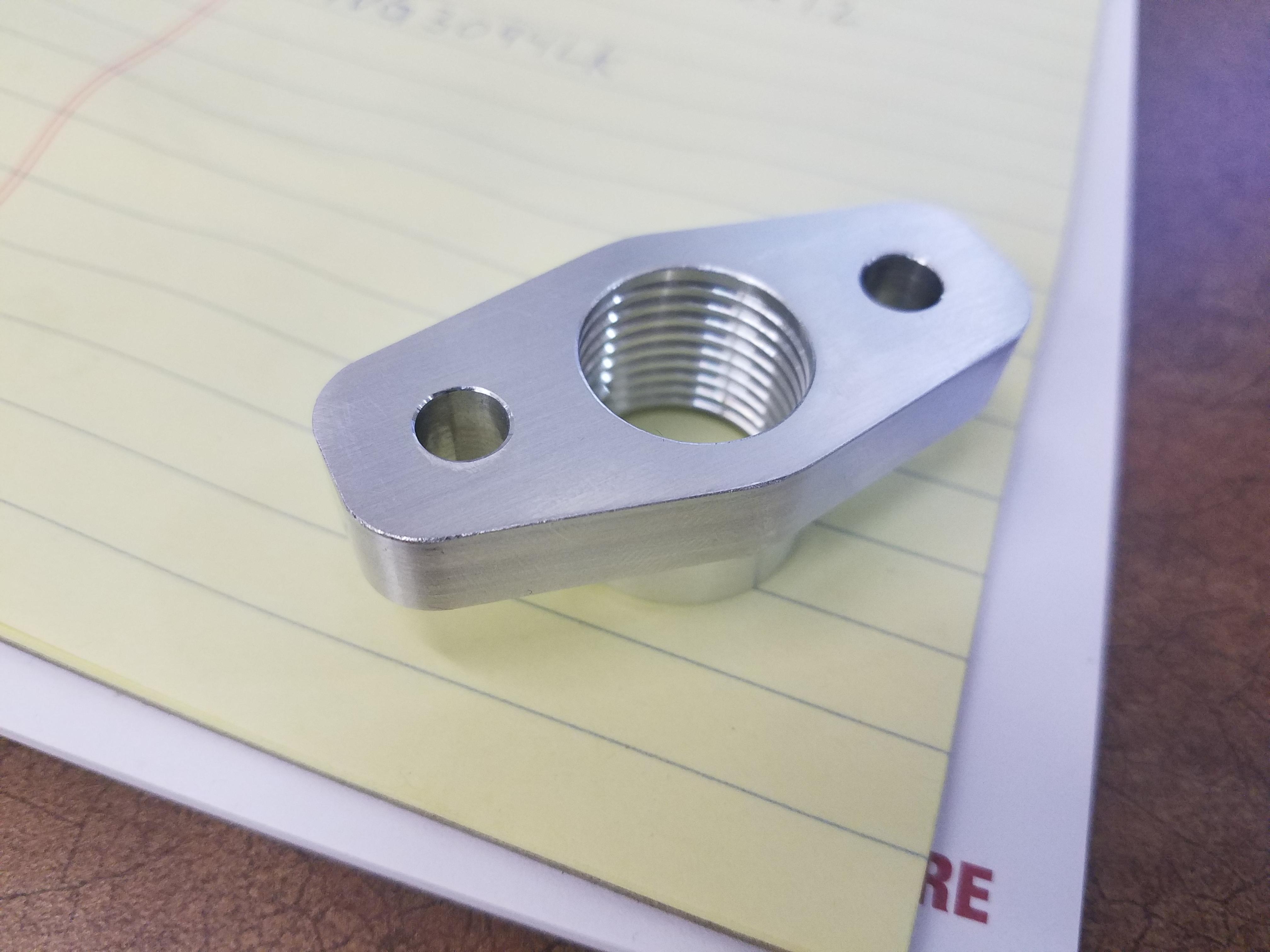

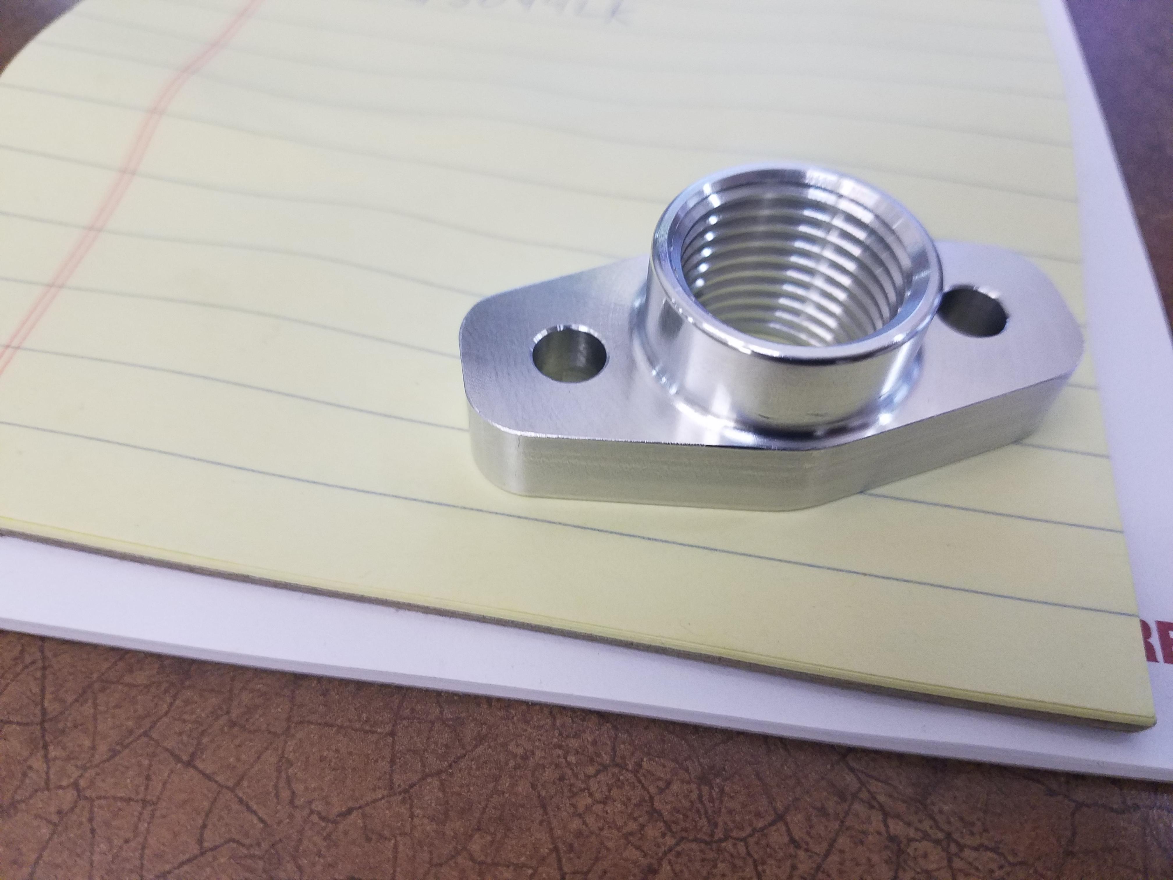

And I don't know about anyone else, but I have yet to find a good drain flange for a mitsu housing that actually worked. So I did what any machinist/car guy would do, I made my own. It's 1/2 NPT, I made it wider than the 1" ones you normally get, and I stopped the threads just short on the ID so the flange side hole would be smaller, to give it more width to seal on the gasket. Along with giving it the proper hole pattern to make it fit the mitsu without a mile of slop. I ended up using 7075, hopefully it doesn't corrode too bad. If I had a piece of 6061 I would have just used that. Reassembly should start next week. Still have to install the fuel line setup, and run some better wire from the CDI box to the coil pack so I don't loose any spark energy from that.
Oh, and does anyone have any 1.5" 321 stainless pipe around? Looking to redo the short part to the wastegate flange on this O2 housing with the right material so I don't have to re-weld it weekly.

Old 04-27-2018   #12
Re: My ultimate streetcar
I like that drain flange, i need to buy one. I'd like to make a complete .7mm+ drain line for my new turbo once i finish with the 16G.
Nice work.
Old 04-27-2018   #13
CarPsyco84
CarPsyco84's Avatar
Join Date: Jan 2005
Location: Coon Rapids
Posts: 804
My drain line is 3/4" push lok hose, have a 1/2" NPT to 3/4" barb that I get from Ace for like 7 bux, and I am going to have an alum barb welded to my moroso pan now. I'm not sure how picky the FP black is with oil returns being that it's a mitsu style housing, but I've ran a garrett that was so I don't want to start going small again and create problems.
