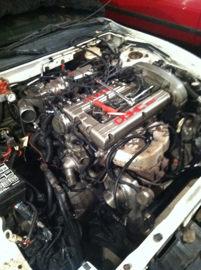

First off car is a 1996 Eagle talon tsi Awd Auto ran great just trans slipped. Has a pte 50 trim turbo a front mount full exhaust and fic 1080s , good start to a project. First off was pulling motor and trans and cleaning up the bay and harness.
Got the motor and trans out Reason for all of this is i wanted to try to clean up the bay coat some parts fix the harness replace the head gasket ect.
Motor is twore down to a shortblock. Now at this point i have to decide what all exzactly i want to do here. Surprise soon

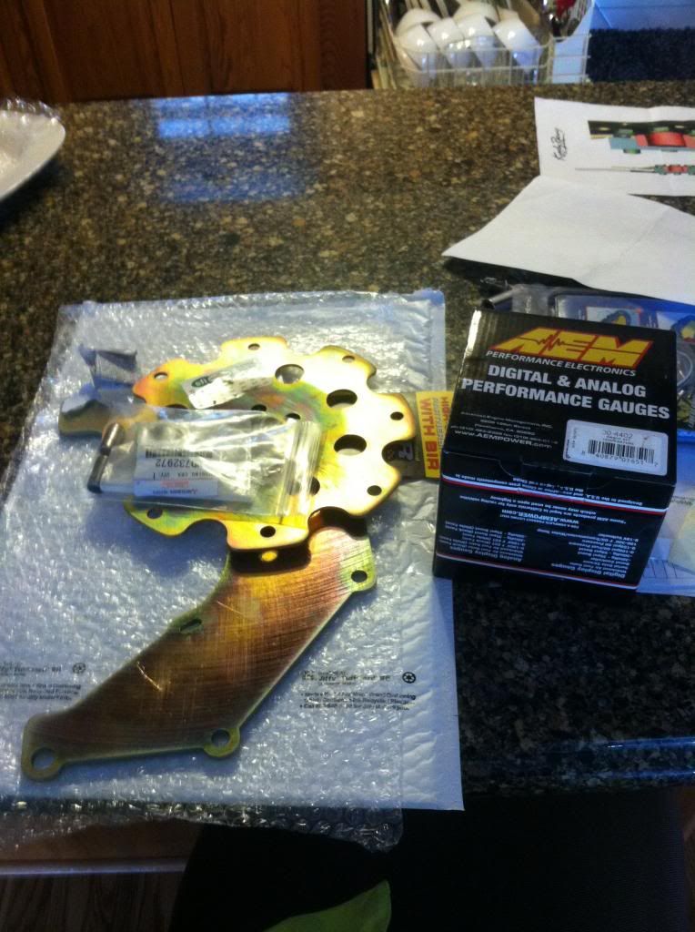

WELL Back from the dead... Spent the last couple months getting parts together and saving. Hopefully it will be a faster process now.
Changed things up a bit Car will be running a scm61 precision bolt up instead of the Pte 50. Picked up a precision restall Kiggly 6 bolt to 2g kit, Working on my trans right now translab shift kit and end clutch packs.
I talked to Foreign Muscle And had My tcu reflashed to run a dual mode Kinda cool idea. Off a toggle i can have it shift itself or go to manu mode for tuning ect.
Have alot left to go hopefully the Next update wont be too long ha. On to some pics !
schmitty1991 is offline   Reply With Quote
