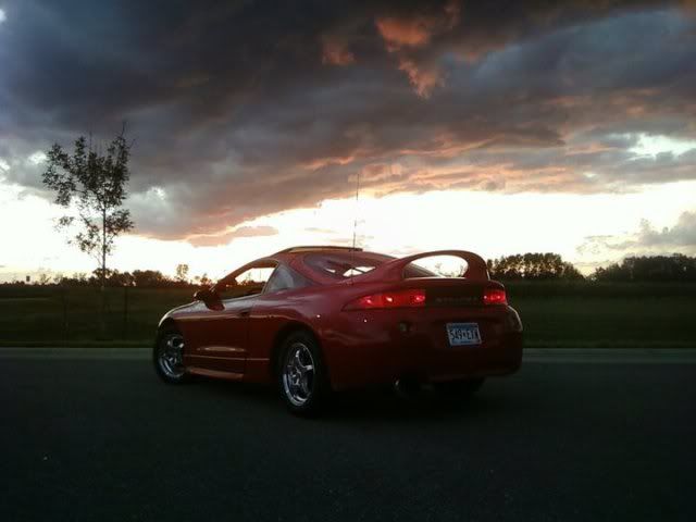

Some of you may know this car from my '95 TSi AWD thread, but for those of you who don't I figured I would start a separate thread just for the Eclipse.
Here are some older pictures.
For some of you, this picture may help you recognize the car a little better.
I do not have recent pictures of it, but not much has changed besides some MAPer decals in the side windows.
One thing that has changed is that I no longer drive it. The reason for that is, I believe it has a bad or blown head gasket. The last time I went down to the Minneapolis area it started overheating. It finally got to the point where my friend and I had to just sit on the side of the road at midnight, waiting for it to cool down.
I added water to the overflow every time we stopped. That helped us get all the way home. Even the guys I work with were telling me it was a head gasket (I work for NAPA).
Just be watching for some changes in the future for this car. I can honestly tell you, there will be
Stay tuned. Thanks for looking!
