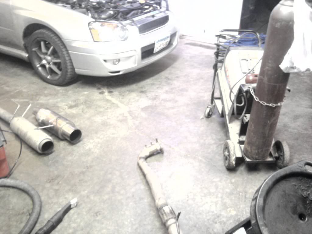

Ive silently worked away with a couple friends of mine. Welding up exhaust,

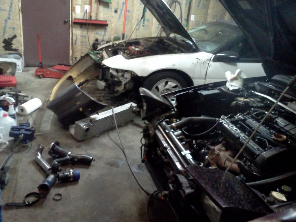

installing a FMIC,
installed a Dual wally set up ditching my old 190

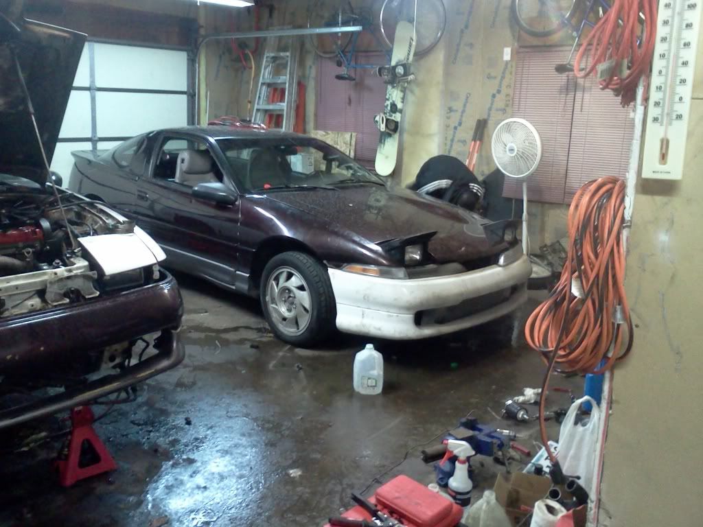

Plans are to pretty much get all the parts installed, do a semi wire tuck, paint the engine bay black. Respray my wheels fuel rail, maybe the front mount intercooler. Have my valve cover painted by Primo wrinkle some kind of color. Overall the theme color for the car is Black and Purple. Most people dont care so much about the exterior look and colors ect. I would like to have my car look tasteful but not ricey and be quick. So thats it pretty much for now. We pulled the replacement engine last weekend while the hurricanes were flying around. It will be transported to the location where my shell is next week. Ill frequently update with pictures ect.
