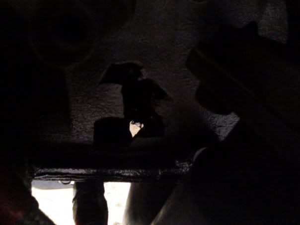

I first noticed this hole in the front of the block.. and you can see through the oil pan!!

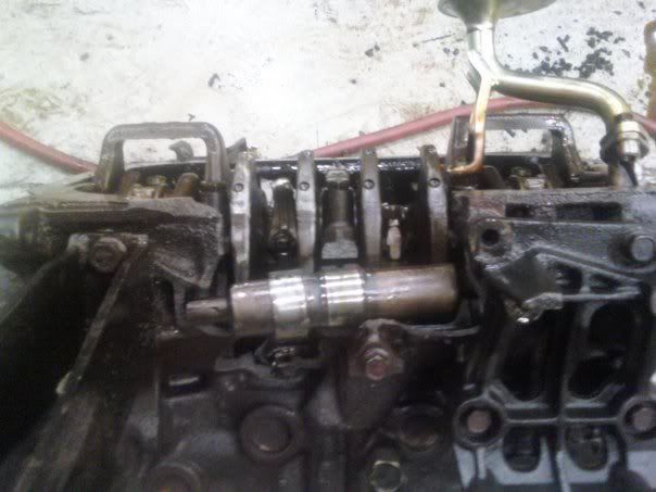

I pulled the oil pan off and with it came the missing chunk of the block.

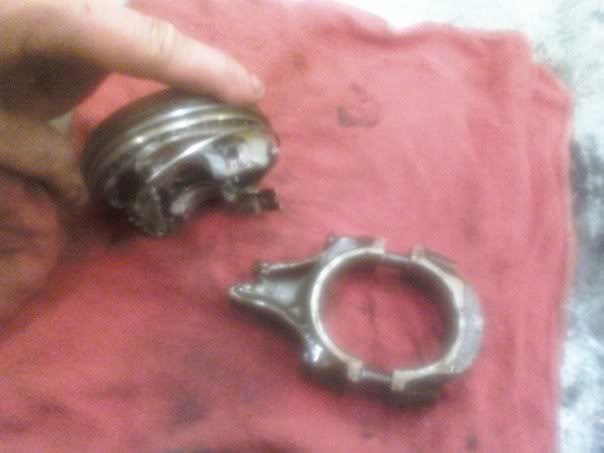

The team that caused the damage!!
Where is the rest of my piston???
When the rear of the block broke out, it broke the balance shaft which caused the gear to lock up and strip off the teeth on the timing belt.. whihc bent some valves... :l
So after all of that, Engine, Head and tranny (which something broke when the motor locked up cuz in gear it rolls like its on neutral) need to be replace.. When it rains it pours..
