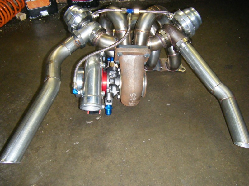

just a little overkill
Yea because everybody needs dual wg's
pics or gtfo
05-23-2008
#2
Re: just a little overkill
I like the SS vaccum line!. But that is retarded overkill.

badass setup for sure and I'm sure i'd sound badass, but it's definitely not needed.

I wonder if it's a divided exhaust housing.

Its probably a divided housing noobert.
05-23-2008
#8
Check the hotside, it has two ports:
You need to keep them separate or you loose the point of it being twin-scroll.

^so are u saying 2 wg's are necessary?

If you only run 1 on a divided manifold/turbo setup, you will either only be venting the exhaust gasses out of only half of the runners. Or if you setup the wg outlet pipe on the manifold to connect to both sides of the divide, well then it's really no longer fully divided now.

Yes sir I am. Next year will be fluid dynamics. But for now, let me tell you about chemistry and calculus and statics and how to make 70 plus part designs on pro-e. I never claimed to know everything, I was simply wondering why I have yet to see a manifold with two flanges for wgs.

You're right, I never asked. I simple thought it was "just a little overkill." I have since learned that it is necessary on that specific turbo. I don't know a turbo by just looking at it unless it's a 16g or a 50 trim.
