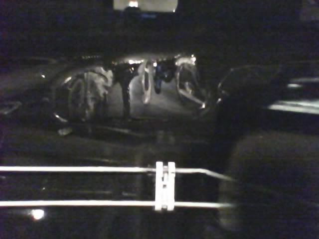

Tar to stck plstic to the door? WTF??

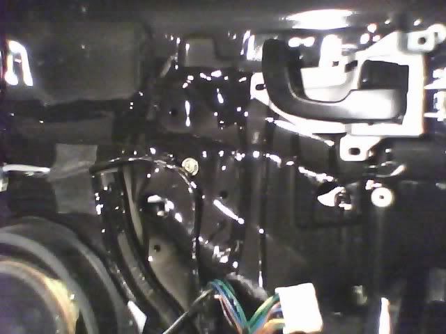

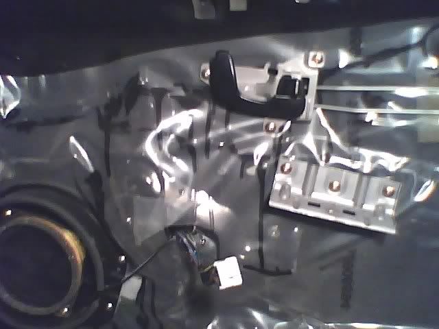

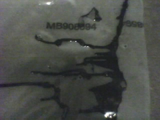

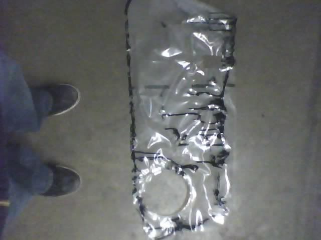

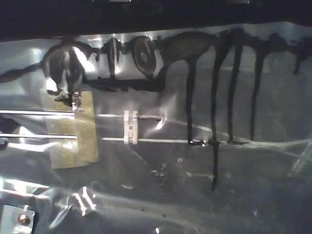

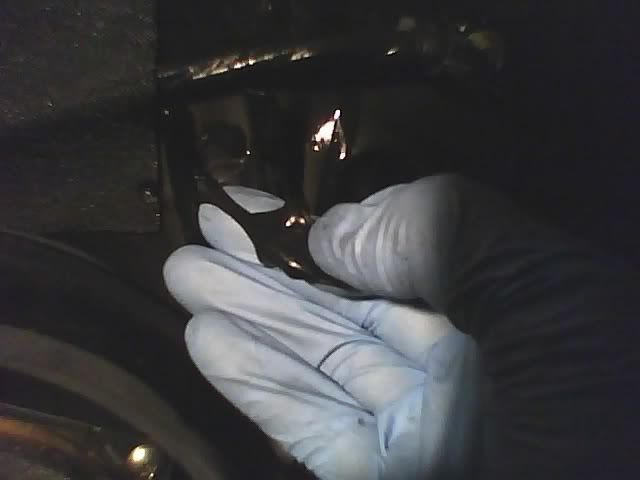

So yea... they used tar to stick the plastic on the door & when it's hot out , it runs down over the lock slide bars & out the bottom of the door... but never again. I got rid of it all with a plastic scraper some goo gone and lots of rags & elbow grease. I also cut new door plastic & used silicone to stick it on.
Heres what causes 99% of lock problems in 2G Eclipse doors!

You wear gloves to work on your car? lol. j/k. But yeah, they've been using tar for a long time. my quest has it.

Ugh that brings back bad memories! I had that door panel off probably five times while I owned that car, and everytime it looked worse and worse under there. Smart move on the silicone!

OH NO!!! I just fix this on the one I'm selling... Your telling me I'm gonna have to do this again! UGH!!! well at least I'm a pro at it now.. shouldnt take me long to do two more doors....
LOL! I work for a glove manufacturing distributer. Gotta protect yourself from all those harsh chemicals.

I agree. But I have never seen it melt and run like that before.

My '99 GSX is the same way. Sucks when it's hot and humid out because it will run and drip down onto the side skirts of the car. Then I have to use tar remover on it. Very poor on Mitsubishi's part.

just do what I did & you'll never have the problem again!
