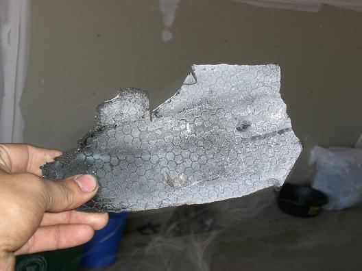

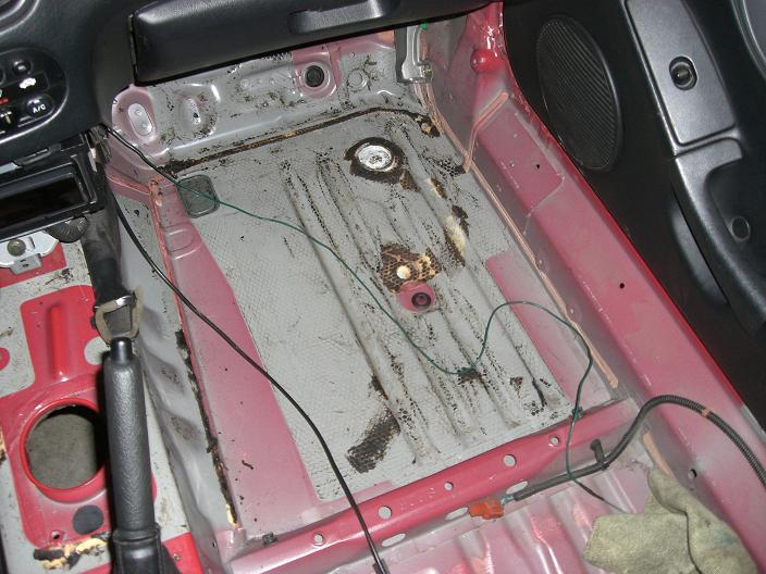

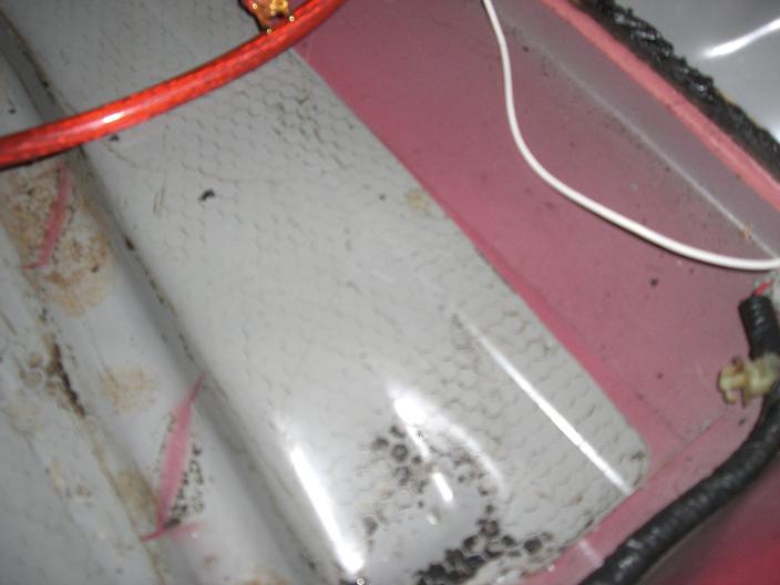

The dry ice worked amazingly well. No sticky residue left over either. I'm happy w/ the results. The $13 is worth the effort and time it saves. Oh, and for anyone that wants to do this in the future, don't pour water on the dry ice in the car because you think it'll look cool, you just end up making a mess... Don't ask me how I know...

Nice! I always heard people suggest it, but never saw pics of results or heard anyone first hand who had tried it. That looks like the way I'll go when I build a road race car.

It was sweet, i just slide the crowbar underneath one side of it, it took out almost half of the pad that was there, def. worth every penny on this one.
