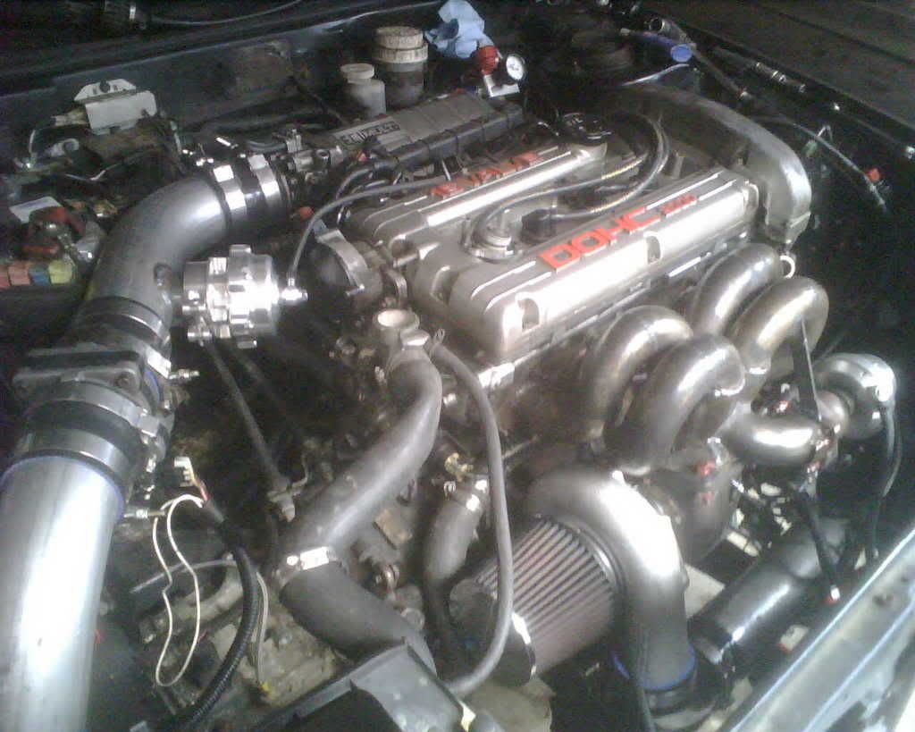

Got the car running last night!!!!
WooT car ran last night for the first time in about 7 months!! everything is almost ready for the road. Just need to get my radiator in, new gas, plugs, and paint my intercooler piping!!
Insurance starts on the 23rd!

Do you want to let out any specs on the set up besides a full T4 turbo, 3"ic pipes, Maft, big fmic, ramhorn style header, etc? How do vent your bov with out problems?jk

I am curious about the BOV placement too, shouldn't it be before the MAFT?

Idk haven't tried it yet. I can always move it. I didnt really think about it lol. Its still the 2.4L crower 415 cams, header?? idk was a t3 made by obx? I bought it from Kyle from MAP. I cut the t3 flang that was on it off and put a t4 on. Dsm link car and thats about it. I have the bottle mounted in the trunk, I'm just not sure if I'm going to use it. I thinking it should spool 25-30psi around 5200-5500.

Swap the BOV to pre-MAFT. Looks good otherwise.

*tubular exhaust manifold, sorry.

I didnt mean that in that way. I was like header??? idk what brand not, its not a header!!! lol Sorry John. I'll sway those two i/c pipes around and ill be set!

And +1 on the MAF-T thing, just flip that pipe around and stick the MAF-T up to the throttle-body.

I'm guessing that hose wont be kinked either when youre done? can you say kaboom OH NO COOLANT ALL OVER?!!? Unless im mistaken and that isn't the coolant line.

Yeah, I was going to say, uncrimp that upper radiator hose. But then you said you don't have a radiator in yet.. so that may be the reason.

Notice I said I still have to put my radiator in.... I pulled that hose out of the way to remove my old one.

Looks good. Are you worried about your hood getting really hot from the manifold?

If the underhood heat shield is in place, he should be fine.

Its in place. I might wrap it to keep that part cool. My hood needs paint real bad so I'm not to worried about it lol. I just am waiting for the damn insurance to kick in and I'll be out and about!! Thanks for the comments and thoughts guys!!
