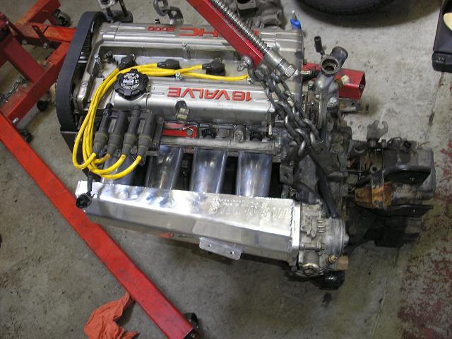

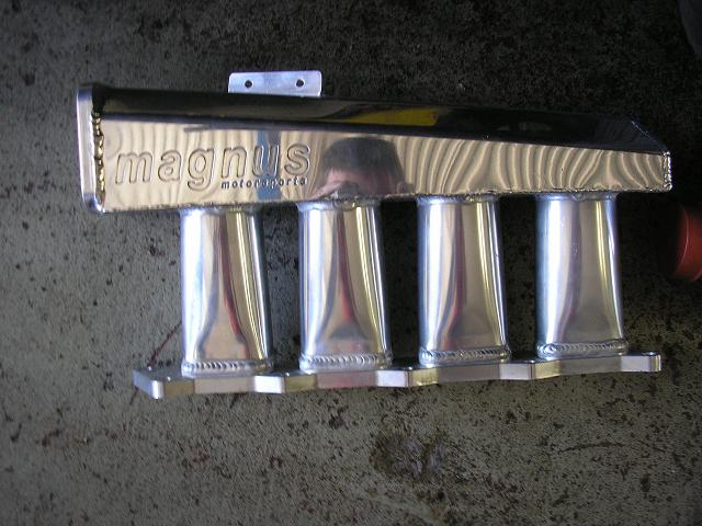

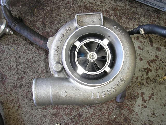

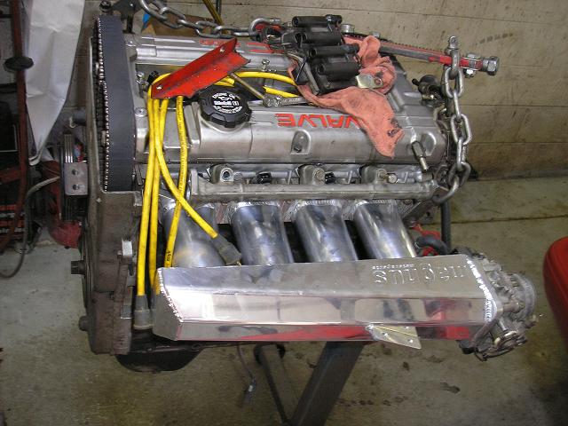

So here's my project. I got the car in Febuary from a kid selling it on MNSC. The car was mostly stock at the time, it just had a small 16g, 2g exhaust mani, a small Spearco FMIC, a boost gauge, and a K&N filter. It had a boost leak, and some crappy plugs and wires when I got it, so the first mod was to get rid of all the worthless Emissions crap, and throw in a decent set of plugs and wires. That cured the boost leak, and made it run better, but I wanted more.
So over the last few months, I had been pinching my pennies, and buying things whenever a deal came my way. I ended up getting a dual ball bearing GT3076 for the new turbo, a Tial 38mm wastegate a Magnus intake manifold, ported and jet coated 2g exhaust manifold, some 950cc FIC injectors, and a GM maf and translator. I came across a pretty good deal on a built motor, so I decided to pick it up. Once we got it torn apart, we found out the oil pump siezed, and spun all the main and rod bearings. Another suprise was awating us as well. I was told that the block nad Wiesco pistons and Eagle rods. To my suprise, the pistons weren't wiesco., They were JE pistons, so that made me happy. All the bottom end needed was a set of bearings, and a crank, so I got a used crank that was in good condition, and some ACL race bearings. While I was at MAP for the crank and bearings, I decided I'd throw some ARP head studs on it as well.
At this point, he only other thing I needed was an intercooler, some couplers, and an 02 housing. I just decided to go with an ebay FMIC, I figured it couldn't hurt to give it a try, and if something better comes along some day, it'll be easy enough to replace. For the o2 housing, I got a weldup kit from Punishment Racing, and I got all my couplers and clamps from ExtremePSI.com.
Last week, with the much appreciated help of Mark (TKRperformance) and his father, we tore out all my old crap and put in the new stuff. Everything went together relatively easy, considering the ammount of custom fab they had to do.
So, with all the talking out of the way, I'll get some pics up.
pic 1: the old setup

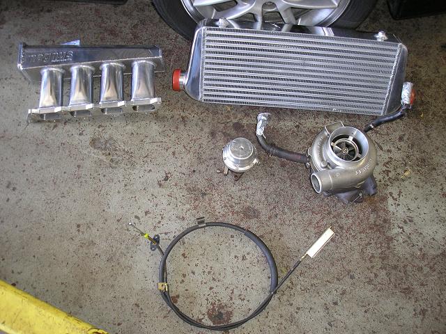

pic 2: the pile of new parts

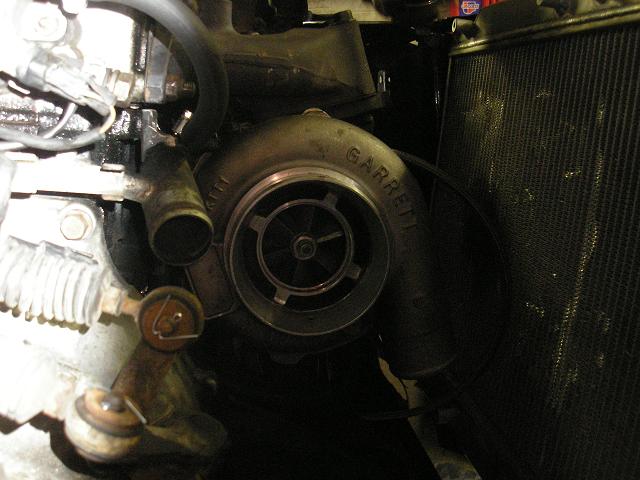

pic 3: the GT3076
pic 4: the Magnus intake
pic 5: the FIC 950's

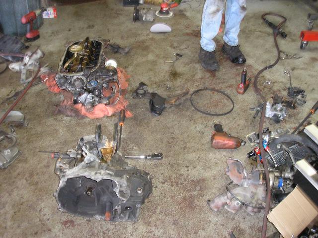

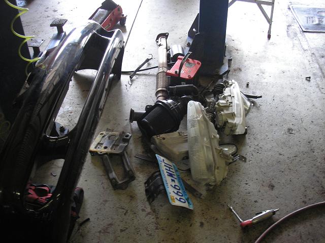

pic 6: the pile of old parts
pic 7: old parts, some re-used, some not
pic 8: the new motor on the stand, ready to go in
pic 9: another shot of the motor on the stand
pic 10: the motor is in!

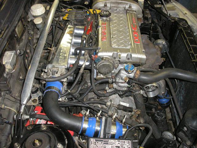

more pics

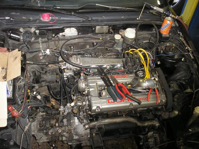

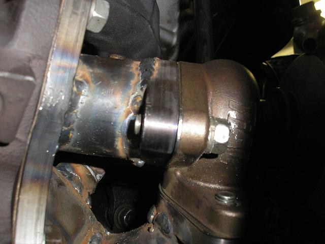

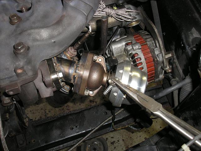

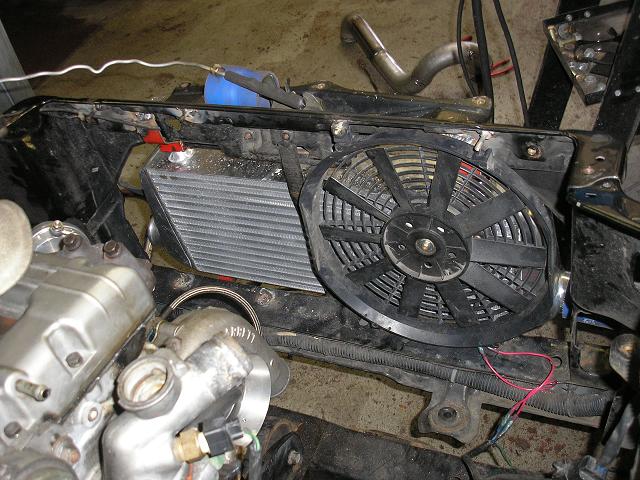

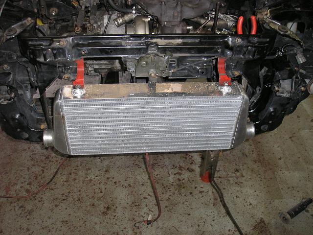

pic 1: the gt3076 in it's new home

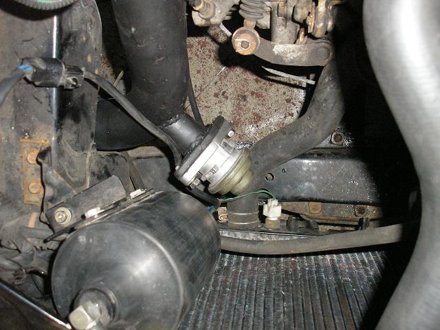

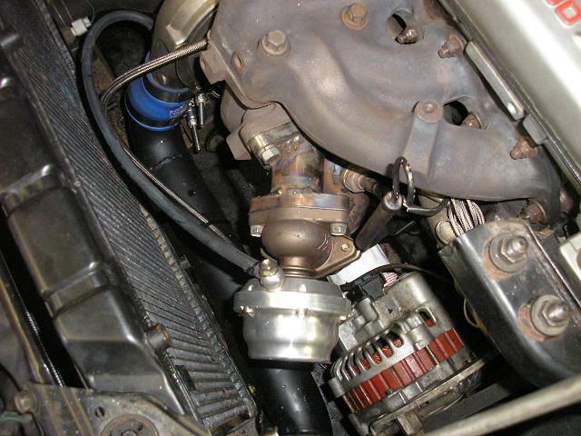

pic 2: the o2 and wastegate
pic 3: closeup of o2

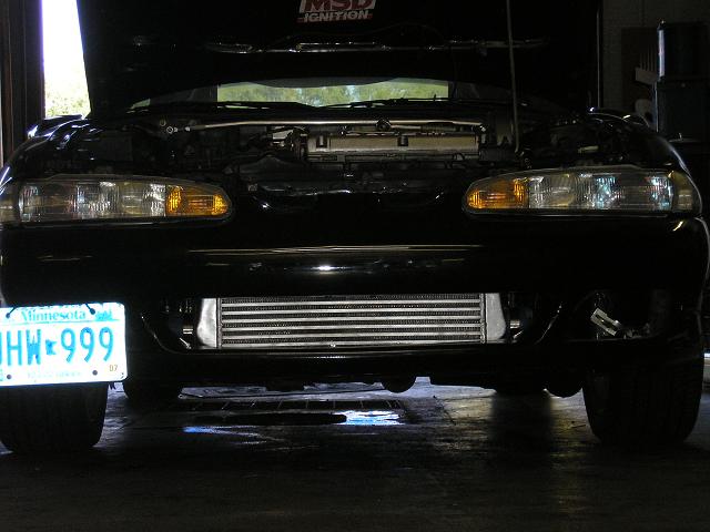

pic 4: FMIC installed

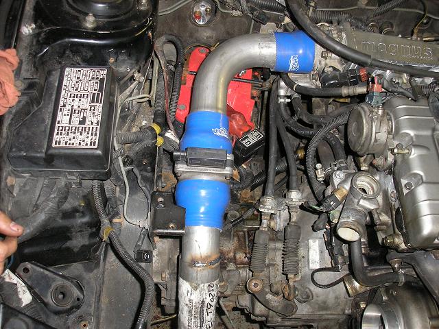

pic 5: Fan Mounted between FMIC and radiator
pic 6: Cold charge pipe and MAF during construction
pic 7: FMIC through the bumper
pic 8: everything in it's final place
pic 9: new coil pack mount
pic 10: another o2 and wastegate shot

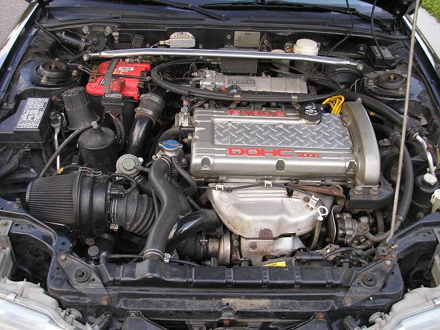

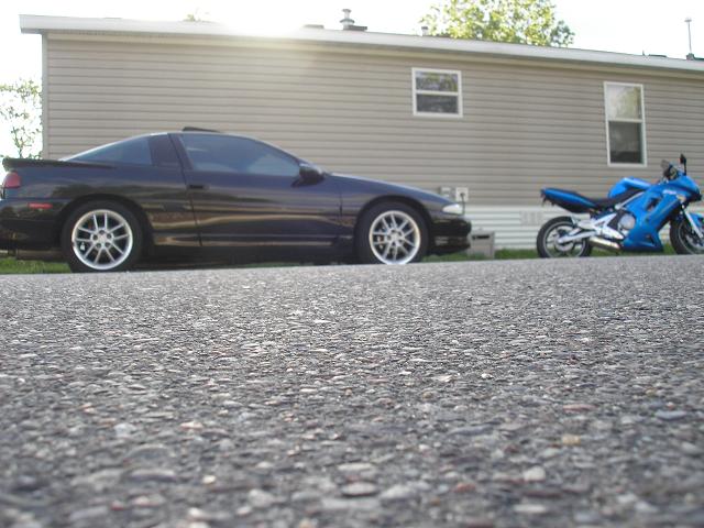

I've had it at 'bee's a couple times, and I'll have it there tonight. As requested, here's some pics of it. They're all from before I did anything to it, so it still has the stock fogs, and old intercooler.
That I know of, Swanny never owned it. I bought it from an asian kid named Joe Young.
