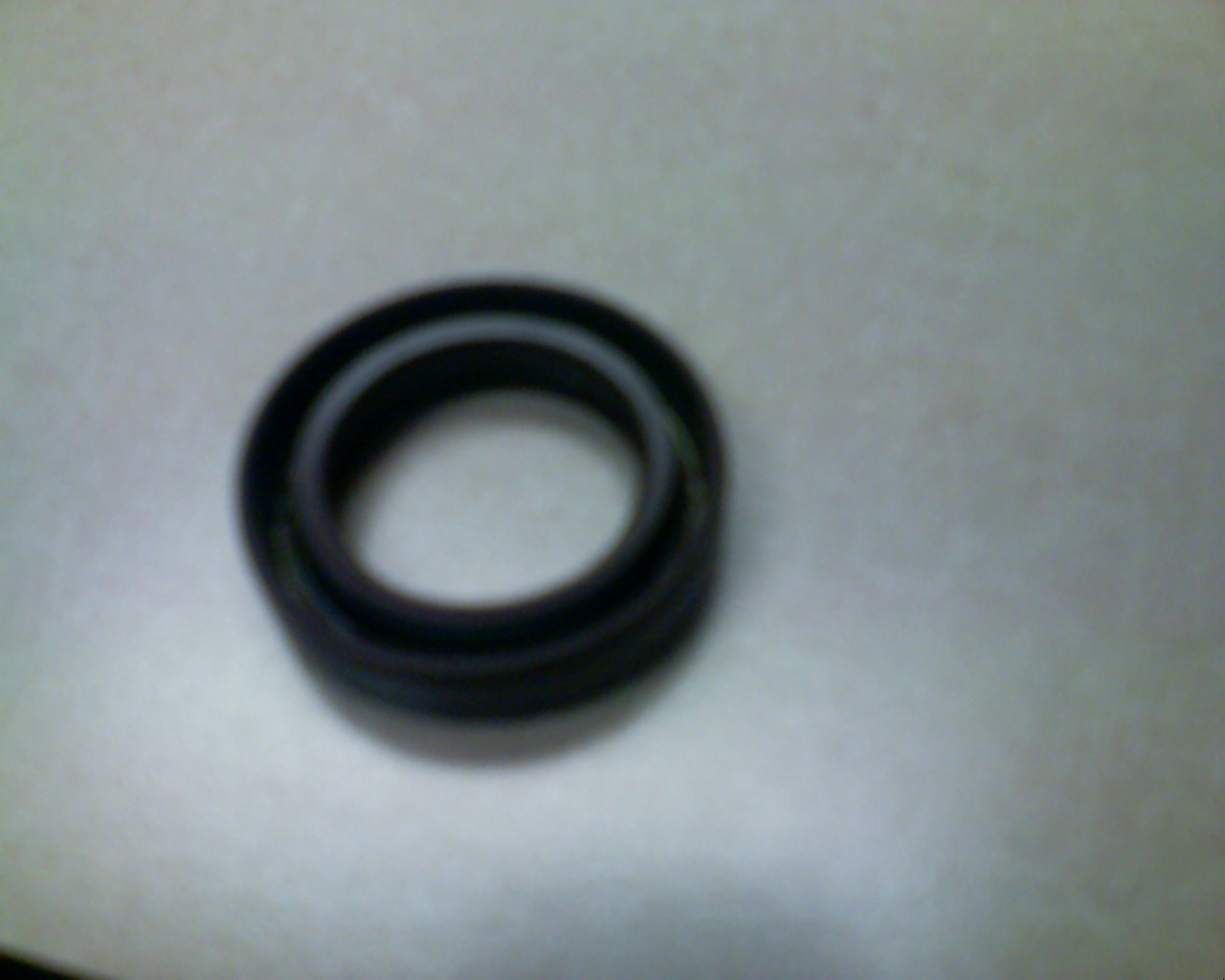

Not a great pic but here is a pic of the underside of the oil seal. You see where it's open. Under the inner lip is a little spring that goes all the way around the circumfrence. The outter lip is what is butting up against that little ledge I was talking about. When the oil seal is pushed into the front cover with a socket, it's not sticking up at all. It sits just below the aluminum surface. I'm putting it in the right way, I was just wondering about how far it was supposed to go down.
I examined the book this morning and looked at the CAD print. It does look like they are showing the open space in there. It's not much, maybe 1/16+" I want to say it's suppose to bottom out at that little raised edge that you can see in my first pics.
Thanks.

Yeah, that must be all that it goes in. Your casting must have been pretty shallow.

Thanks JET. I'll put it back in and let it bottom out at that ledge. I removed it very carefully with an angle claw tip screwdriver. It's a brand new oil seal, I just removed the seal to show you pics.
I put engine RTV around the outside of the oil seal also.
