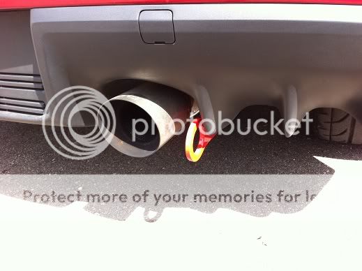

Dunno if it'll help but it looks sexy. Need to figure out the small bits and a make a temporary mount...will probably have Primo powdercoat and/or make a more attractive plate later on.
Old 05-09-2011   #11
Re: Evo X upgrades
whoah, nice!
