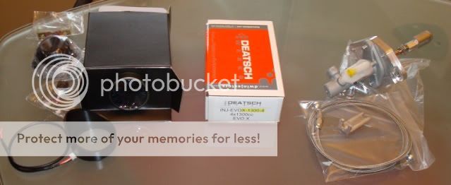

I received the Prosport fuel pressure gauge, DW1300 injectors, and Magnus master cylinder today. My goals for this weekend are to plumb in the afpr and wire in the gauge. The Magnus will permanently go on the shelf "just in case" and the injectors may be returned or resold pending my next visit to DB.
