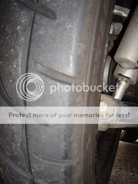

Not a great start to the day. Was driving over to Dad's to do an oil change and heard a strange sound...started looking around and discovered a nail in one of my tires. No problem, I paid the stupid 'hazard' insurance at Discount Tire and ran over there.
Turns out that Stellar had stripped out some of the aluminum caps that screw into my Rays lug nuts. I had previous noticed a couple light scratches in my rims that weren't there before but shrugged it off since I wasn't 100% how they happened. No doubt about this one.
It'll probably take an easy out to get it off...then the misery of trying to special order a JDM replacement part (often can't be done and you have to buy a complete new set). Discount has a new tire on order for me, anyway.
