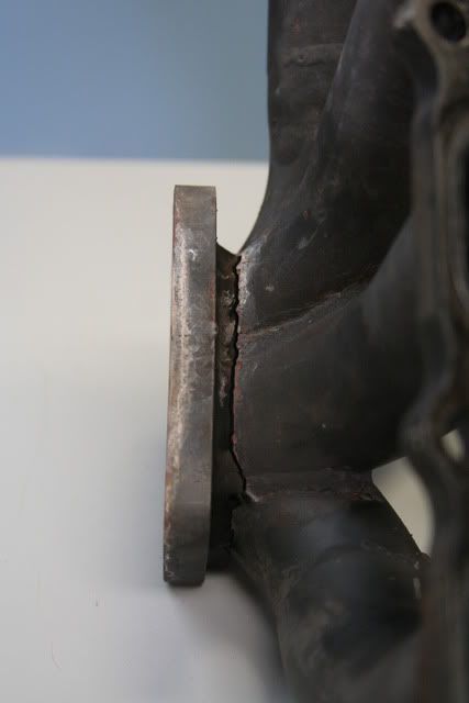

I want to replace the fucker! Unfortunately the whole system is built around it. I'm welding it now... until it breaks again

what manifold is that? Sucks it cracked. Jbweld is only for evos

Tubular manifolds were a nice idea, but never very good in practice, unless you go bawls out for a Shearer or comparable quality piece.

It's a South Florida Performance (SFP) manifold. Fortunately they are now out of business but as I understand it they used to be the shit back "in the day". My buddy Nate is welding it up now. I'm sure it will eventually crack again, I just don't want to spend $1k on redoing the exhaust setup right now...

I bet an fp race manifold and fp O2 housing would be cheaper and more durable than getting another tubular manifold if this one doesn't work out. It is a DSM flange turbo with the wg off the exhaust side of the turbo right?

SFP was fairly popular a long time ago, but I've seen several of their mani's crack so I'm not too surprised. Bummer it happened to you. Rewelding should hold it for awhile, until you can hopefully find a better, more permanent solution.

We welded it back up and got it installed later on in the afternoon on Saturday. The welds Nate put on there are the prettiest thing about that stupid manifold, lol.
Then, I apparently forgot to tighten down the turbo flange bolts and 2 fell out tearing the gasket and creating a huge exhaust leak. It turns out that the lock washers were so crushed they weren't doin' a whole lot of locking, so I put 4 new ones on. I got a new gasket, tightened it down and now it's good.
