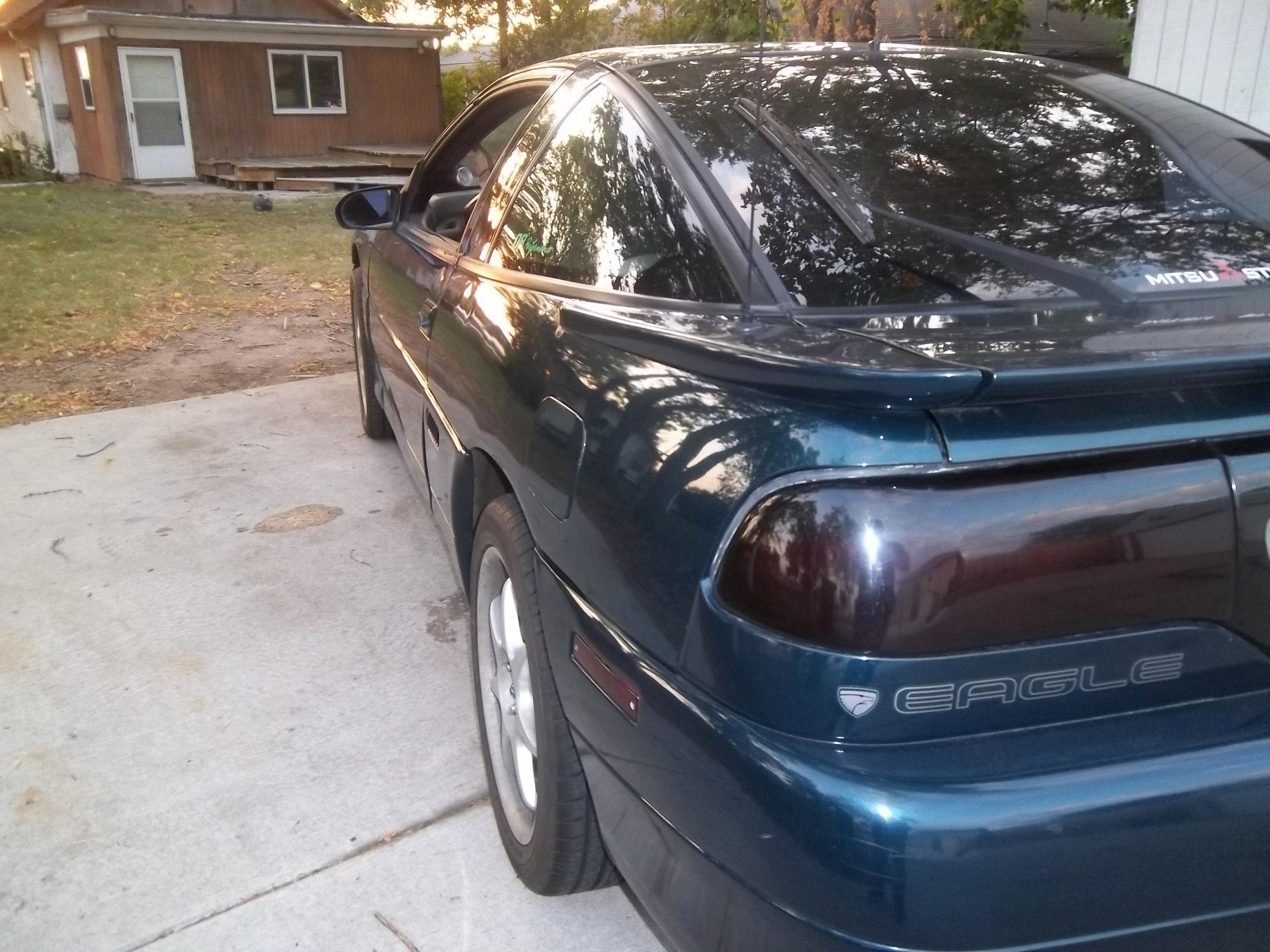

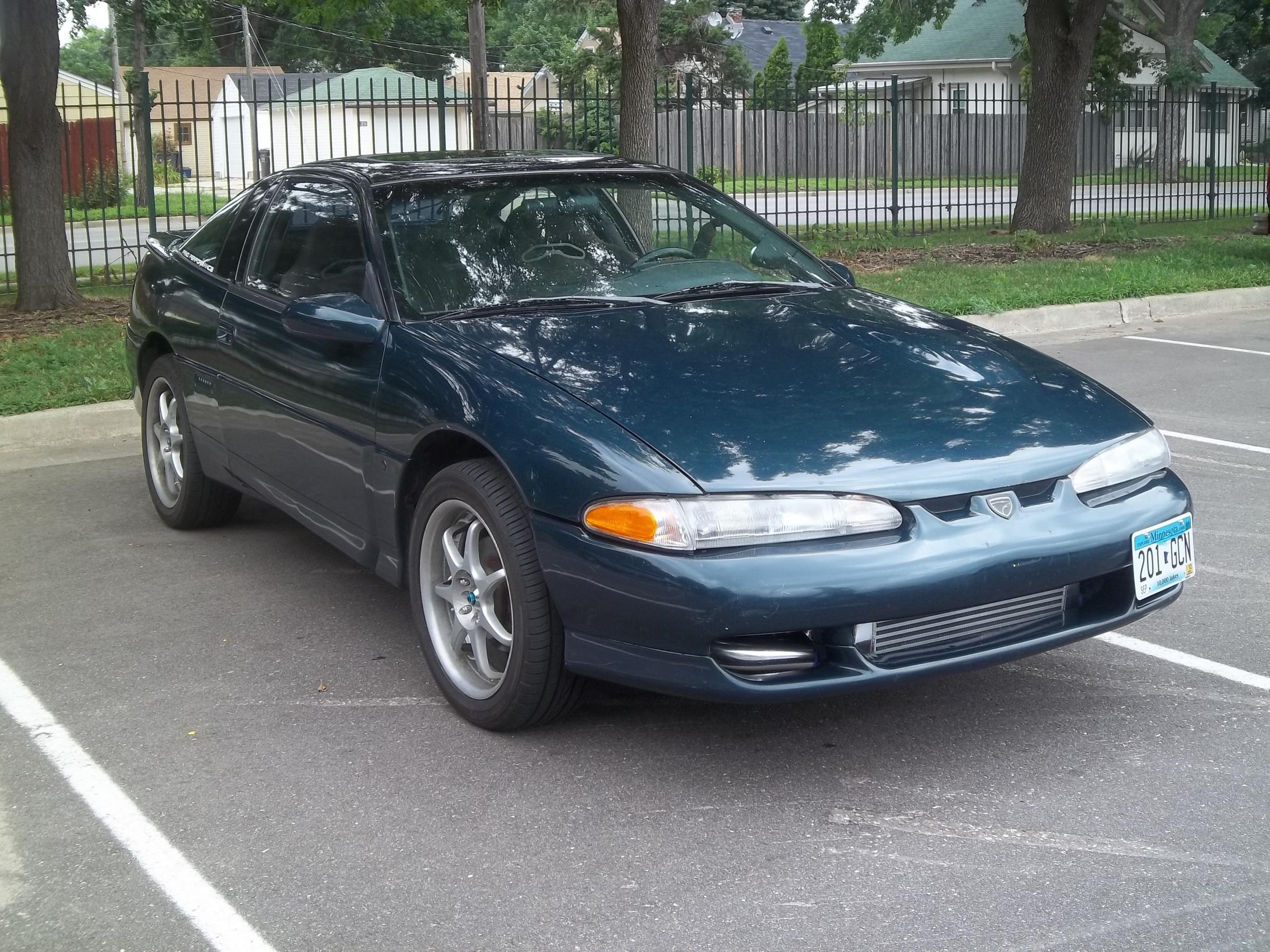

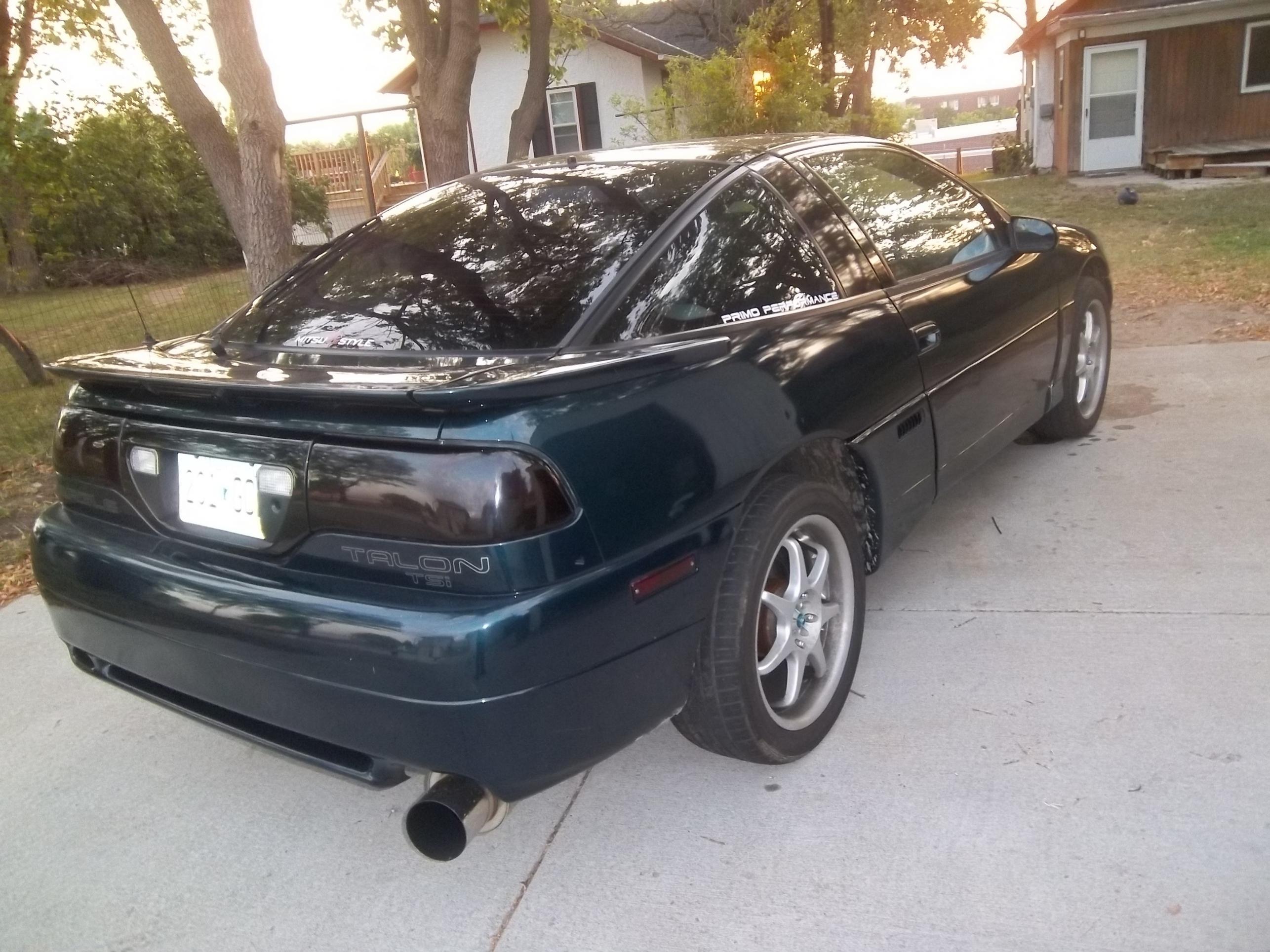

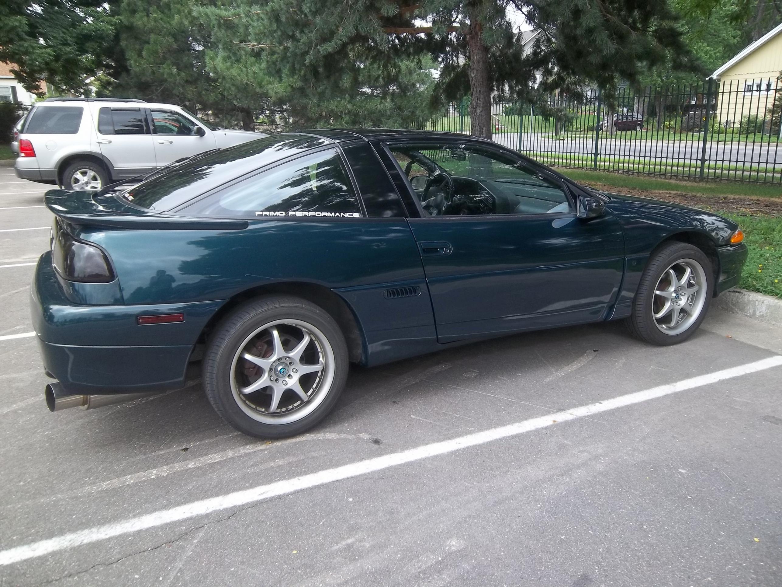

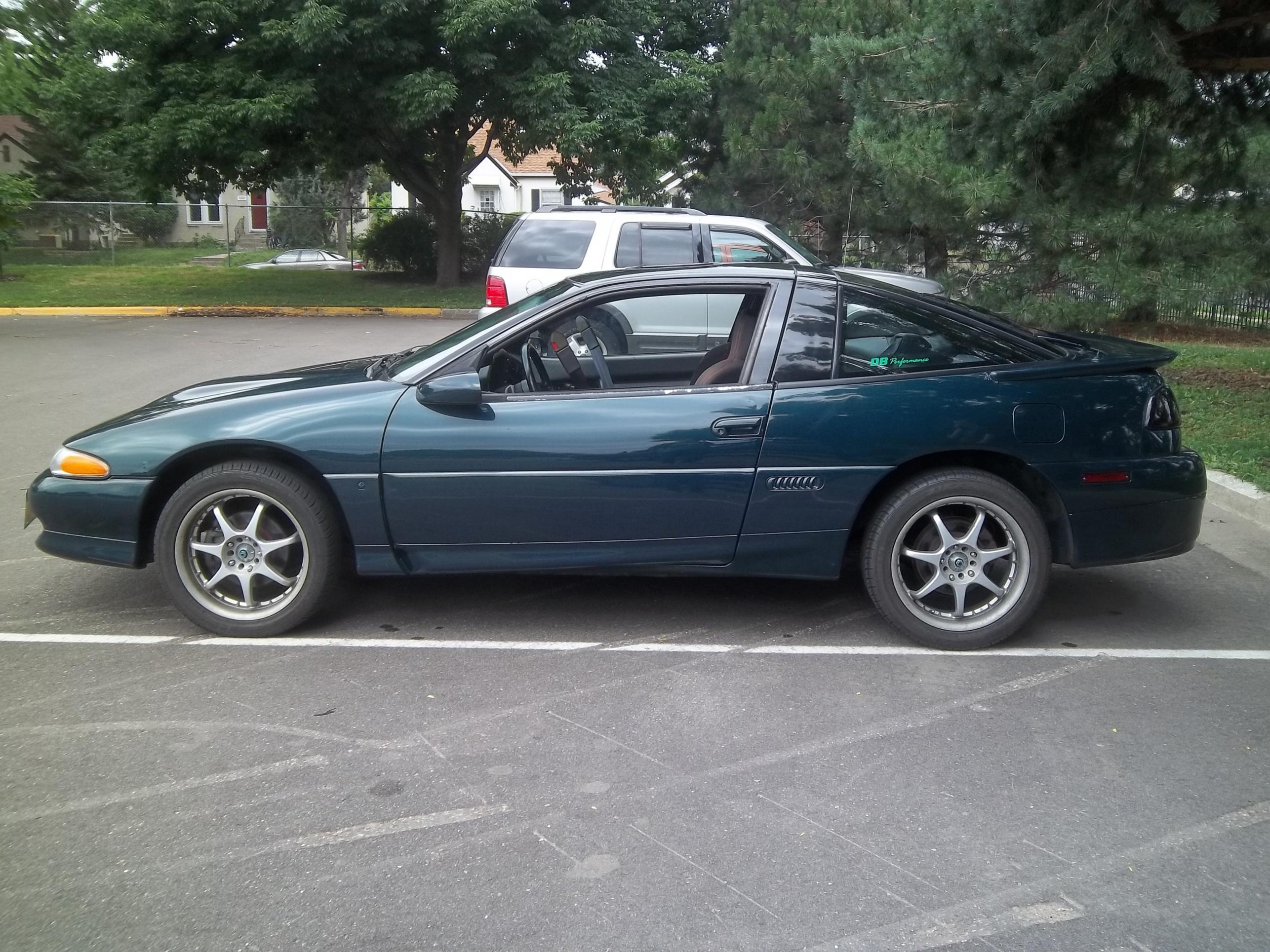

Drove down the street today for its first wash since I got it. Took some pictures afterwards, still waiting to get tuned.

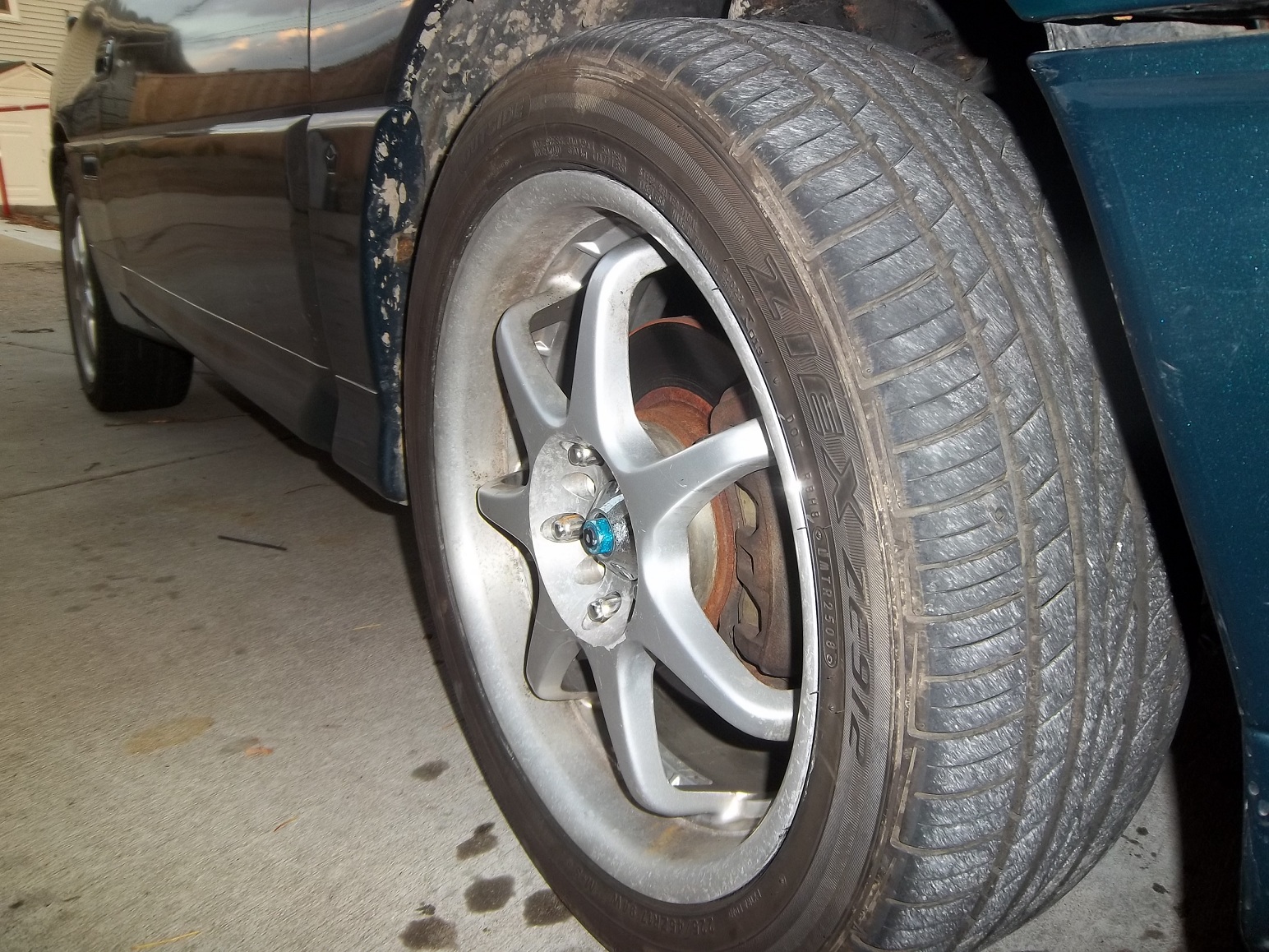

Old 07-19-2012   #89
dsmghost
dsmghost's Avatar
Join Date: Nov 2011
Location: South Minneapolis
Drives: 1gb Talon TSi AWD
Posts: 525
Re: 1g 6 bolt 4g63 tsi build

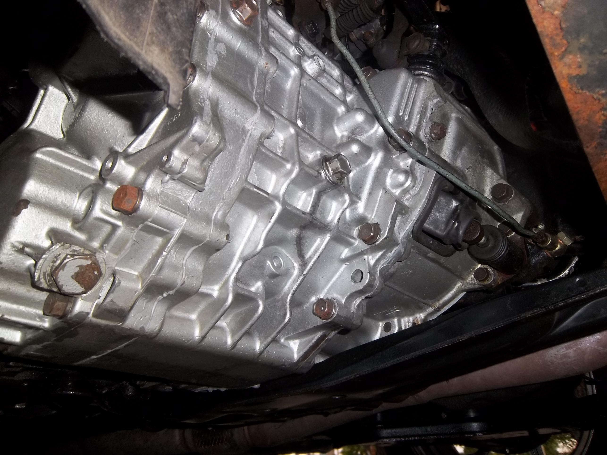

Just found this picture, it was a couple weeks ago when I put in a new LF output shaft seal and new transfer case seals.

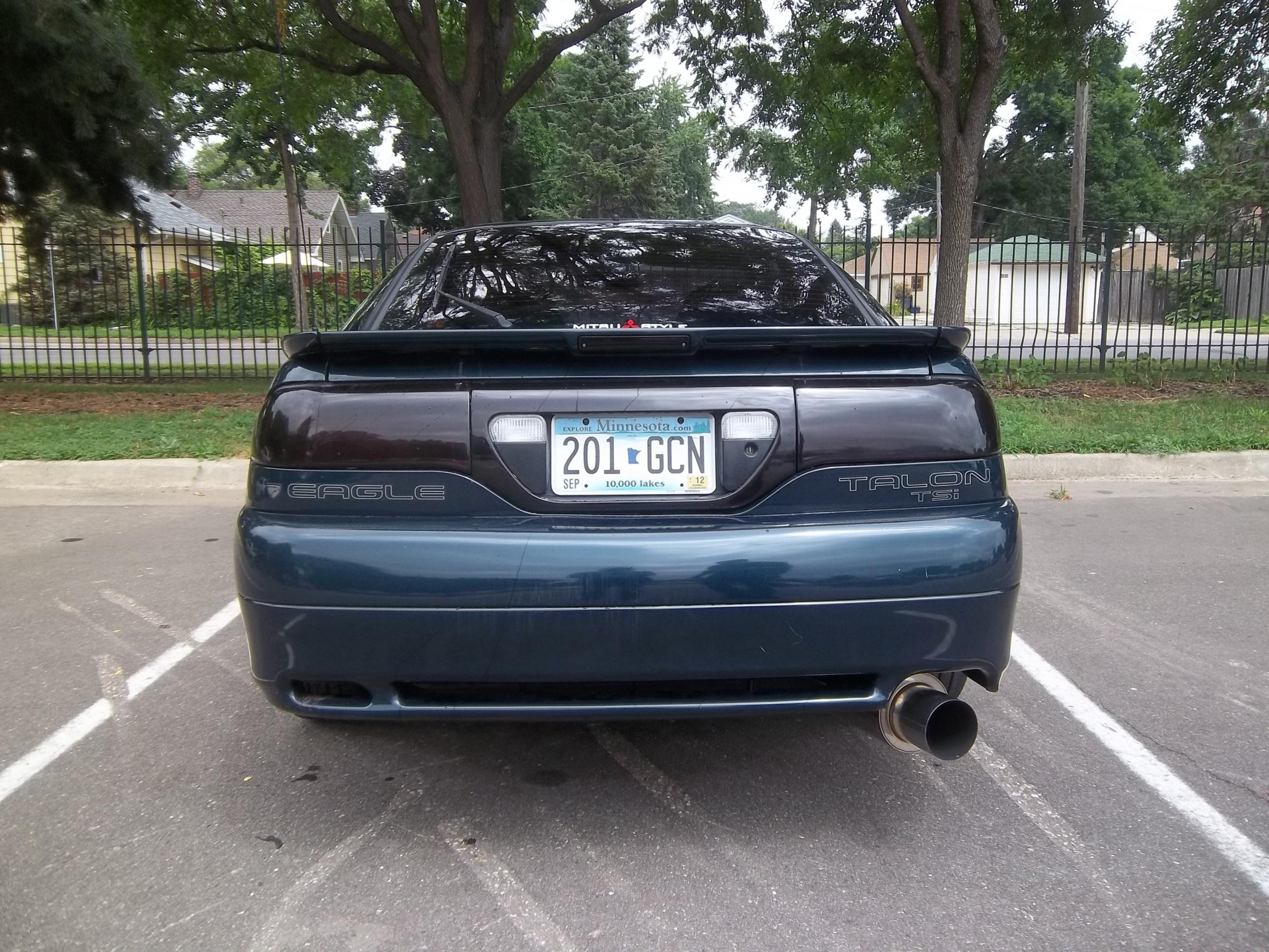

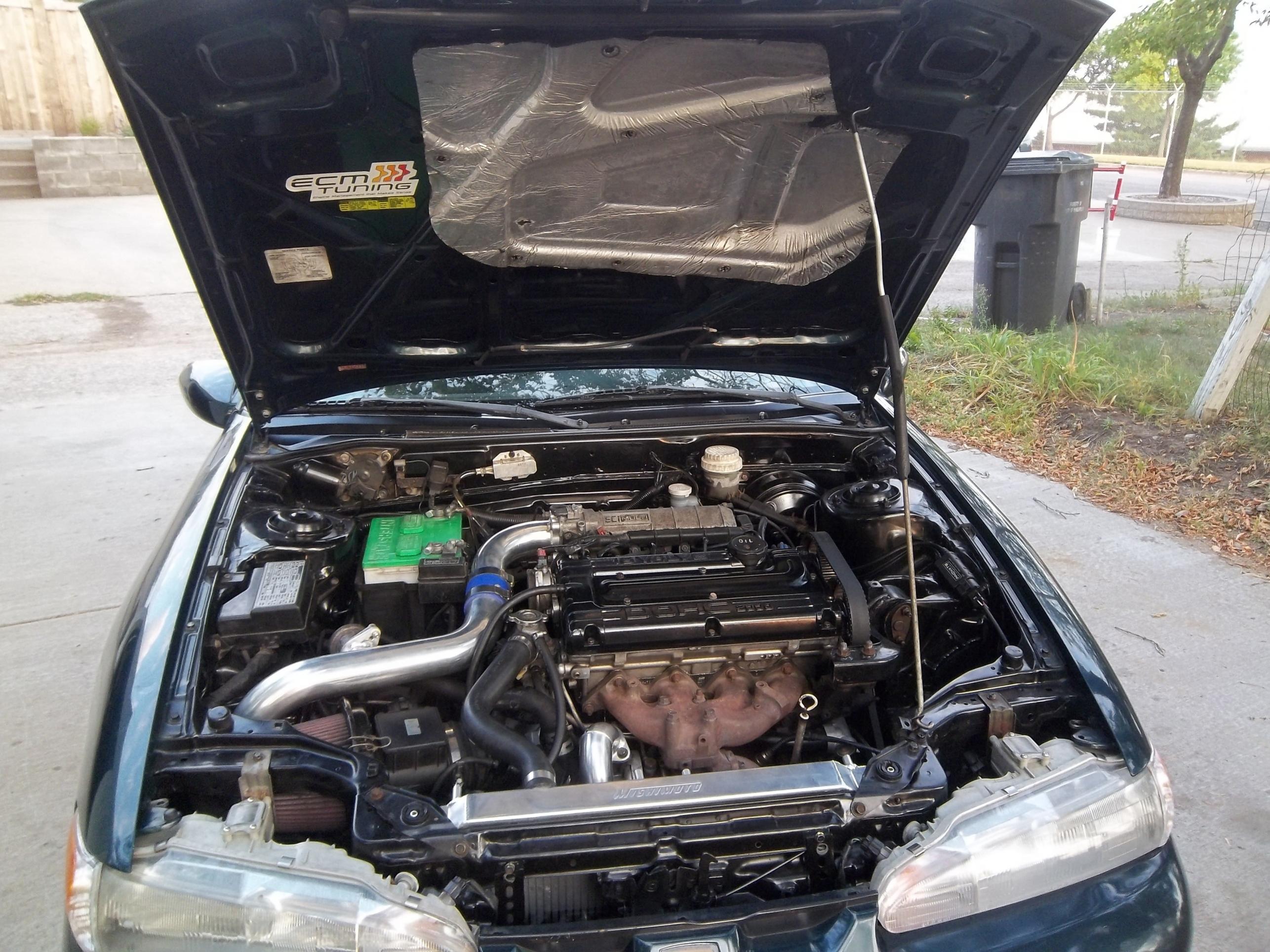

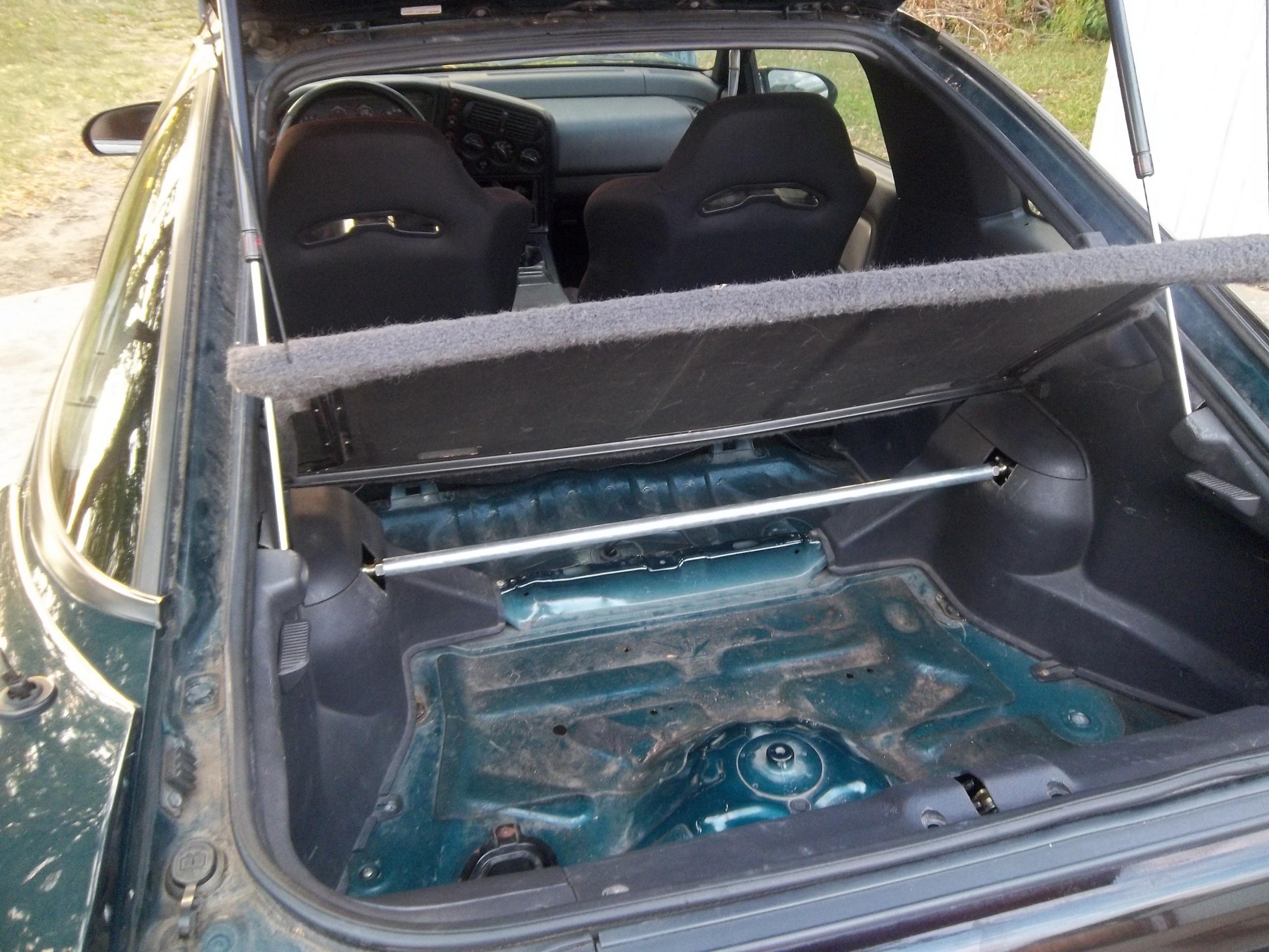

Today I installed a rear strut tower brace, cleaned the bottom side of the hood. Took some pictures. I've been driving this to work the past couple days. I've put about 500 miles on it since assembly.

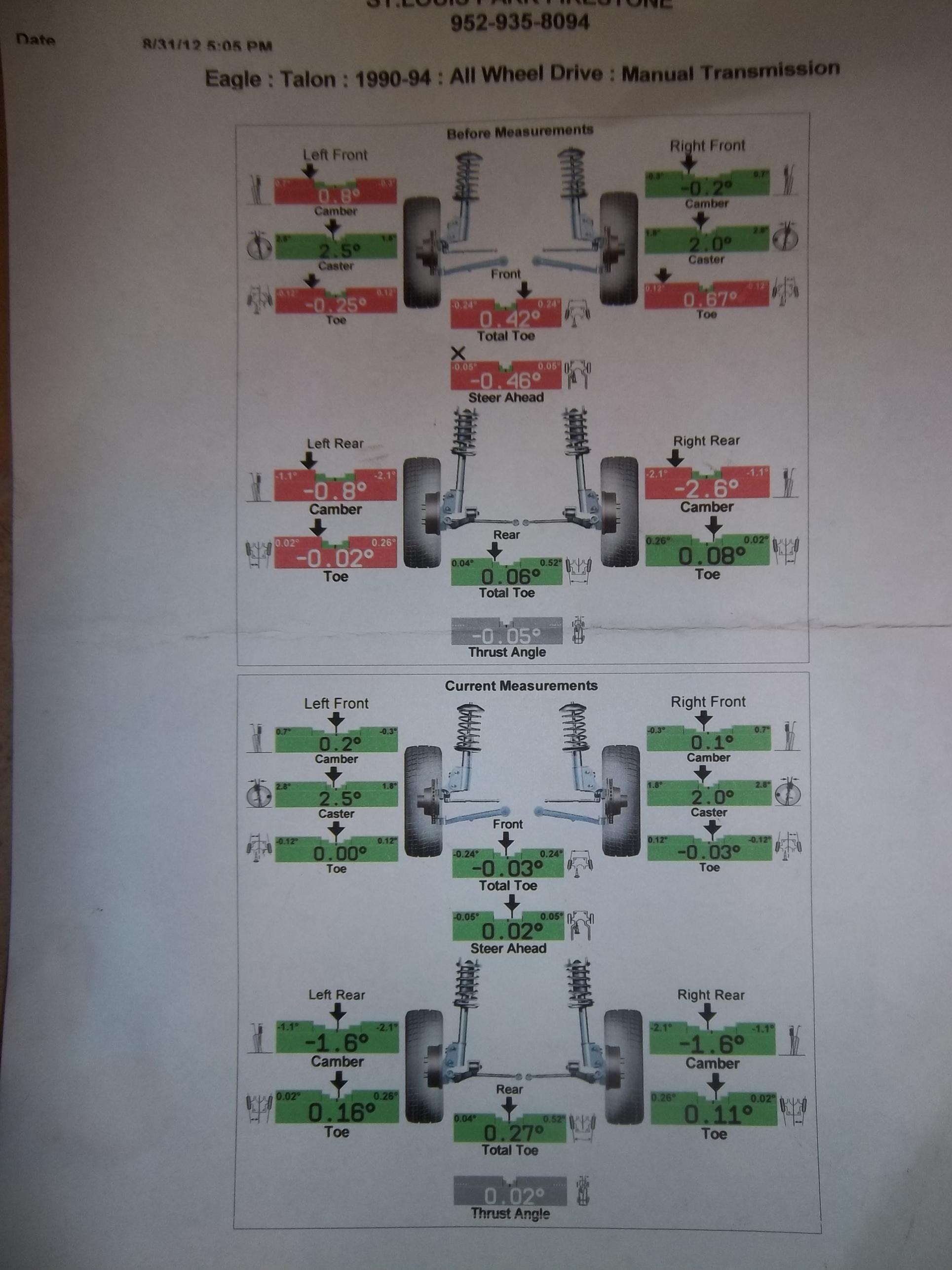

I was thinking of having them powder coated black, bronze would look nice though, didn't even think of that.
Today I aligned the talon, it was way off, I'll post a picture of the printout soon. Drives way better now. Also, found 1 of the u-joints on the driveshaft has some play. Im going to swap it with my other driveshaft sitting in the garage, it has good u-joints. I also noticed a lot of backlash in the rear diff, and a howling noise around 50mph. Im going to swap driveshafts to see if it improves otherwise I'll be looking for a replacement rear LSD.

Alignment print-off, handles great now, all the eccentric bolts turned like butter.
