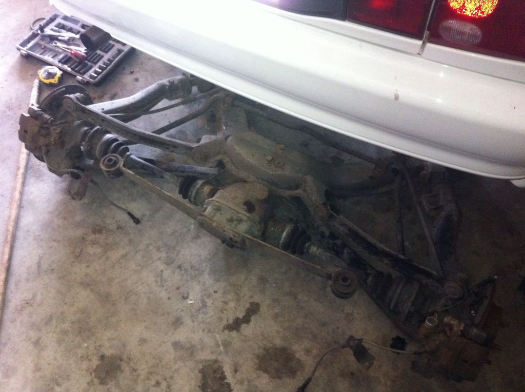

So me an 99gsxjoel did a lot today. We pulled the 6 bolt out of the 1G and dropped the rear end. Now it's tucked under the mirage waiting to get put in.
Rear end is a 4 bolt LSD w/ braided brake lines.

4 bolt LSD rear waiting patiently for installation

Just want to confirm before I do anything with the trans.
Tim Zimmer ( tmz performance) said all yrs 2g trans an t-cases wil be compatible with the 1G rear diff. Only difference being auto to manual.
So I plan on getting a t-case and trans from a buddy. It's a 98 manual trans and matching t-case. Just want someone to confirm what I read that it will indeed work with the 1G rear diff. Can use manual front parts with auto rears and vice versa.

Yea, it should. I have run 2G trans/t-case in 1Gs before.

Just gotta match t-case with trans. 95-96 trans w/92-96 case 97-99 trans w/ 97-99 case. Rears are the same.
Awesome! Thanks for confirming.
That's another step done then. Just need to send it out for refresh.
