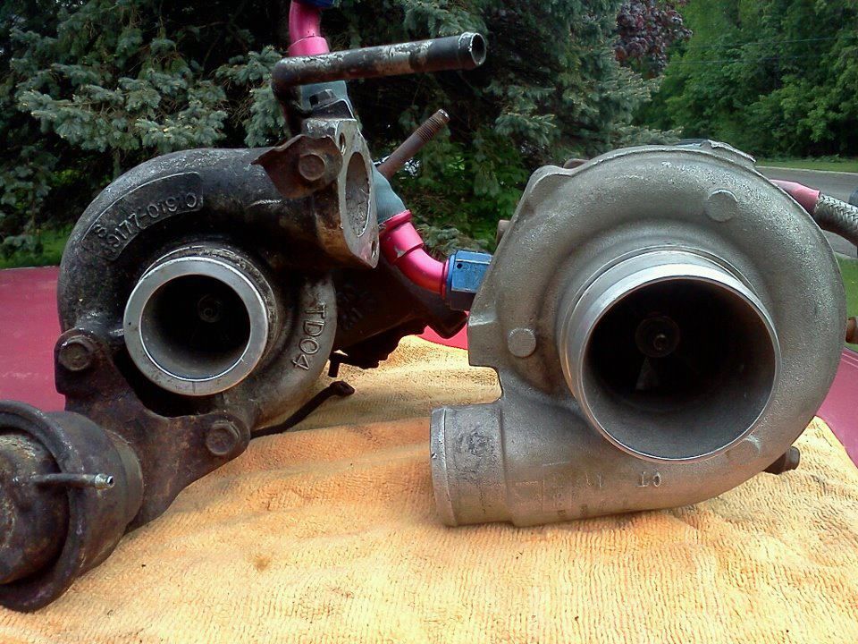

Sure has been forever since ive updated this project thread. My 1G Talon is finally running again and stronger then ever before...well actually for a few months now...ive just been working on it so much leaving, me little time to update threads or do much else for that matter.
After last years disaster i ended up picking up one Johns (Push it 2.0) Engine. Fresh rebuild new pistons rods, balanced crank, honed out just ALL OUT GOOD PLATFORM! In addition John's just one of the Coolest guys to work with BY FAR just so you know! Probably the most patient with my noob question's just awesome guy.
Here are a few pictures just because
The current mod list pretty much stays the same. Still rocking a 50 trim sold my 1200cc for some FIC BLUE Max 1450cc added a Aeromotive FPR to my fuel set up...few more SS lines here and there. Little smaller External Oil Cooler...the other one was just over kill as far as the actual oil lines went.
Tune is scheduled at DB Performance July 12th after over a Month of waiting finally get to go on the rollers. So as far as preperation's will go for the event just a fresh oil change spare spark plugs...im thinking of installing some camms but im not sure about that since my heads not really buildt. I miss placed my 280's and thought they got tossed but ended up finding them so i figure why NOT?....Boost leak test day before and i guess just make sure i prepare as much as possible before hand ....any advice is appreciated from you guys...and yeah hope itll make a lil over 100 WHP

Has the valve springs and retainers been updated? If not I would not install the 280 cams. The db website also has some things to check on before getting tune. Good luck on the tune.

i posted earlier, but what turbo?

Turbo talon its just a tdo4b bulls eye 50 trim ball bearing turbo...I really like its spooling characteristics. Very responsive...goal is 28psi max ill need to see if it can spool and hold that psi through out the rpm range I want...24-26psi might be smarter....pretty much as much boost as I can handle without catastrophe
