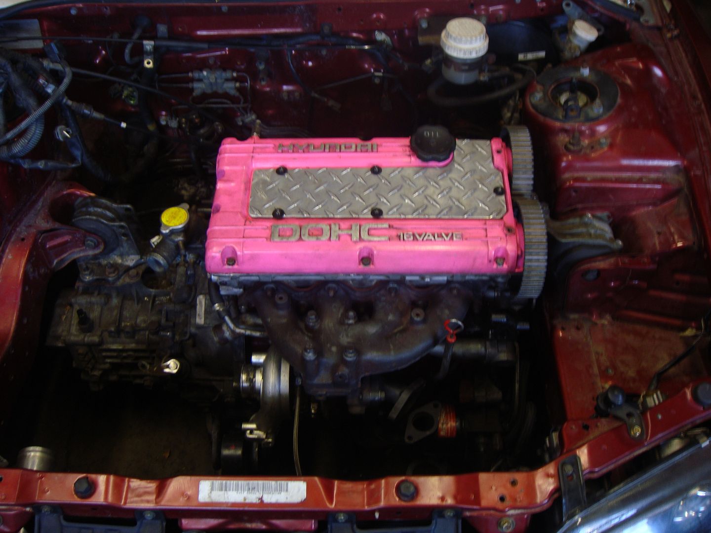

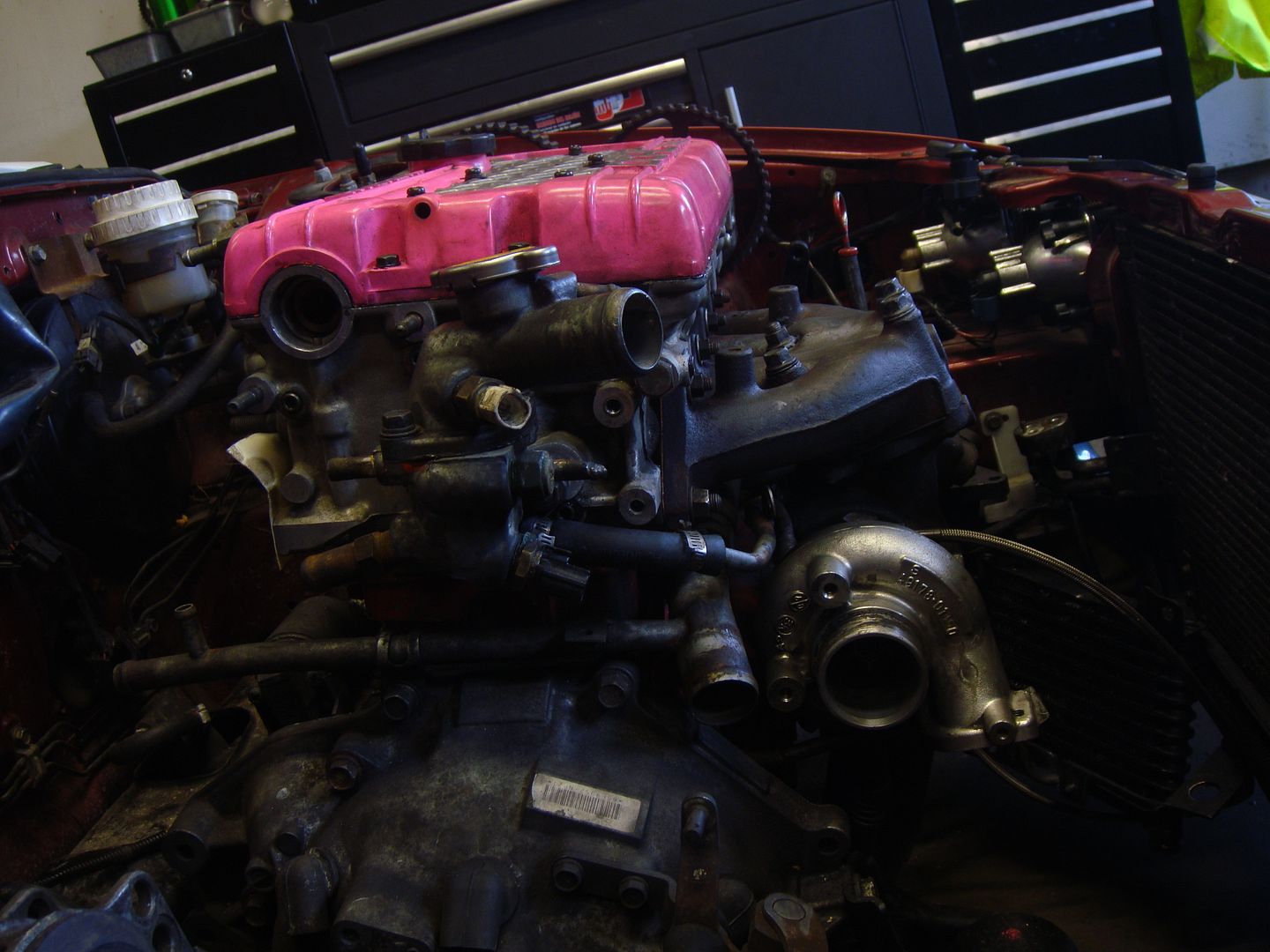

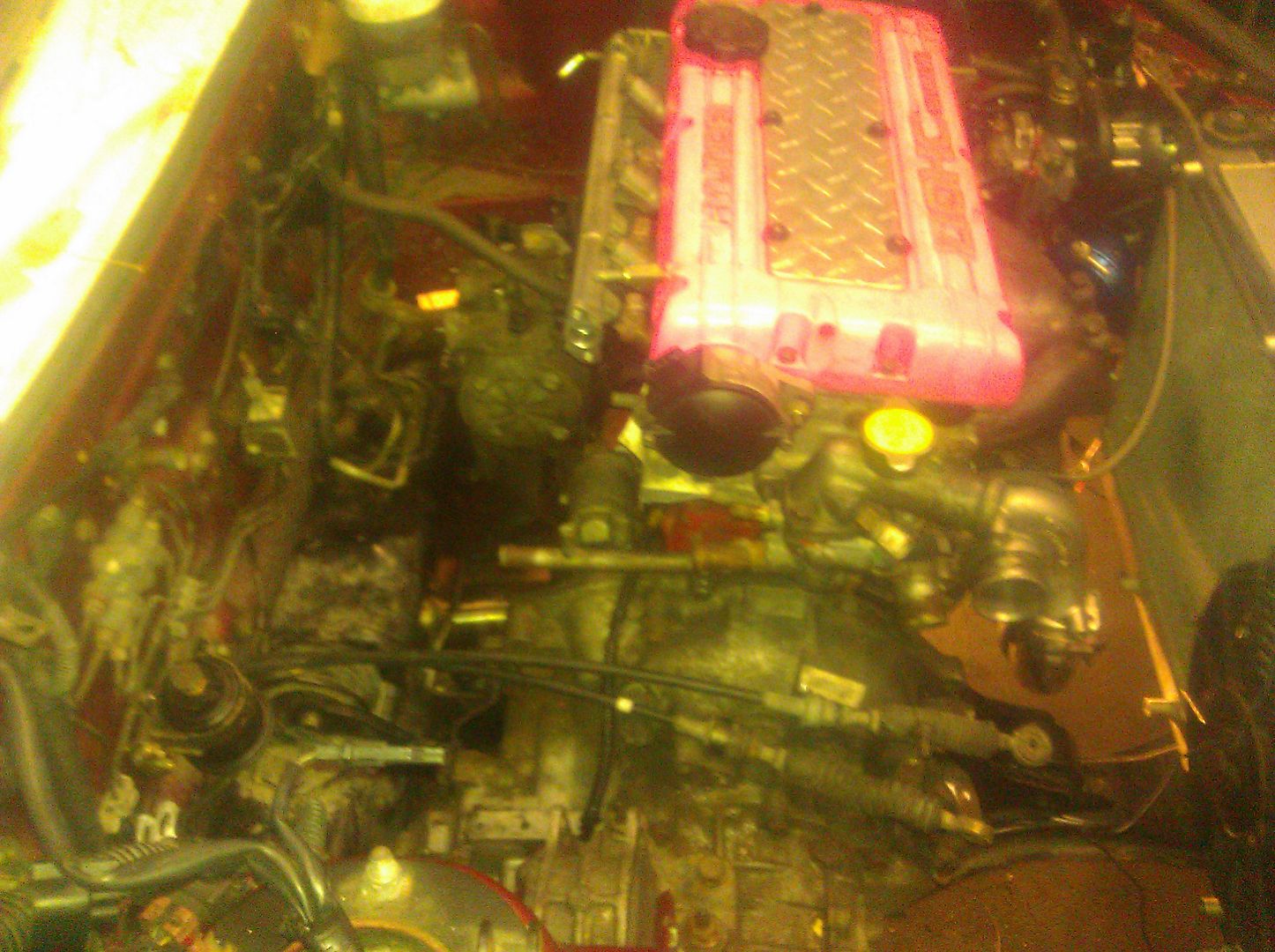

after 10 years its coming back to life
What's going in it
Engine ect
95 pistons on 1g rods
Arp head,main,rod studs and bolts
Rebuilt 1g head light port job
Bc springs
Fp2 cams
Evo 3 turbo off my evo 3
Evo 3 manifold
Tial 38 gate and o2 housing
Bolt on BR afpr
Evo 8 injetors for now
Wally 255
Act fly
Act 2600 or 2900 have both
Sbr fmic off brad's old 2g

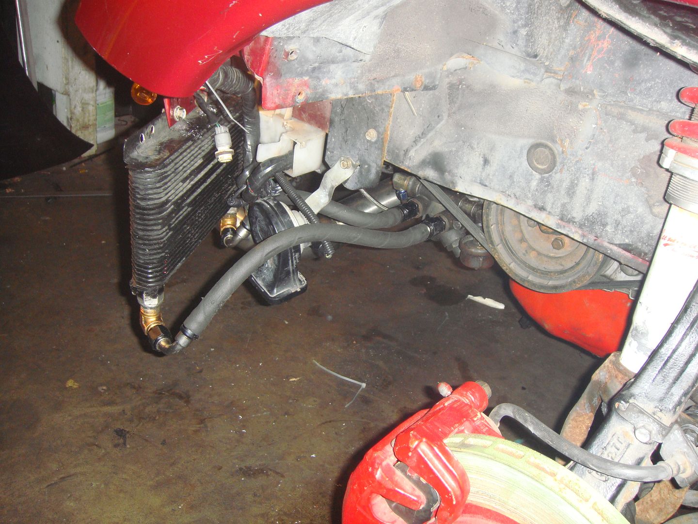

B&m oil cooler with push lock line
1g fluidine raditor that was in my 1g and the evo1 swap
Out and in

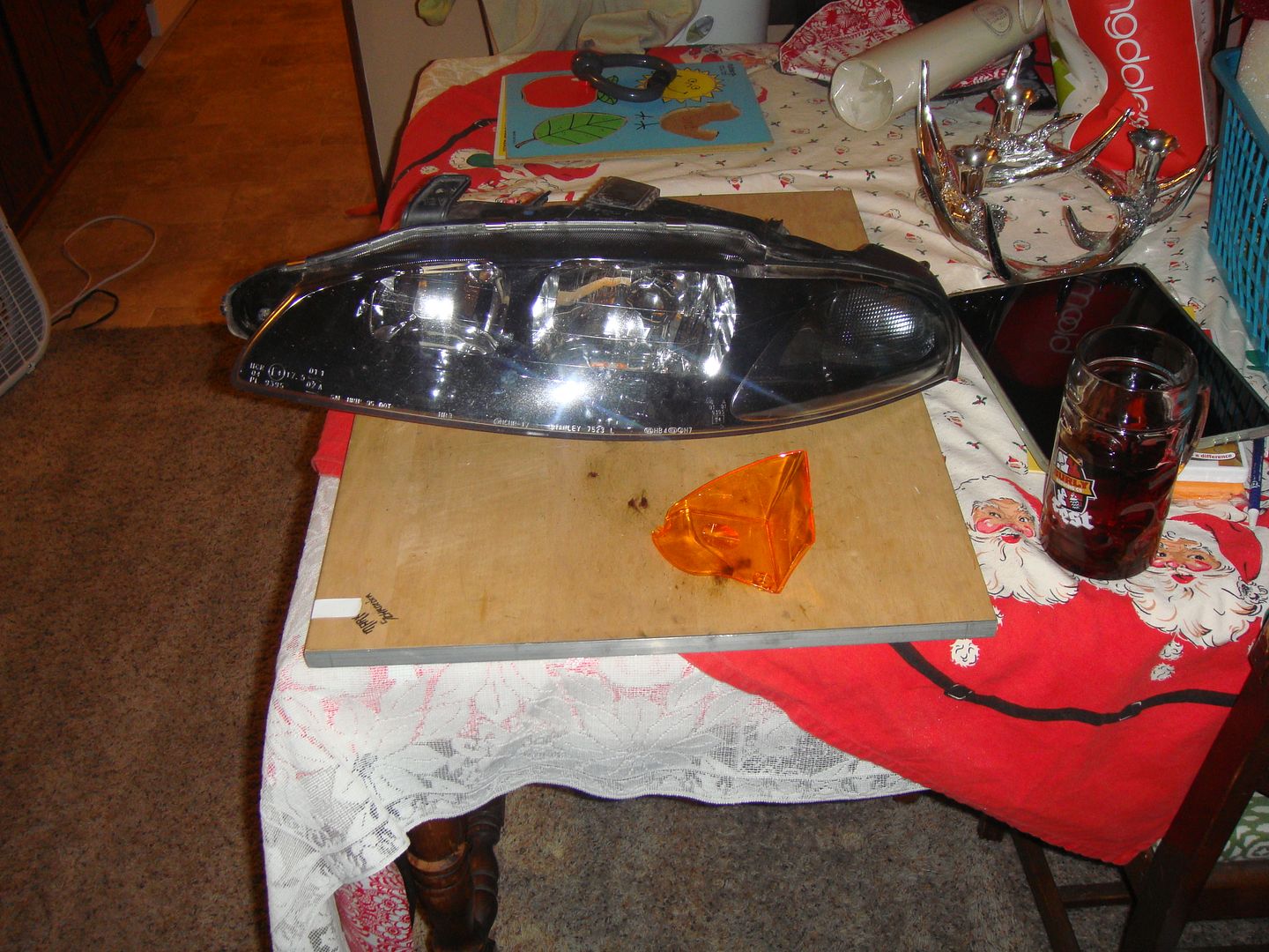

2gb talon front bumper will get modded to work with 97+ eclipse head lights
2ga talon rear bumper and tails
2ga talon side skirts and door caps
Evo 3 front recaro
That is about it for right now. Trying to sell parts from the 2 parts cars to get the rest I need to get it going

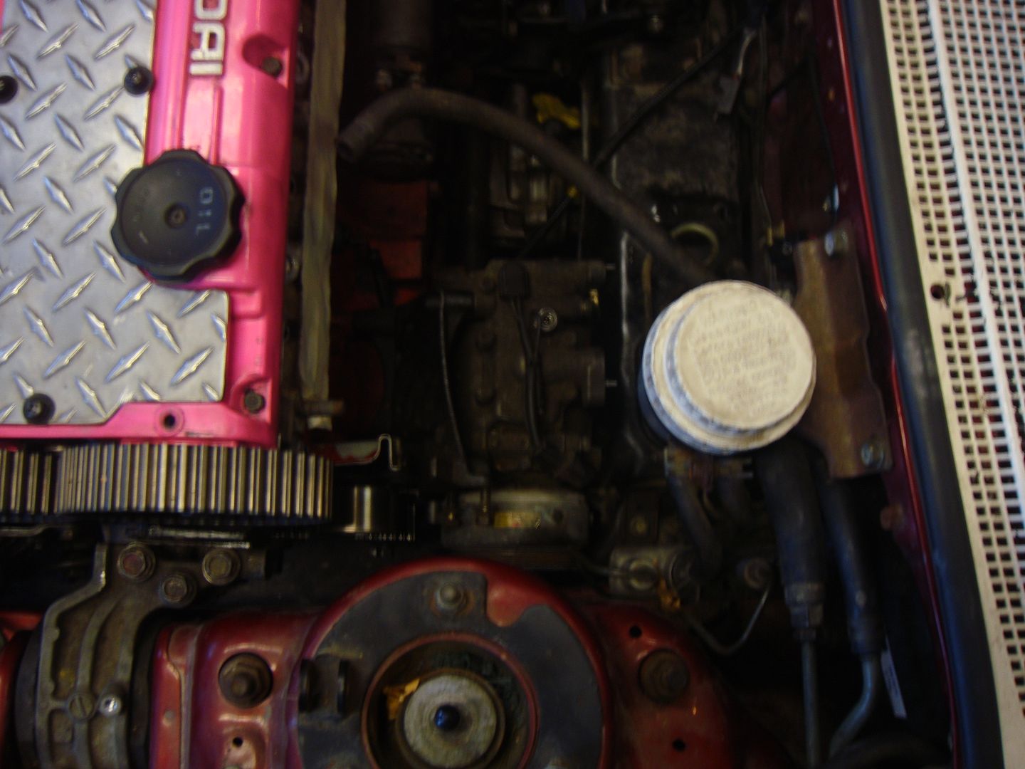

the really old pics of the car
back in 99/00 when colored wire loom was in. also had a wings west front bumper and blitz sides and rear bumper on it then
Then frenched in a 3g eclipse alum gas door on the car
also found the rare edm tails,edm mirrors for the car (have sold them now )
this is how it sat for almost 10 years now all apart no engine in it and every thing stripped out and parts where sold from it
