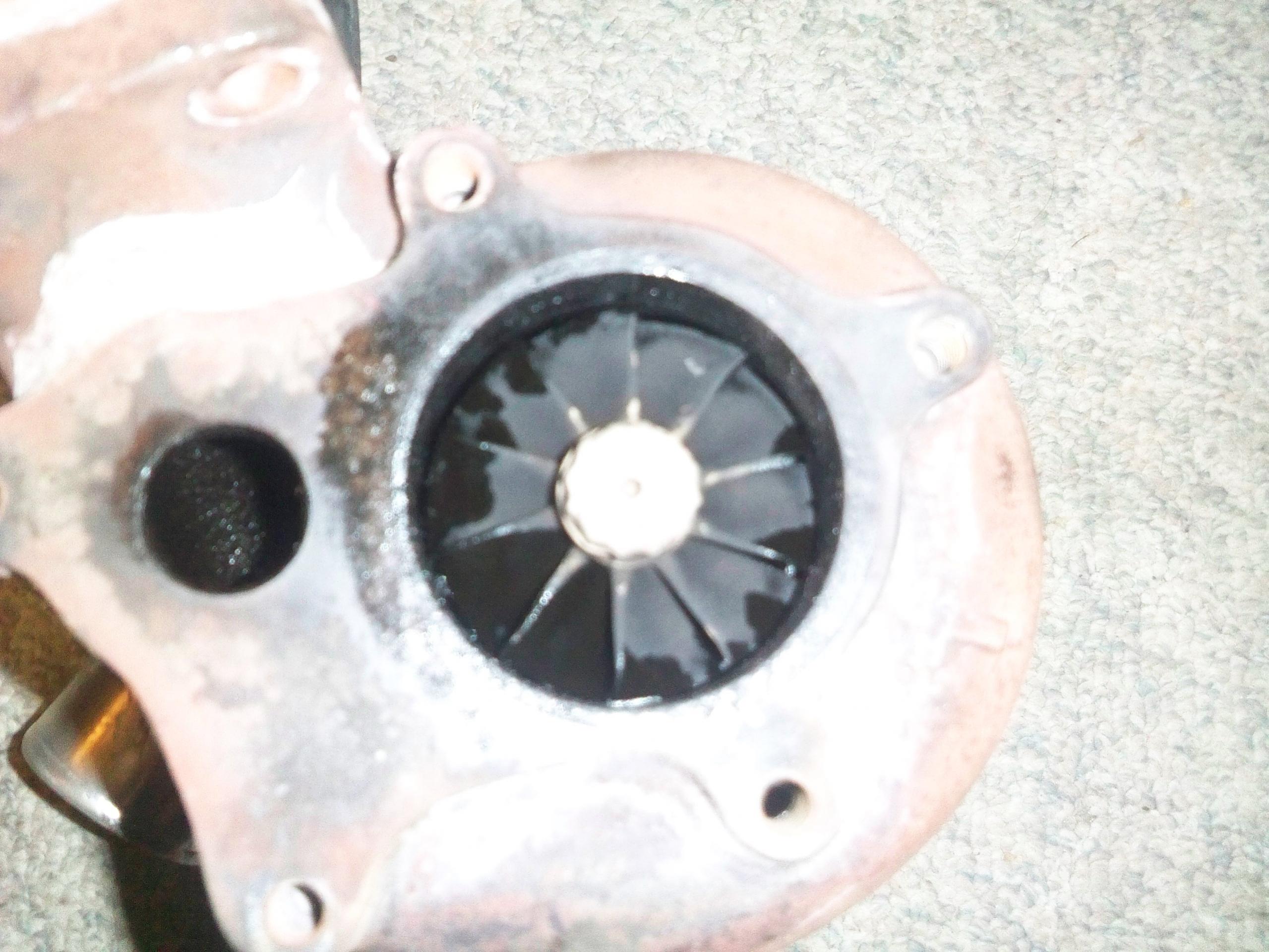

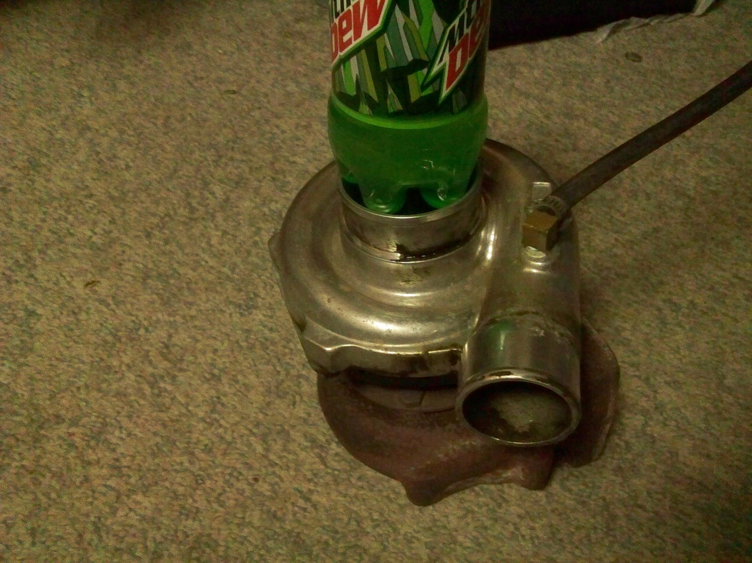

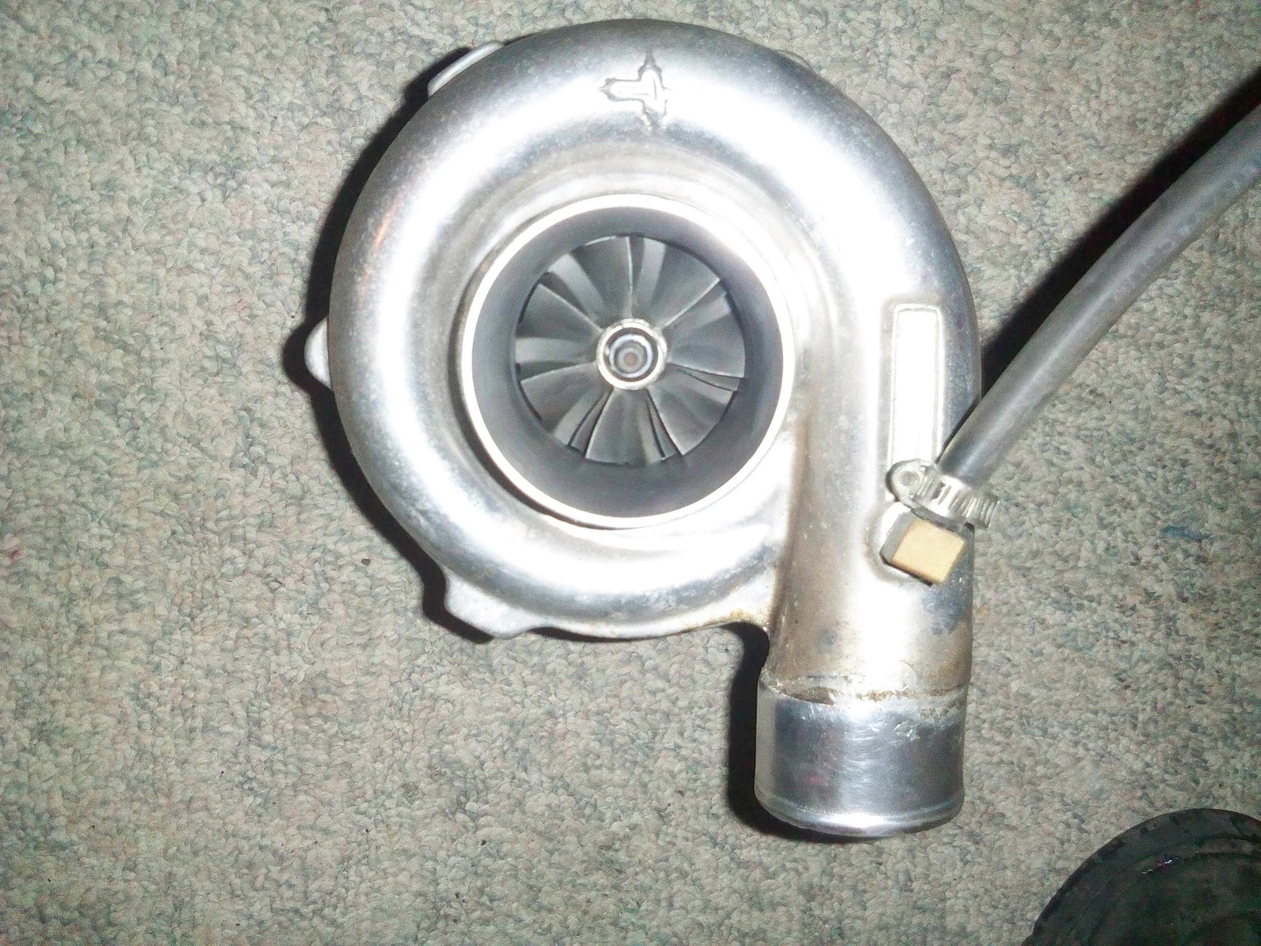

Originally Posted by way2fastlaser View Post
here are the pictures of the turbo i got
Attachment 9644
Attachment 9645
Attachment 9646
Attachment 9647
That turbo looks like it has blown seals. Exhaust wheel is wet...but if you need a t3 turbo manifold, I have one. Ramhorn style made by Punishment Racing.
