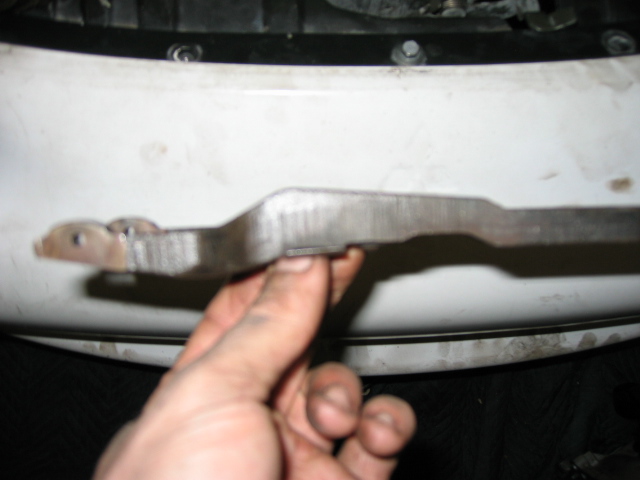

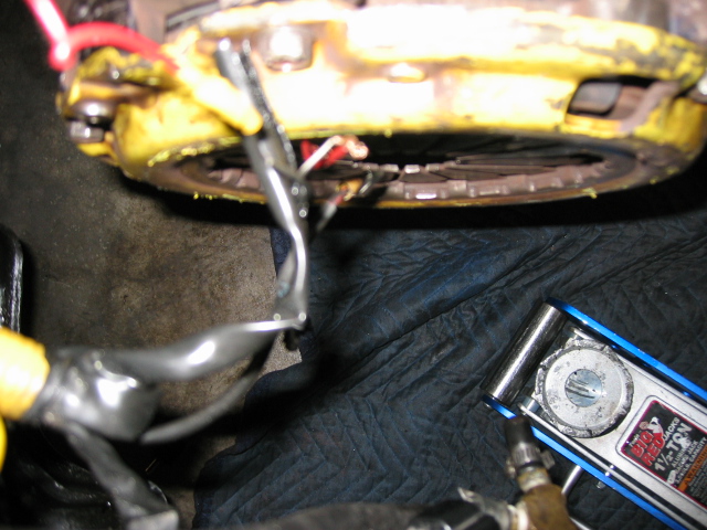

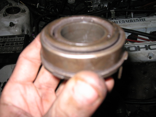

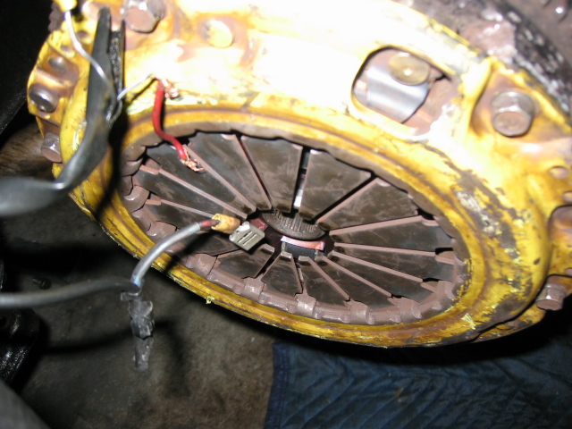

Amazing how i can now take a tranny completly out in less then 2 hours
Heres a couple pics, tell me what you guys think. I was talking to the guy that i bought the car from and he said the PP was pretty much brand spankin new, like less then 15000 miles on it.

That pressure plate doesnt look new. It looks like some thing was hitting againt it. its hard to tell from the pics but it looks like something was hitting the flywheel too. I agree with M/// guy replace it all and be done with it.

That pressure plate is sure beat to hell. The one I just took off my car supposedly only had a few thousand miles on it (maybe 10,000+ as far as I know) and aside from the dust it was shiny. Yours looks like it was tossed around the garage a few hours before hand.

From the looks of the pictures it looks like the PP fingers are flat. They should be bent out away from the clutch disk.

It was the throw out bearing. we got it all together tonight, i was able to put it in gear and press the break without it killing and no noise. but then all of the sudden it started vibrating really badly, so i pulled it in. looked under the car at the flywheel and was gonna have my buddy start it, but then when he got in the car i watched the flywheel move a little, instantly i realised that i didnt double check the bolts after putting the mounts in, so tomorrow im gonna retighten the bolts and that should fix the problem.

sweet. good to hear. Your fork looks fine by the way.

I agree with the others above. The PP does look like it has seen better days. By the way, the fingers of the PP flatten out as it's tightened to the flywheel. When it's off is generally the only time you'll see them at the angle.
