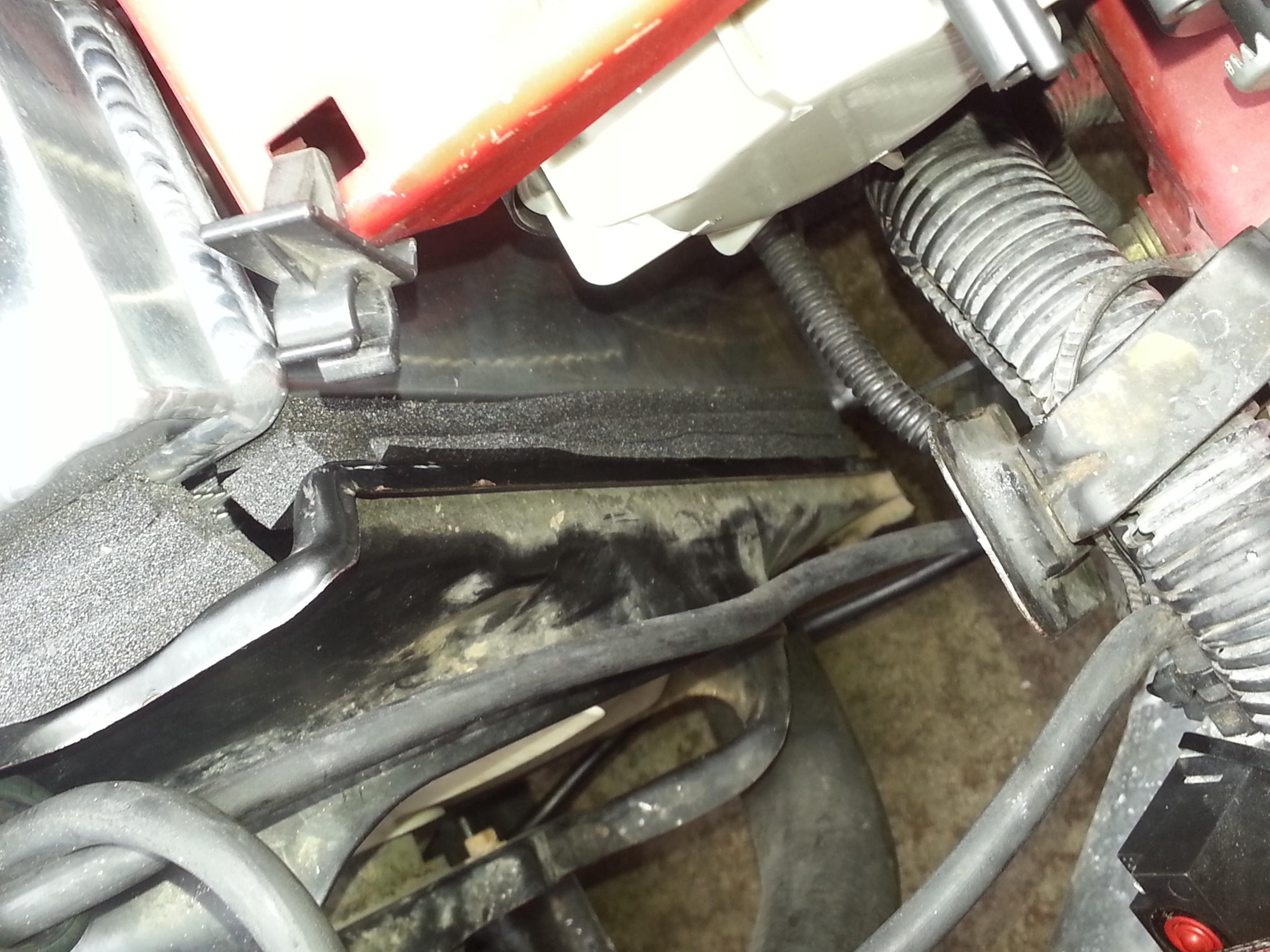

I replaced the thermostat with an Advanced Auto 180 one. Was my first step into trying to fix the coolant temps.

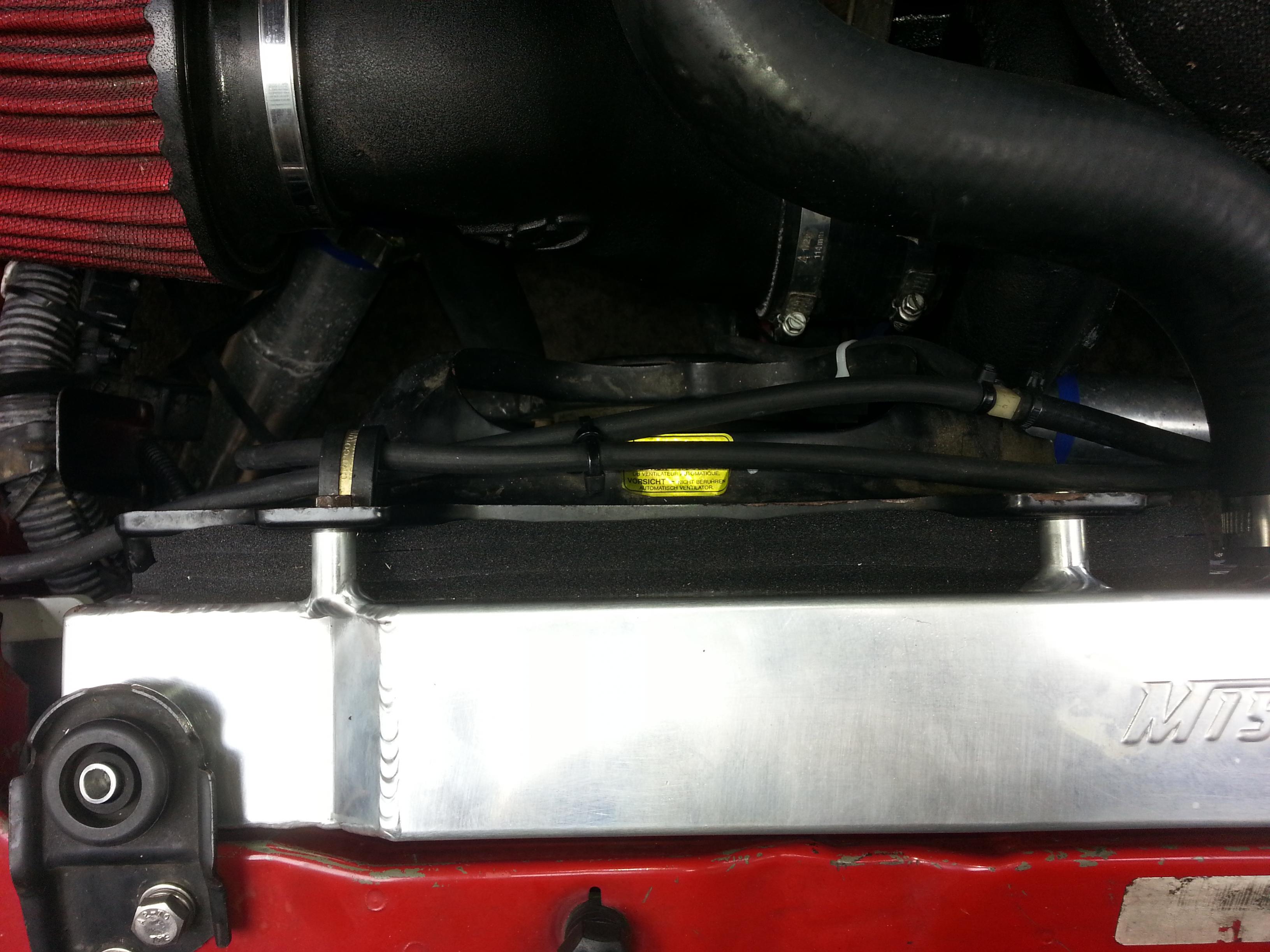

The pictures show the large gap between the radiator and stock fan shroud. Tomorrow i'm going to take a picture of the stock radiator with my spare stock fan and if I can find a tape measure laying around i'll measure the difference between stock rad /stock fan, and mishimoto/stock fan.

Foam tape works very well for filling the gaps between the fan shroud and radiator. Sounds like you have a good cooling setup now. I ran a 180* in my 1G and had no issues with it over-heating; if this doesn't fix your problem then there are likely other issues to dig in to as well. You could try ceramic coatings on the exhaust manifold and turbine housing, a turbo blanket on the turbine housing, and most simply, running as many of the stock heatshields as possible (appears you already have one on the ex mani which is great).

So I realize its only my first day driving the car to work. But so far today it was raining heavily outside temp is 81. And the coolant temps stayed pretty much at 200. Saw a few 203's
But I think the much larger gap in the radiator to fan needs to be addressed.
Any suggestions or idea's?
Try this:
Some how i completely missed this post when I posted early asking for advice....

Still researching tape.
Started with my local race store and came up with this.... even says many automotive applications right on the packaging lol. Is this the correct stuff?
http://www.lowes.com/ProductDisplay?...llow&cId=PDIO1
Several threads I read said it needs to be high density, waterproof, and closed cell.

That should be fine.

That'd work. All you need is to fill that void with something. Also if there's any gaps between say the AC condensor and radiator, you can try sealing that as well. The ideal setup will basically force all air that comes through the front all the way through the raidator. Any paths that the air can escape before it reaches the radiator, try and close them off. That's perfect world, real world just do the best you can.
Old 07-22-2014   #33
Agreed, you definitely want to use the foam tape to also fill any gaps between the A/C condenser and the radiator!

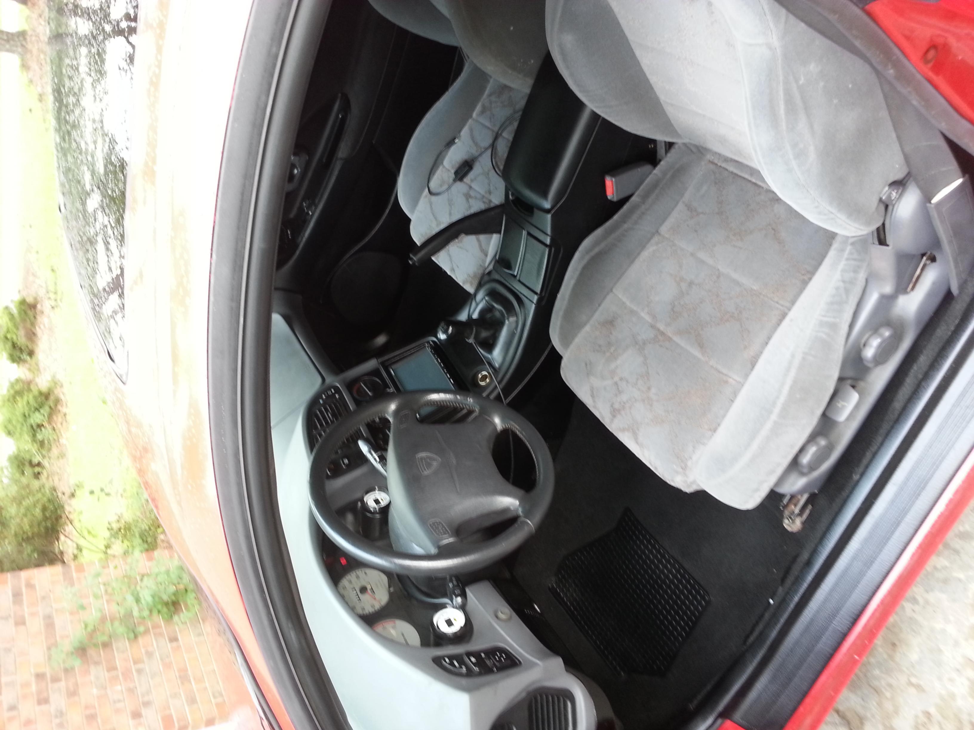

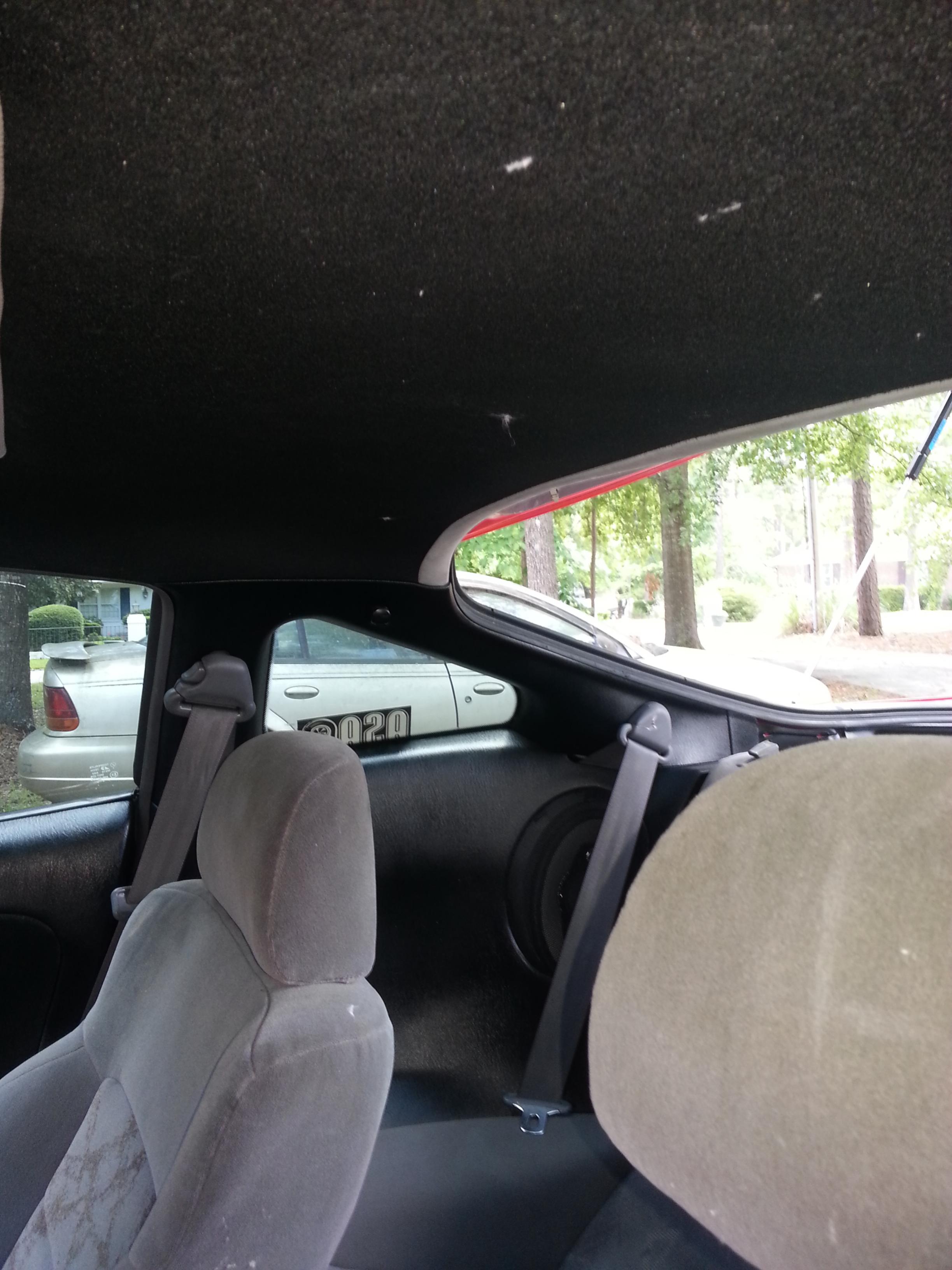

We had a bearing go out on our calendar at work and we wont have a new one till monday so been off since Wed night. And figured I'd get some work done on the car.
And what started out as a minor cleaning turned into one O.C.D. moment after another I got started and just couldn't stop.
I started off by vacuuming the car trying to get all the cotton fibers from work out of everything, then wasn't happy with the dirt/stains, so I borrowed my father in laws power washer and washed the carpet, the plastics. Didn't get clean enough for me so I figured well I'll just die the carpet. But figured hey I plan to go full black so i'll just die it black now. I followed the tutorials on tuners, end well it got out of hand. And I also found some rust on the rear hatch when i pulled the plastics off so i'll address that when taxes come in.
I was also happy to find a full Kenwood Audio set up in the car, and I found a wire which I thought was my antenna wire hanging down so I did some research to figure out where it went on my stereo and to my excitement turns out not only is my stereo a touch screen but it also plays DVD's. So took my son for a ride when I was all done putting the car back together and installing the foam for the radiator/fan.
And we watched the movie "cars" on our way to Mcdonald's for icecream. My son was so excited lol.

I also should have taken before pictures of the roofliner and trunk carpet, both where stained pretty bad from greasy hands.
