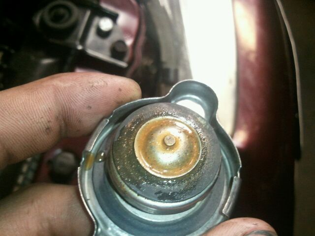

Almost forgot to mention I have a weird rusty color in my coolant. Could It be copper spray from my headgasket?

When was the last time the coolant was flushed? You should also do a block test. Easy way to tell if you have exhaust gas in the coolant.

I just ran straight hose water through it not to long ago. I'll post another pic of the pan I put the coolant into. There is settlement on the bottom.

I doubt a little copper spray would be visually noticable in the 3+ gallons of coolant in your system

The rust color may come from some breakdown inside of the radiator. I would just monitor the coolant color as you continue to drive it.

cool. I'll keep flushing it out.
