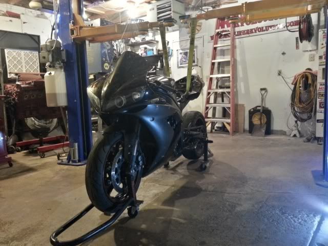

Installed my lowering links last night, install was a lot easier than I though. I ended up using a car lift to raise/lower the tail which made it super easy. An engine hoist would've worked too but that was outside in the cold/snow haha. Lowering links weren't too extreme, just an inch and half or so.
Was going raise my forks in the tripple tree too but my stock steering dampner wouldn't work anymore. Might just try riding it around how it is for a while and see how it feels for daily riding. For the track it'll be strapped hard anyways so I think I'll be set at the track.

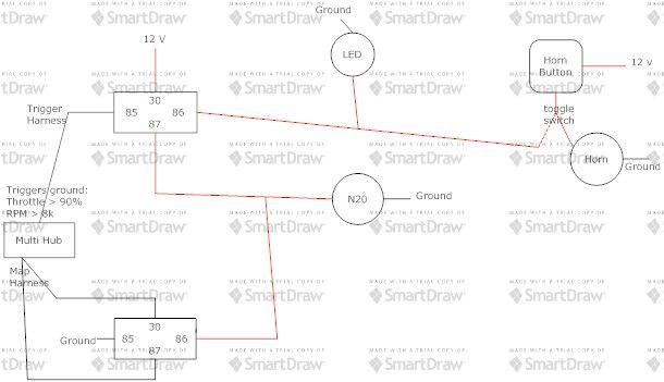

^This is also my plan on how to wire up the nitrous so I have it all in one place. Really want to wire in the LED so I know that I'm spraying and the map switched but might be further down the road as I really just want to go to the track.

I like the N2O wiring, pretty sweet setup! Can you rig up 3 LEDs? One on the horn toggle so when you flip it to be the N2O trigger it lights orange (i.e. armed). Then one for N2O flow and one for the map switch? 2 greens means you're good. Adding the orange armed light might complicate things though I guess, you got the switch already and know what it does.
Old 04-02-2013   #34
Re: 2006 Yamaha R1
That's a cool idea! I never thought about a sperate led for each seperate part, that way I could know that al three are working!

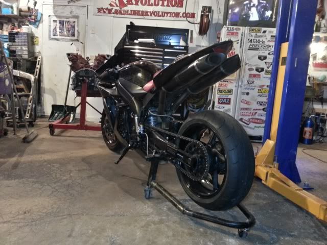

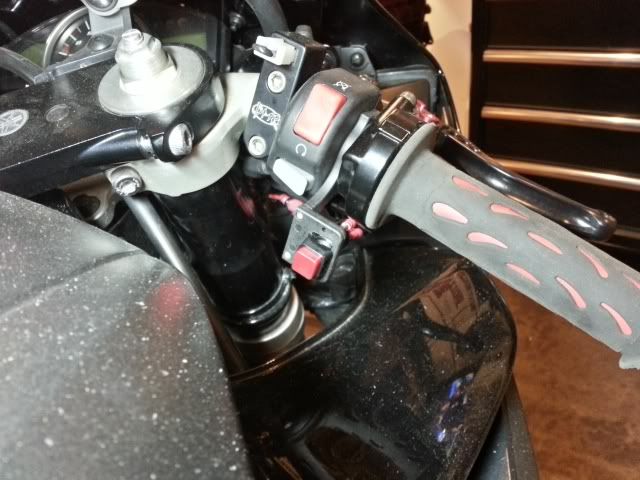

Finally got around to installing the new bottle mount, air shifter and re-wiring everything this weekend. Seemed like the biggest pain but glad it's done and like the way it turned out.
Ended up taking off the tank to run the new nitrous line and run some wires. Felt like I was going backwards for such an easy install haha
