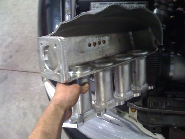

It was a bit loud when it blew and the car kept running with the manifold like that.

Haha no worries Kenny, I'd rather have it happen on the dyno rather than at the track.
We think it back fired on us because the first half of a pull my piece of crap bottle opener didn't open fully or at all, then I manually opened the bottle and then at maybe 5k it popped.
The throttle body seems all right once I pulled it off and I'm going to have Danny up at DB work his magic on the manifold and the car should be good to go by next weekend.
I was shooting a 125 shot at it which probably wasn't the smartest thing to do. Haha

With the bottle not open on the 1st run it sprayed only fuel which more than likely puddled in the manifold and ignited on the second pull.
Once you get it all back together are you going to try the 125 shot again or go back to the 75?

Thats insane. that shit is pretty thick material too.
I'm impressed with your setup, Glad to see that trans is holding

Yea pretty much what Brian said, I just couldn't explain it well typing on my phone after being up for 23 hours.

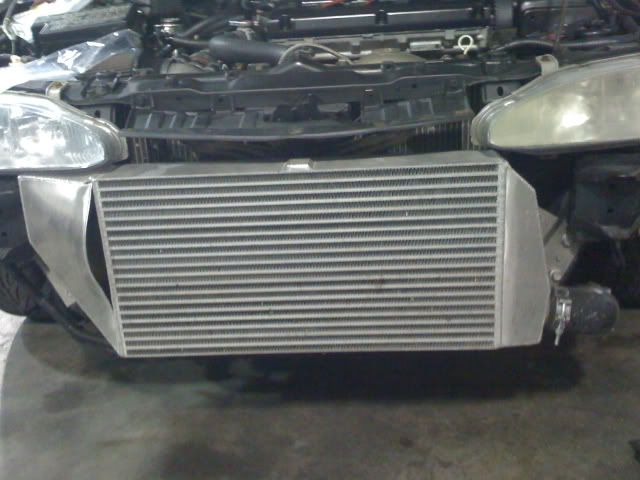

HUGE THANKS to Danny up at DB for already having my intake manifold welded back together!!!
I had the intake manifold already back on and while sitting down to eat some food I luckily looked at my intercooler and noticed that it might have a boost leak as well now. haha
Just another picture for shits and giggles

So it blew the manifold and the outlet tank when it backfired?
Old 08-15-2009   #39
Re: Find the boost leak
Holy shit! That's nuts that it blew open the intercooler too!
