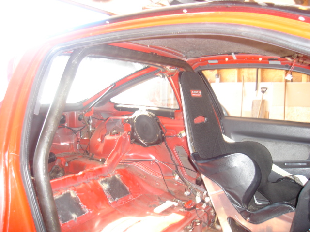

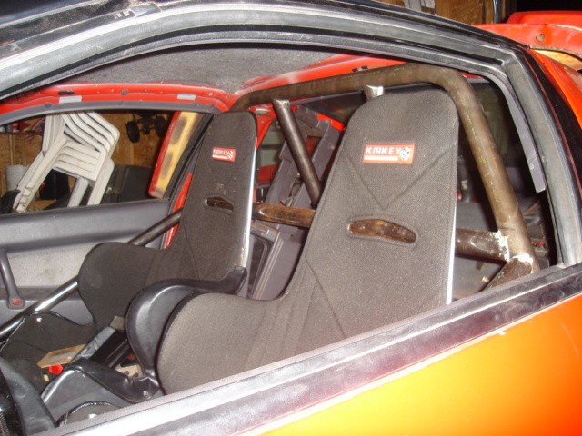

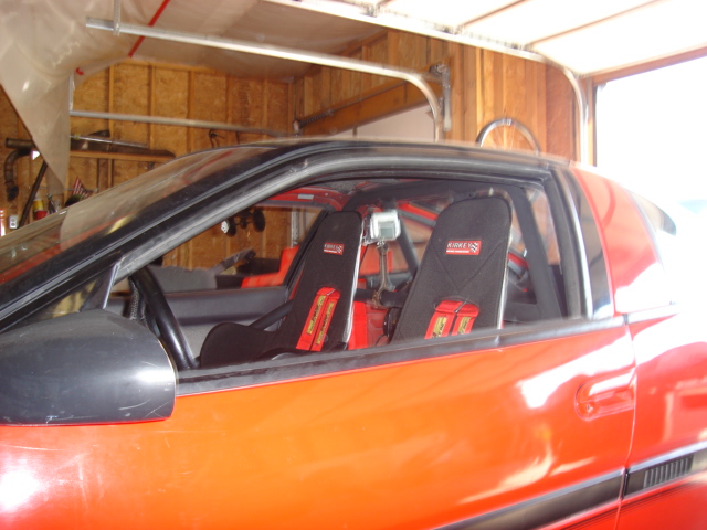

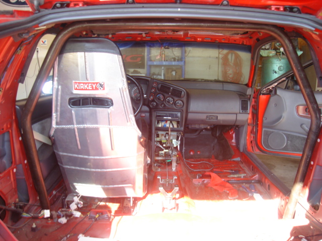

My Main hoop was bent with there bender. I got the hoop and the straight bars and welded it in myself. John even borrowed me his old tubing notcher.
A 6 Pt with swing outs would be nice in a street car. I really like how safe I feel in my car just driving around.
