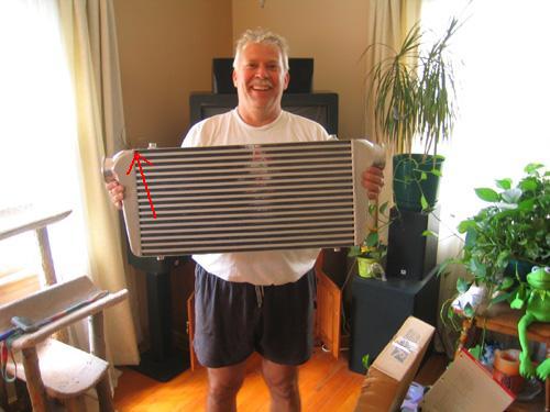

Old 03-30-2007   #30
Re: Intercooler questions?
I have thought of just getting it rewelded, but I don't like how I had to route my piping with this side to side outlet fmic. My driver side pipe is real goofy and occasionally scrapes. I'm just gunna take it all out, use that old piping for the fmic piping on the colt, and just get a short routed fmic kit for the talon.
So if anyone has a kit, let me know.
Old 03-30-2007   #31
Here is where it's leaking. Right on the inside, up against the end tank, in that very last row of fins, I feel a crap ton of air.
