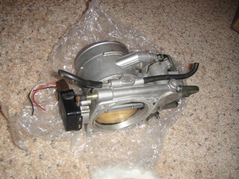

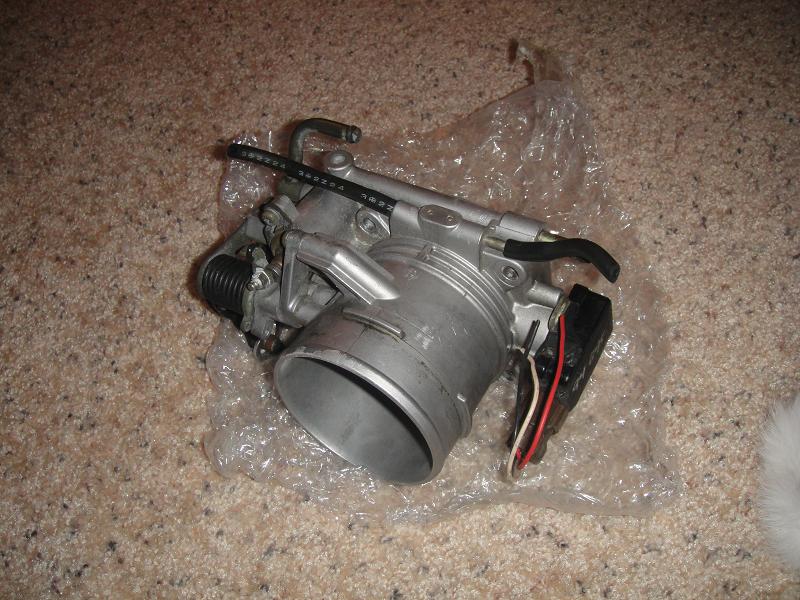

TB showed up in the mail today. Very clean, pretty happy with it's condition!

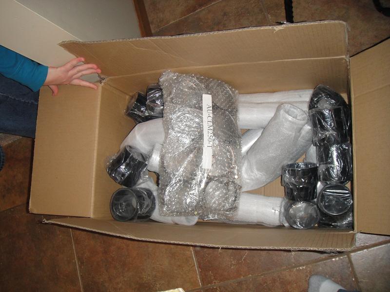

IC Piping and all the couplers showed up
