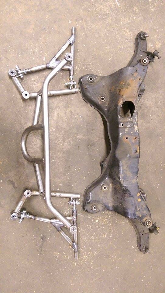

I'd like to see what you do with yours.
Here is a picture of their k-member.
Check this out, it's a good design. It has good triangulation with the best weight savings. I'm building this one:
http://www.dsmtuners.com/threads/93-....456345/page-7

Yeah that one looks good. I'll have to save that one for making my own. Looks like the hardest part is the ball joint receivers. I'm assuming heim joints will be used to connect lca's to k-member.

Quick update. If have been making parts for the kmember project. I made the tube tabs or chassis brackets, whatever they call them. They are made from 4130 and took forever to machine. I have all the materials so now I just need to get fabricating.

For those chassis tabs is it needed they go around the tube? Could they just have a radius and be welded on.

The reason they are round is that I can mock the suspension up without needing to weld any thing up.
