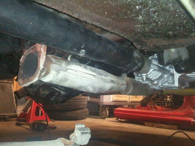

What it sounds like to me is that you may have borked driveshaft angles. I've never done an AWD swap so i'm not sure how easy it is to mess up, but if you have too severe an angle on one of your U-joints, you can and will get good amounts of vibration. Could also be caused by a really bad carrier. Although at 5mph I wouldn't think the shaft is spinning fast enough to even cause that much vibration.
Are you sure you don't have something rubbing on the bent knuckle, driveshaft rubbing exhaust, etc?

Yea all the videos and threads about carriers i've seen they get a vibration at like 50mph and under acceleration. I can get nowhere near that speed.
I will look to see if it might be hitting the downpipe.
The driveshaft looks pretty darn straight when it's bolted up and I tried my best to align it exactly where the other bracket that I removed was. But I don't have a tool to measure the angles of it, so I have no real evidence.

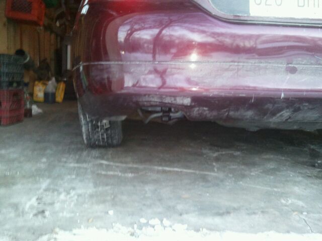

Heres the positive camber and toe issue. Toe isn't as far out as I remember but is still definitely positive.

Originally Posted by mark4g63t View Post
Any way to test or tell if it will need to be re-shimmed?
Pull out the cover, mark like 5-8 teeth with some gear marking compound, and turn the pinion until you can see the pattern on the ring. You will want to spin it both ways. The rear end has to be able to spin so it would be easier if the driveshaft and axles weren't in it. Otherwise I think you should be able to spin it with all 4 wheels in the air in neutral.
That camber issues looks pretty bad. I would definitely fix that asap as well.

Holy shit, that is some serious positive camber. You know how "stanced" cars only ride on the inside edge of the tire and how dangerous it is? That is basically what you are doing, except riding on the outside edge of the tire.
Old 02-06-2014   #38
Re: Very Bad Vibration
Holy shit @ that pic. Doesn't take an alignment machine to tell you how far out of whack that is. I'd get that corrected ASAP. I'd be fixing the things I know are wrong, one by one, and go from there.
