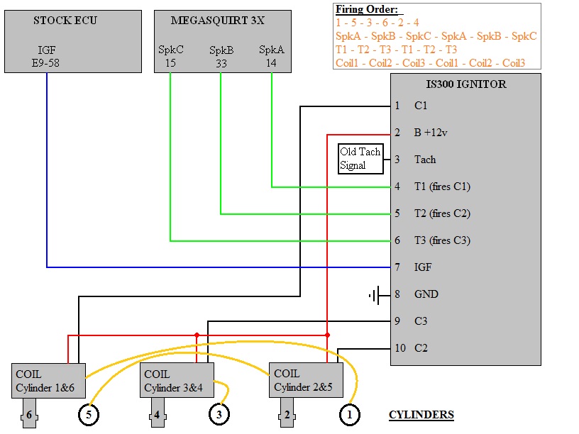

How I wired the new ignition, if anyone on here even cares lol.
Tried starting the car but it didn't start. My 12V appears to be missing for some reason so will have to troubleshoot that.

Old 09-12-2013   #904
Re: Project Lex
She's alive! Only had to change 1 setting in Megasquirt and she started right up. Need to solder in a jumper do the tach works. Also appears my noise issue at 3k rpm may be gone

Re: Project Lex
Soldered in a jumper across R109 on the gauge cluster, tach is operational again
