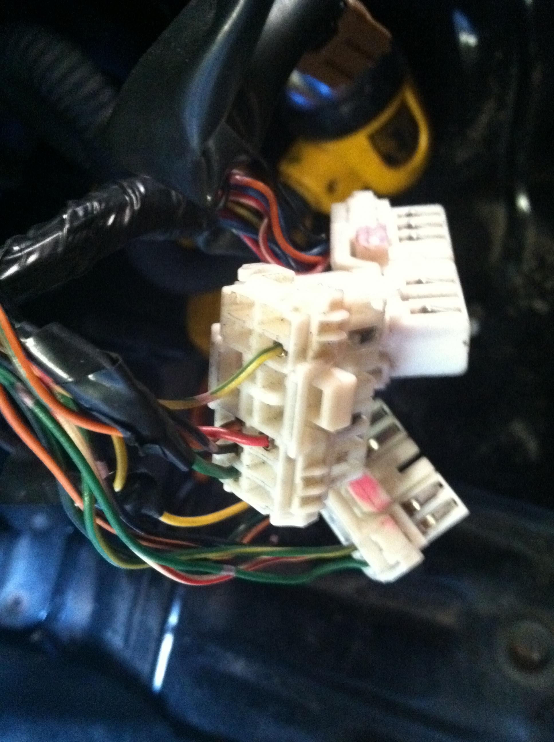

Hello, Ran into an issue that has caused me to need the pinout on the gauge cluster. My Nissan 240sx has an rb25det swap and i need to get it running again. Long story short i may have ran a 12v wire to one of the back of the connectors. it was a red/yellow (looks like just red) wire in the picture below, i put it to that terminal, it cut out, so i pulled it right away, then it hesitated for a second, ran for another 5 seconds, then quit on its own, and now the car wont start. it has fuel going to it. it has no spark, I'm really hoping for a cluster pinout. But, ANY help will be GREATLY appreciated! im ripping my hair out trying to figure it out!!

Well I believe I figured out the problem. When I put the positive wire to that terminal, I grounded/shorted the ecu. Destroying the ecu. Live and learn.
