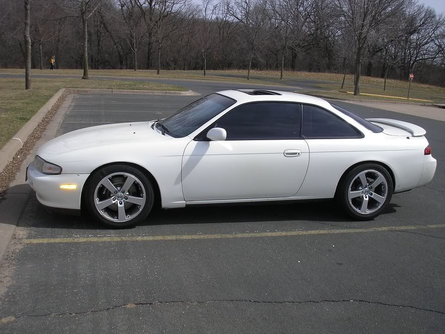

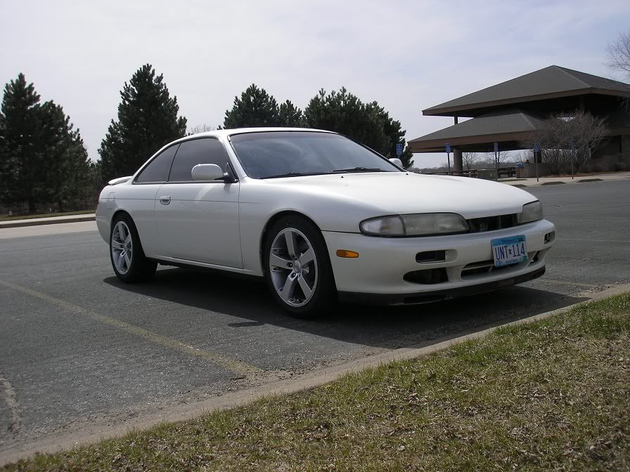

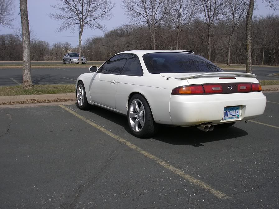

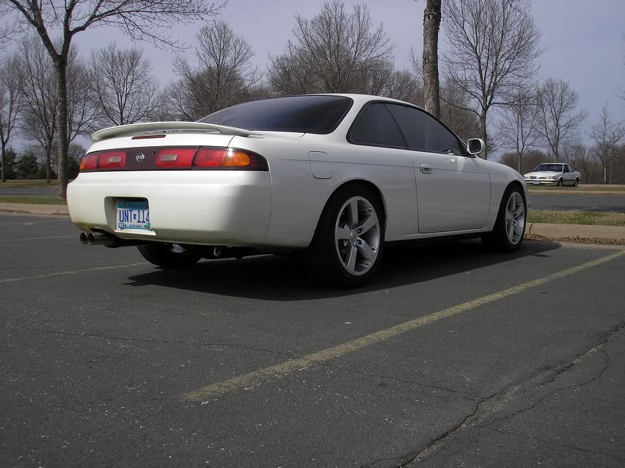

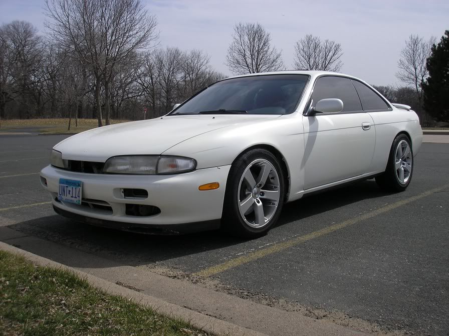

Adjusted the suspension a little today. Balanced out the rear since one side was about a quarter inch higher than the other, and lowered the front about a half inch to kill the wheel gap.
Also, got a radio installed yesterday. It's nice to have tunes again while I'm driving!

is that a sidewall bubble on your left front tire?

Yes, that is a bubble in the sidewall. I hit a chunk of something just before I took them off the DSM last fall. It hasn't grown at all, and doesn't cause any vibrations or anything, so I'm gonna let it go for now. If it starts getting worse I'll change it out.
