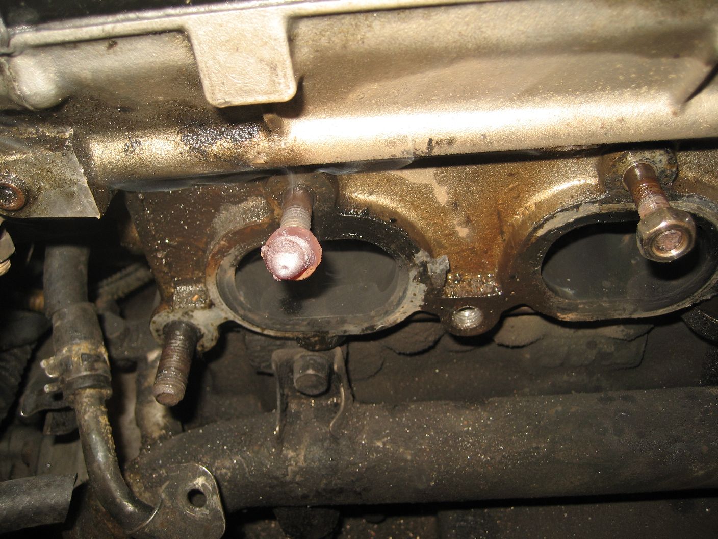

Well, first things first, here is the manifold on the car.
#1 shouldn't be that hard to take care of, however #2 is hidden from view and is completely gone.
Well, in order to remove stud #1 I had to weld a nut onto what is left of the stud, I had tried the multi-nut-on-stud trick, and it just didnt budge.
Now the advantage of superheating the stud is it expands and "breaks free" making it easier to twist out.
Thankfully, the #2 stud that I was trying to remove was just GONE, it had vanished, and it took the threads too

OK, now that both studs are removed/repaired, I had to make a decision on the rest of the studs....they are all rusty and I cannot get any of them to move, I really don't want to sell this car to someone just to have another stud break on them down the road, so I think replacing ALL of the studs is a good idea.
So, since the studs will not back out using the normal 2x nut trick, I break out the welder and some americanized M8x1.25 nuts (the 13mm wrench type)
Since I don't ever want to use a 13mm wrench on any DSM's I own/work on, I will sacrifice these nuts to the better cause.
As you can see, the nut is glowing cherry red, I can hear the metal change shape as it cools.
