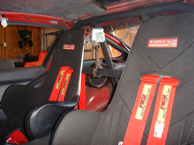

I got my Interior in and made a camera mount out of a 6-bolt rod.
just gotta find time to pickup a radiator from brandon and I'll be street tuning.

Lookin good Carl and that camera mount is great!

LOL, bad ass!

Looking good man! And I love the camera mount, very original!
