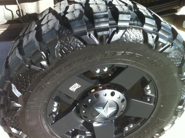

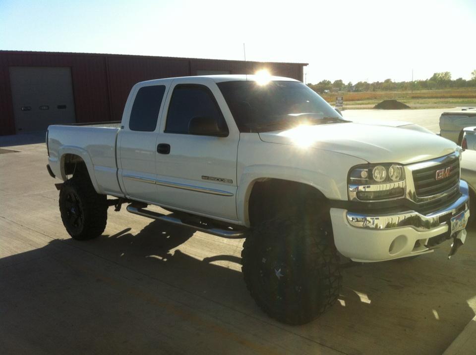

meeeeatty tires

You have the 6.0 gas hog, you have big tires, you have a lift kit. All are strikes against you for gas mileage, and now you're wondering what to do to get better mileage? Maybe you should start pulling a big ass trailer while you're at it to get even worse mileage...

Get rid of the lift kit. Get rid of the big tires.
