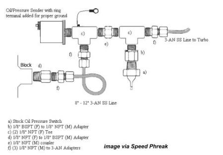

I don't recomend using an FMU, there just a "band aid" not fuel managment. And be advised that using the AFC will advance the timing. If your a baller EEprom is the way to go but right now, off the top of my head I can't tell ya much about OBDI (OBD0 for life!). There isn't really a simple, cheap, effective fuel managment for hondas, fun huh? If you have any more questions, shoot. This will help ya out to: http://www.honda-tech.com/zerothread?id=377208

Old 05-19-2004   #5
2003eclipse
Slower than a rusty Honda
2003eclipse's Avatar
that pic, now that seems like oil and everything to me but you were talking about fuel. im confused just shoot me a little more info about the pic.
I LIKE TURTLES
Old 05-19-2004   #6
2003eclipse
that pic, now that seems like oil and everything to me but you were talking about fuel. im confused just shoot me a little more info about the pic. Okay so that is oil then, I'm not familiar with EEprom at all. shoot me a little info on that if you could.
I LIKE TURTLES
Old 05-19-2004   #7
IndiEP
Tha MIG Masta!
IndiEP's Avatar
Location: Maple grove
Posts: 473
Sorry about the confussion. The link and the pic are schematics for oil feed, not drain though. EEPROM is the type of chip on the ecu that holds fuel/spark maps. Many people have developed programs that allow you to completely customize fuel/spark, burn it onto a chip and place it back in the ecu. the programs are free, the chip burner doesn't cost to much, chips can not be bought individualy but are not to expensive. The kicker is you really need a wideband to know whats going on. Hope this helps, right now I gotta go to work. :razz2:

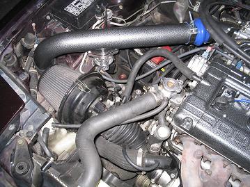

I have a fuel pump sitting here if you want it. I really do not know what kind it is or anything. I had sold someone my old 3kgt vr4 fuel pump, and for some reason he shipped me back his old one. I don't know if its a 1g or 2g one, and it doesn't have the little filter part that attaches to it. It's just the pump. If you want it, I'll be home in like 2 weeks and could get it to you then. Also I gotta crushed 1g bov sittin here if you want too. It works perfect, but is kinda strange looking because the owner of this car before me kinda customized it by putting a cross drill pattern in the part that the air blows outta. Here I'll show u a pic. Anyway, if you want em, I'll let you have em for a very small fee. If you can pick em up in Minneapolis where I'll be, you can just have em. Just bring me some McDonalds or sumthin!
