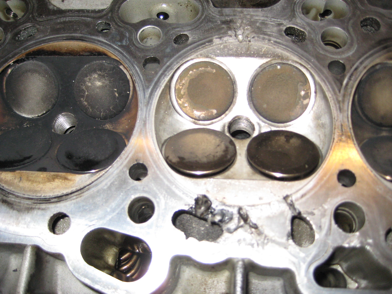

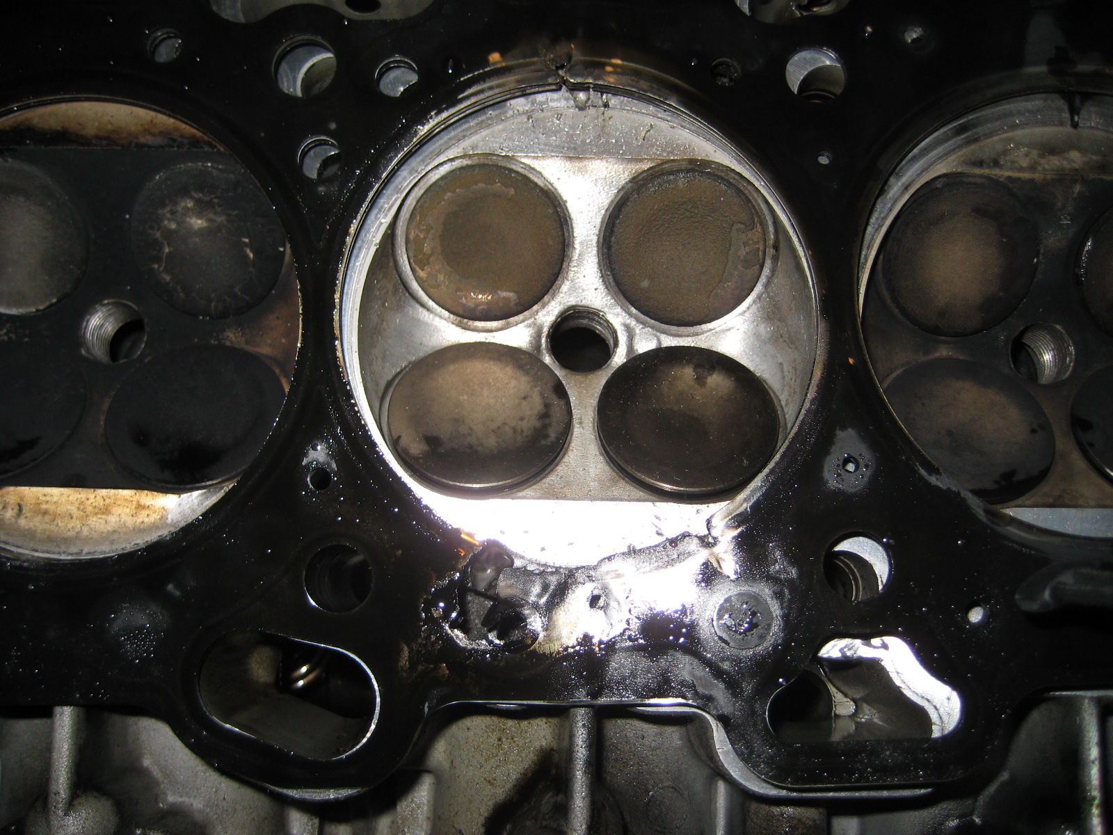

A little backround on the car, some of you might know about it since it's a local car. It's black with 75k miles, built 2.3 stroker, built head, FP Red, ACT clutch, blah blah. Nice shape overall and I'm very happy with it. But I bought it knowing it needed a headgasket. I was hoping that's all it was and I'd have it at DB on Saturday, but my luck dictates that it's never that simple. I pulled the head tonight and found this. Obviously the head is trashed and needs to be replaced, which sucks since it's got stainless valves and upgraded dual springs. The block has a bit of damage as well but is still useable as is.
I have to decide if I want to slap another head on it knowing that it's not 100%, which is definitely not my style, or do I pull the engine, deck the block and have it rehoned with a torque plate. The bad part of this is that I already have three other cars that also need work to be in running shape. Luckily my GSX is done except for cosmetics and runs like a champ. And I might need this as my only daily driver as early as next Monday. Oh well, it's going to be a lot of fun when it's done.

Are any of the valves bent? If not, why not just throw them and the springs in a good head? Also, congrats to both of you on the Evos! I love them in BBY
Old 01-21-2011   #3
Re: Another new '03 Evo
The valves are in good shape, so yeah, a bare head would be even better, still need a valve job though. Or maybe a MIVEC conversion.

Thats some pretty nasty damage. The car actually ran pretty good considering how messed up that head is. Do you have any pics of the block side? I guess I should have just pulled it to my house.

Thanks guys. Yeah, the car actually ran pretty well considering how bad the head and gasket are. The block is almost perfect, shaving it a couple thou would take care of it completely. The damage isn't directly on the edge of the cylinder, so I'll probably leave it as is because I know I'll want to do some major upgrade on it in the future anyways, I can't ever leave well enough alone.

is that damage from blowing the head gasket or from continued driving after it blew. it looks like 123abc's head on his 1g

That's some crazy detonation. Any chance of it being welded up and milled down?
Old 01-21-2011   #17
Thanks d-bag, this car is just as old as my GSX was when I bought it.
Well, after some diagnosis at MAP, we've decided to start with a used core and transfer my springs, valves and such to that and give it a performance rebuild, so I should be back on the road by next weekend.

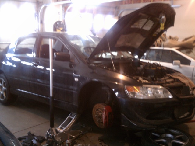

Sure, here's it's current state, and as suggested by Carl, a full shot with my collection, all cleaned up ready for the show circuit.
