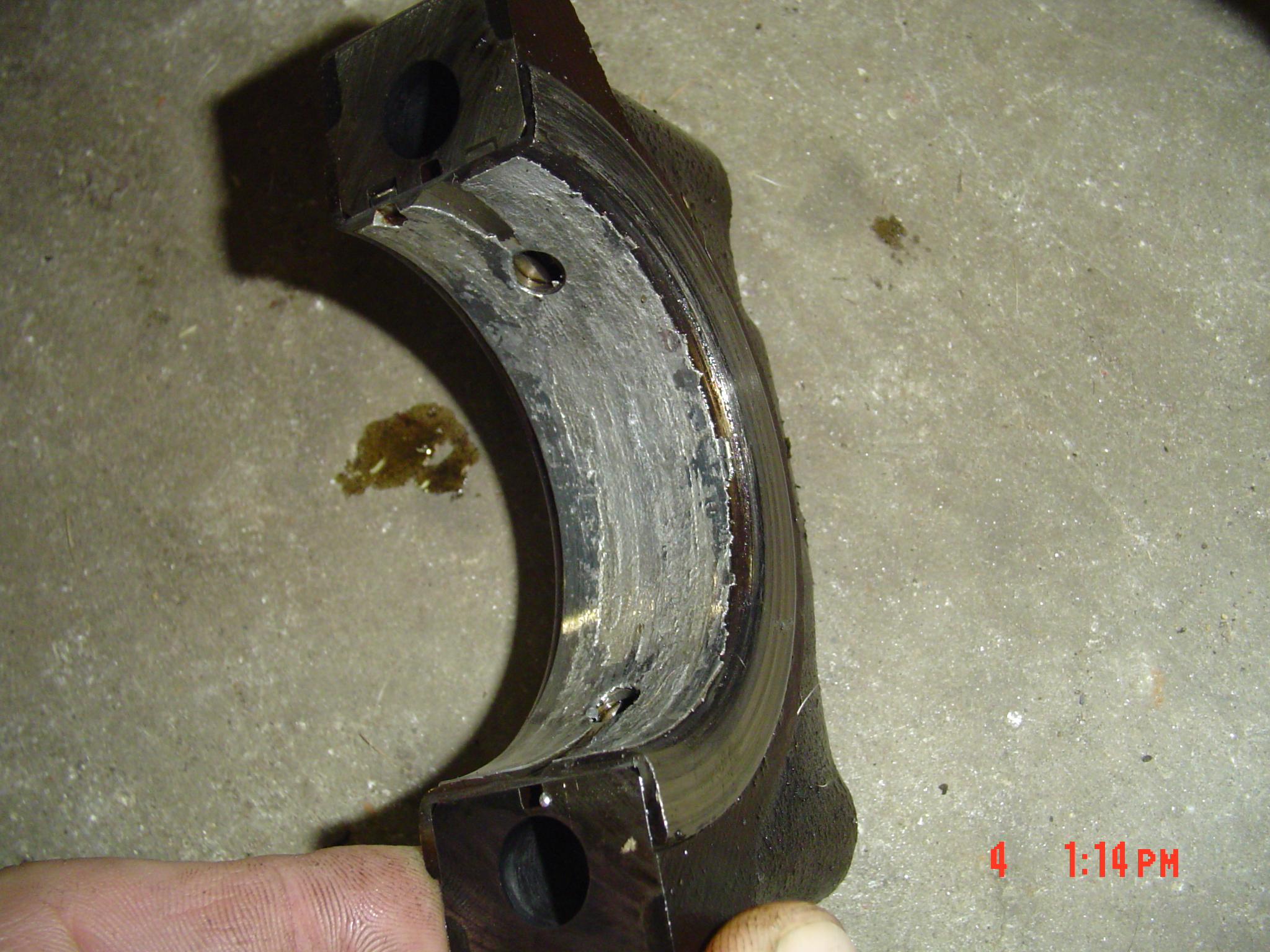

I have seen 6-bolts with destroyed cranks and blocks from crankwalk.
Old 09-30-2008   #12
Re: motor loads when clutch pedal pressed
seen that also it happed to one of craigs blocks and cranks,because crank shaft supply was to polish the crank and they cut it and did not tell us. the crank destroyed the block and oil pump in a month. they ended up buying a new mistu block and crank for us for there fuck up

well 6 bolt motor guys should take note... you are not immune to crank walk. I didn't bother to measure the walk in this but its at least .020"
