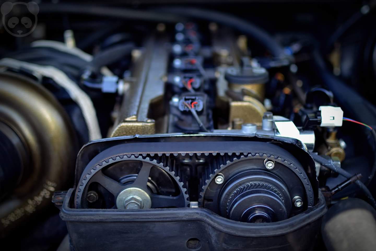

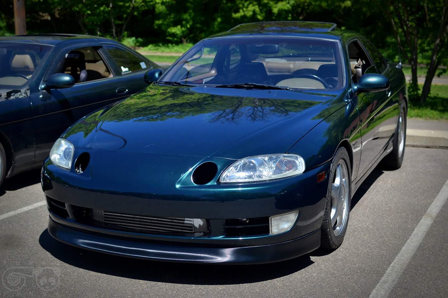

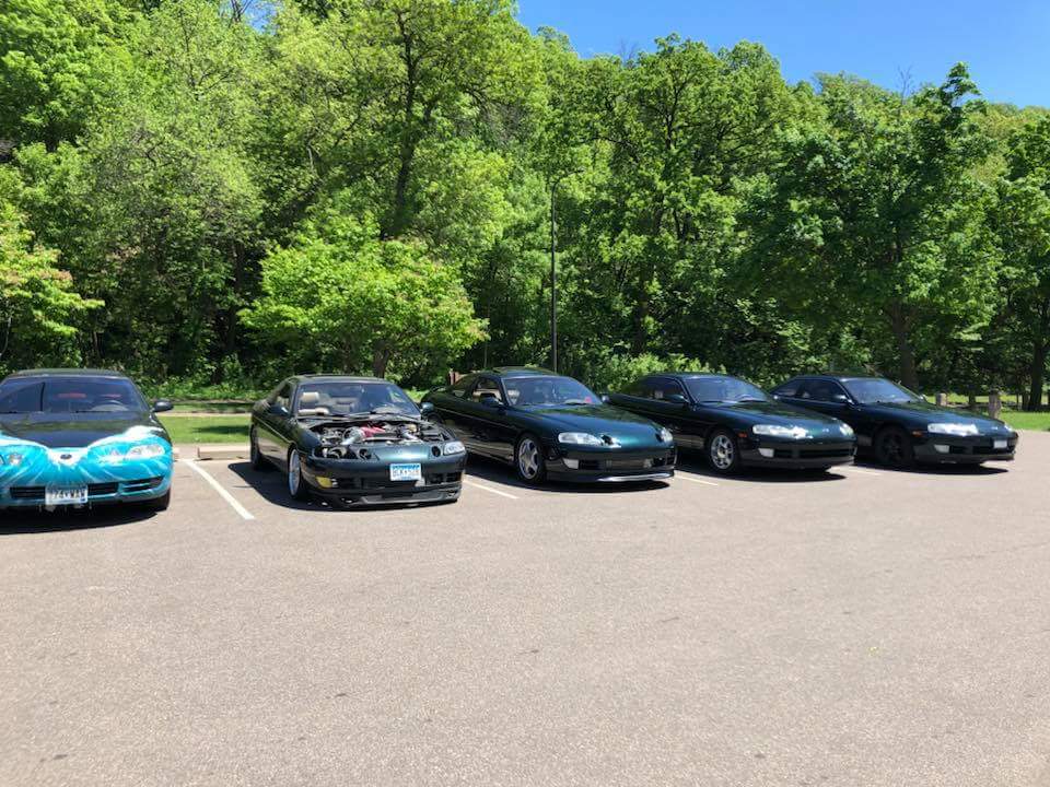

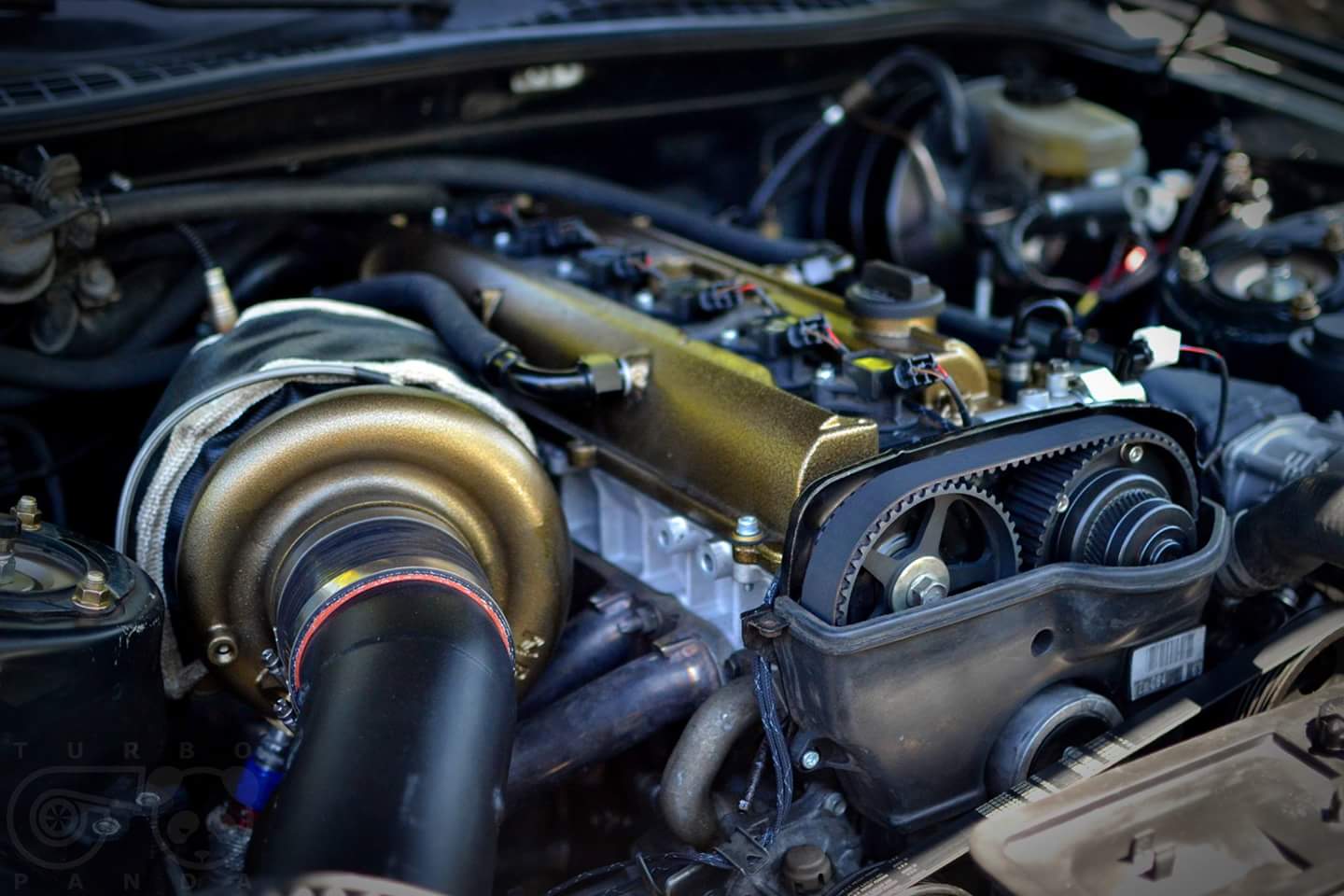

Some pics from todays Midwest SC Crew meet.

Looking good! Nice centercaps!

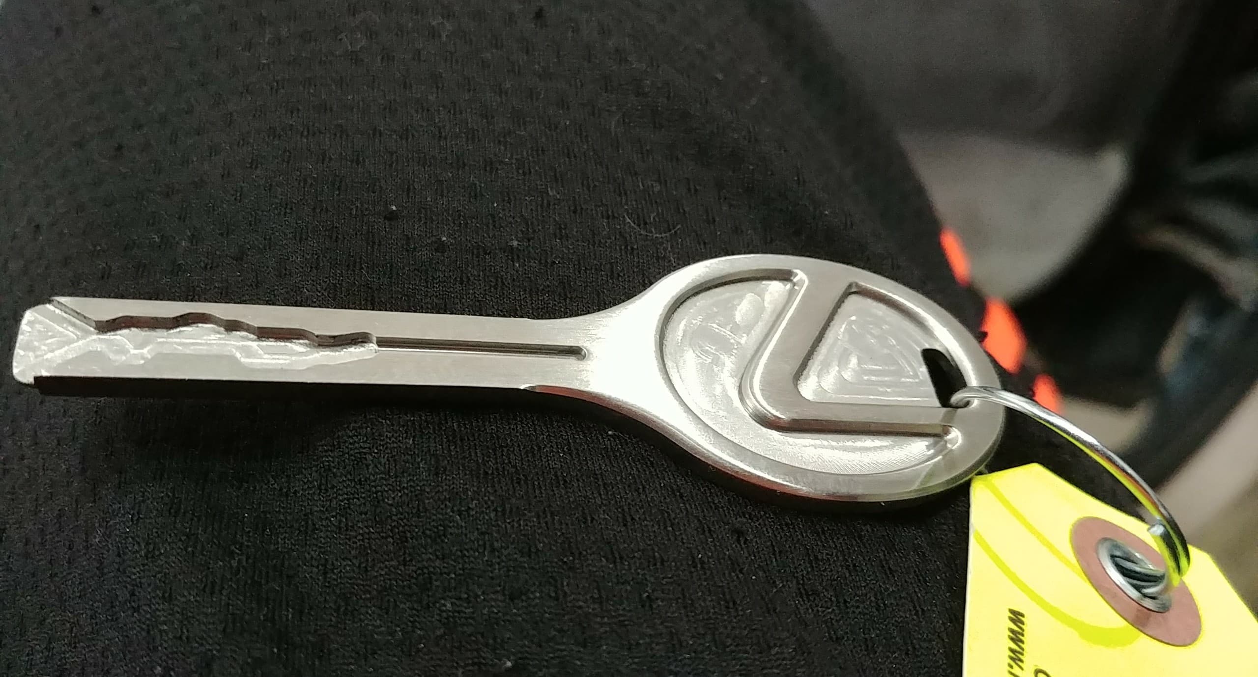

New cool key Local guy that i do some of the solidworks/cad stuff with, he designed a key blank. Had a bunch made from SS. Had a guy on FB cut it for me, i sent him a photo of me key and he was able to decode it just from a photo lol. Anyway kinda cool

Sweet! Kinda crazy he could decode the key from a picture lol.
Old 06-08-2018   #1726
Re: Project Lex
Kinda scary actually...
Old 06-08-2018   #1727
Re: Project Lex
thats pimp shit. Get it gold plated now!
Old 06-12-2018   #1728
Re: Project Lex
Whoa that's nuts...
Old 06-12-2018   #1729
AwdGSX13
AwdGSX13's Avatar
Drives: Cars
Posts: 1,457
Re: Project Lex
I just replaced my exterior door knobs on my house and had them re - keyed and the guy said he could cut a key just by looking at it. After watching him do it I can see why.

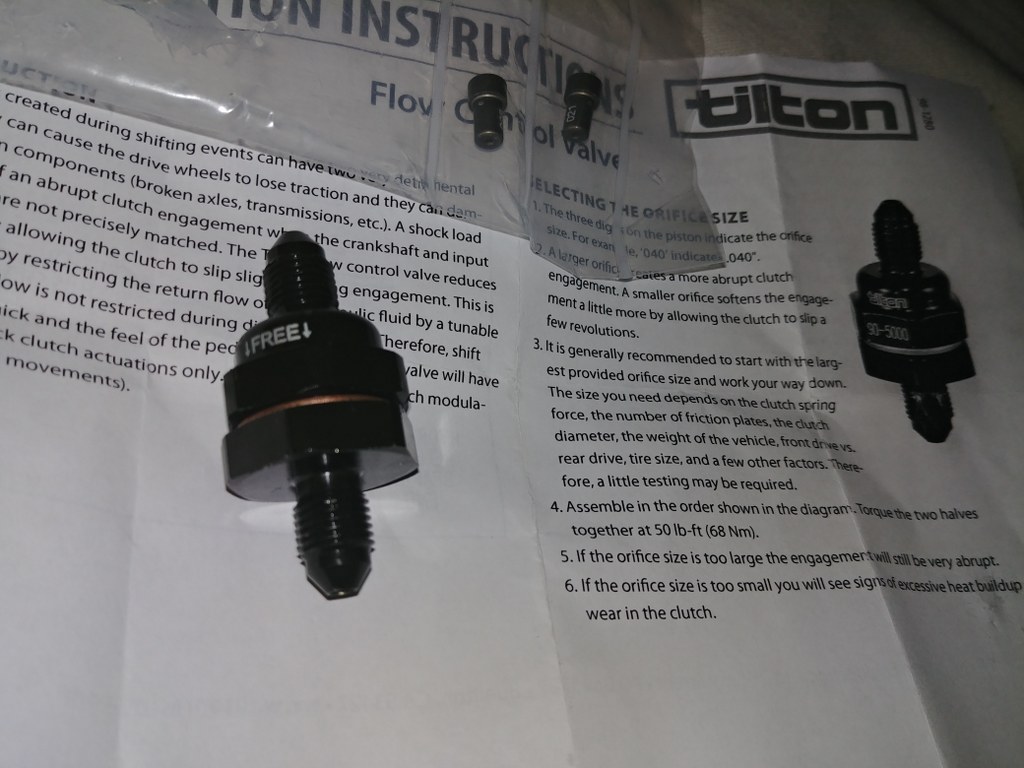

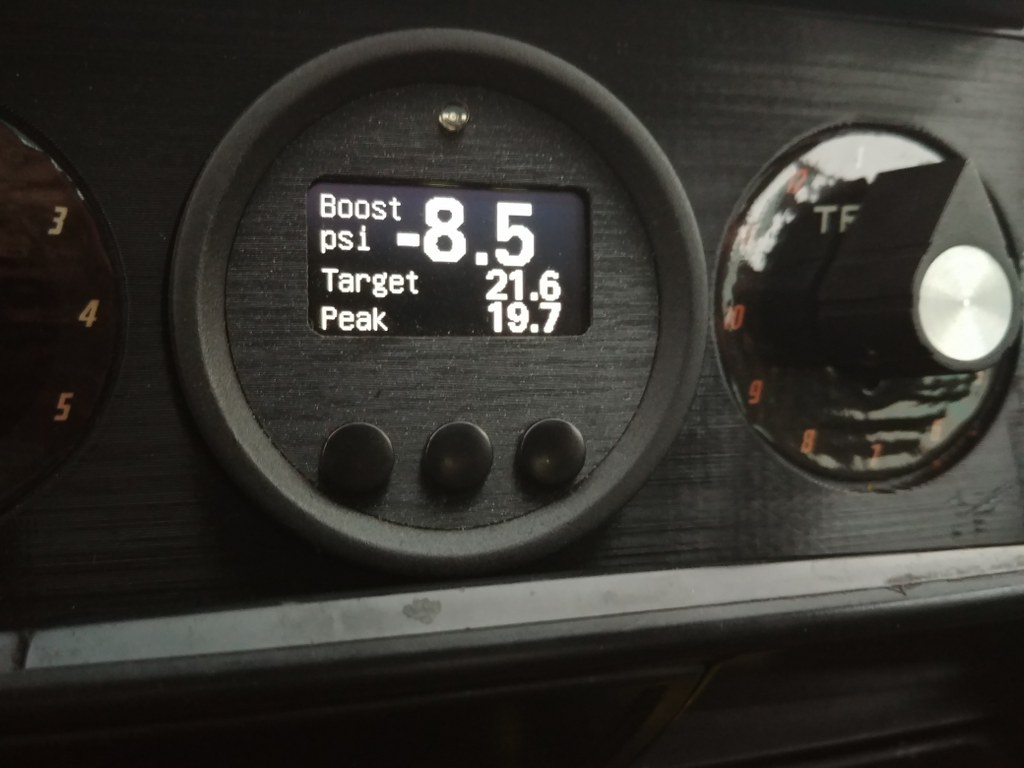

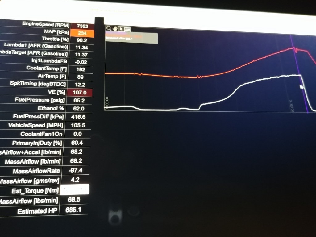

Nothing to huge to report. But we're done with the pump tune. Slowly starting to mix in e85 and turn it up. We're at about 20psi now on ~e60. So far so good. I know this graph isn't going to be all that accurate, but gives a general idea. Not to bad for e60 at 20psi Plenty of room left to keep going!!
Also, I got a Tilton slip valve. Currently it's installed with the smallest pill. Going to be trying it out for awhile here and hopefully helps me better my terrible 60ft's at the strip!

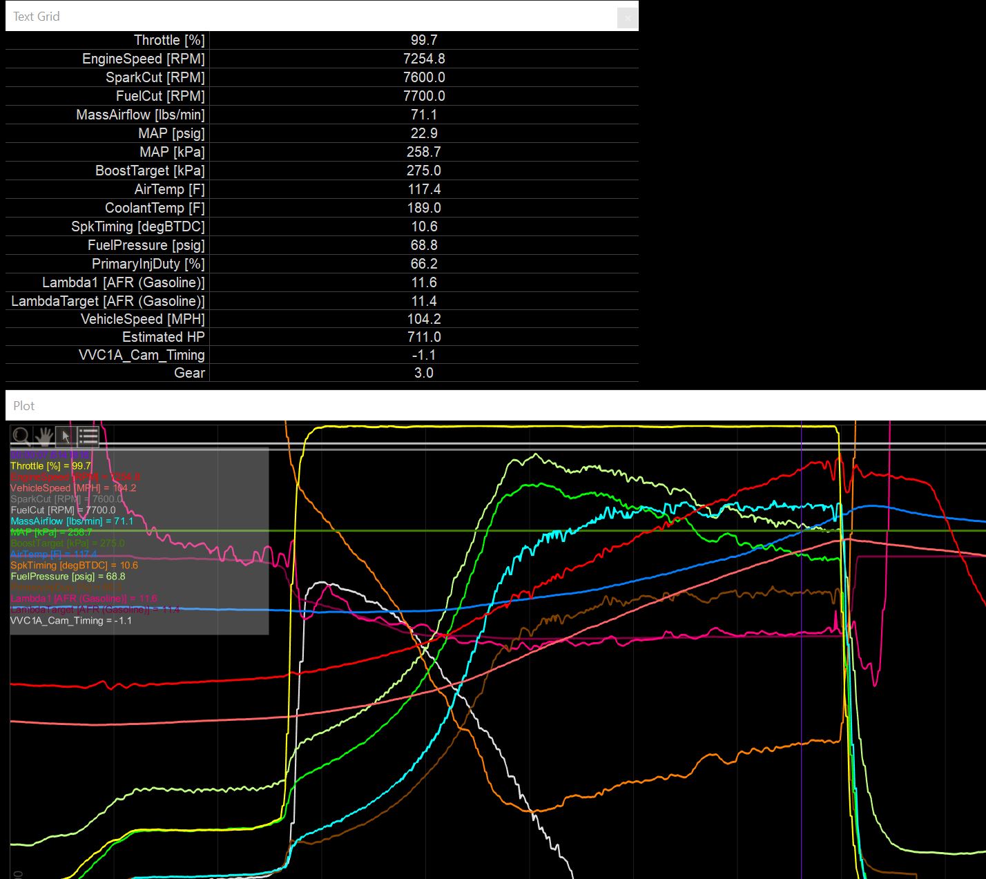

Haven't had a ton of time on this car, but got some logs in today. I think we're already maxing out the flow of this new turbo. Here's a screen shot. You can see the boost pressure tapering off quite a bit (bright green line). But airflow is pretty steady & flat (aqua blue line). So we will still continue to up the boost but I think it'll only really make more boost early on, because at like 7000rpm and beyond I don't think it's going to flow much more actual air.
AEM shows a 710hp estimate. For comparison last year when I made 709hp @ DB, AEM estimated roughly 630hp. So a 70-80hp difference then, so if it's similar on the new setup that means I should be somewhere around 780ish or so. We will see, someday I'm going to get it on the dyno.

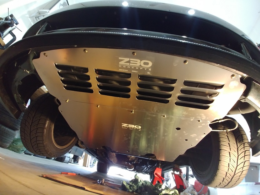

Also I got some new under trays from Z30 Concepts. I'm missing a factory piece to finish bolting up the rear. Once I have that it'll be buttoned up. But very happy with the fit n finish. Gave me a great price since I ordered the full set.

Riding on one wheel? Brave man!
Old 08-21-2018   #1738
Re: Project Lex
Awesome! That undertray looks super pimp!
Old 08-22-2018   #1739
Re: Project Lex
Definitely like that undertray, that's cool. Should be very beneficial as well. I know there was a huge difference in aero, cooling, and road noise with the factory Evo undertrays removed.
Old 08-22-2018   #1740
Re: Project Lex
Thanks. I paid $198 shipped for the whole undertray setup. It's super lightweight so won't add any noticeable weight. Very happy with it.
