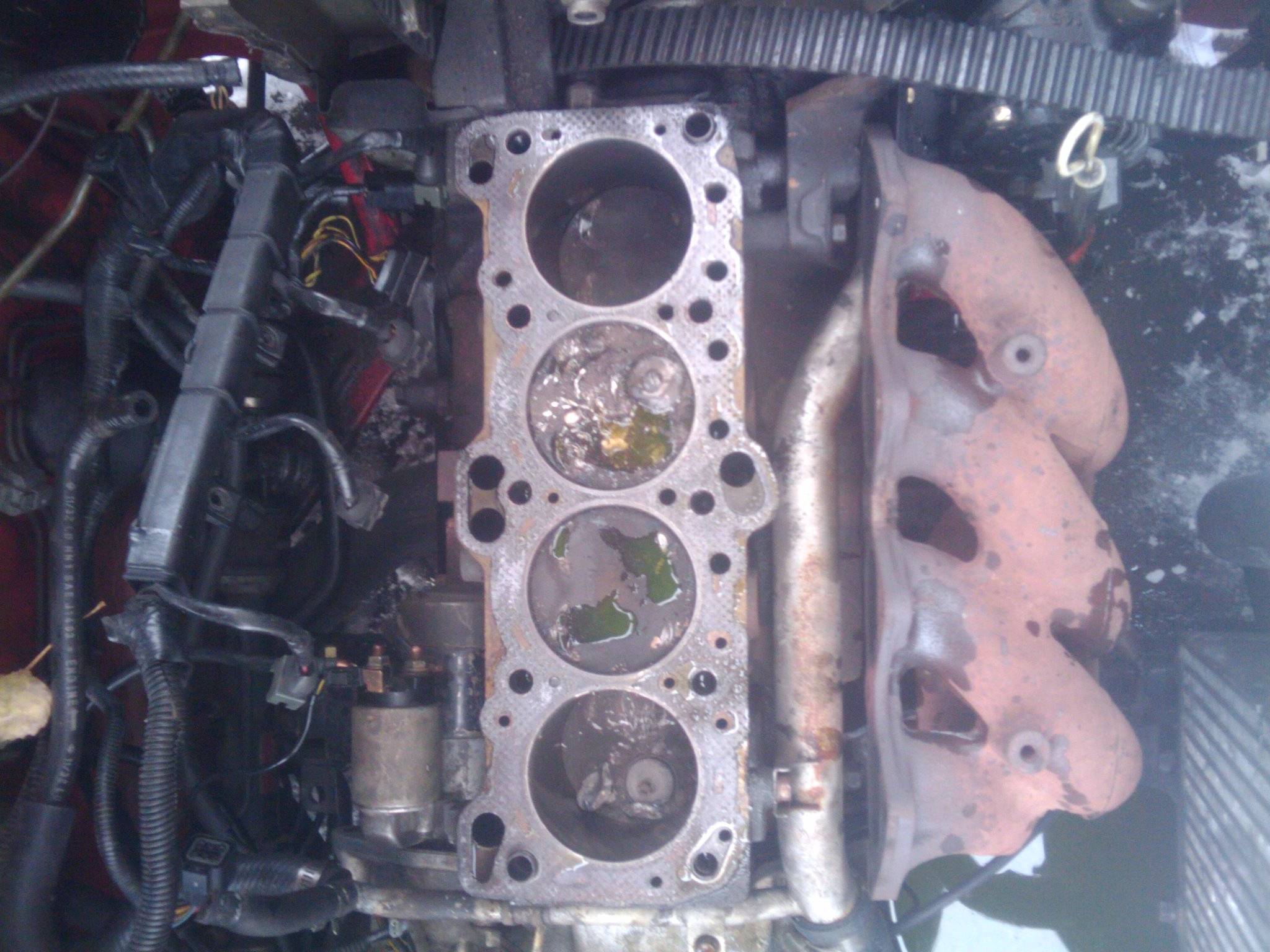

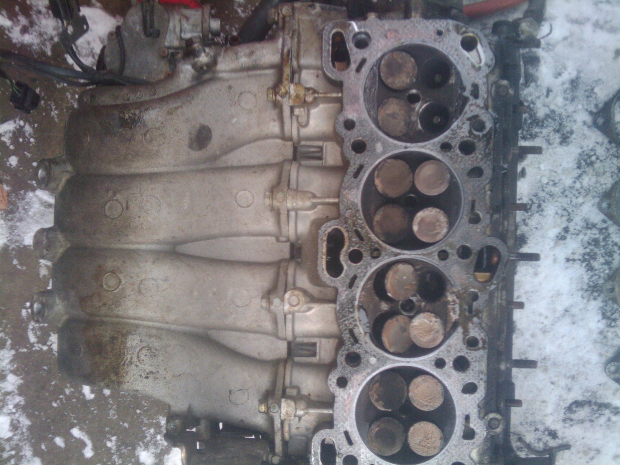

As some of you may know, this thing blew up a couple weeks ago. Mark and I tore the engine apart and this is what we found.

Wow, how did that happen? Timing belt come off and break all those valves?
Old 12-17-2009   #84
Re: the wifes (Ali's) new car 89 mirage turbo
Yeah. A few days prior to this an oil cooler line came off when she was going down the freeway. It still started and ran ok after the line was re-connected and oil was added, but it seized up a balance shaft and took out the timing belt the day we got all that snow
Old 12-17-2009   #85
she was driving to work and the oil cooler line blew out and out came all the oil. the car still ran after we fixed on the side of 94 and got drove it home. the oil pump failed when I went to move it out and back into the drive way so they could plow it.
so pretty much
oil pumped failed
locked up the b.s.
took out the b.s. belt
b.s. belt took out timing belt
it has not been a few good weeks
alys car blew up
ripped 1 of the tial's off the manifold on the evo (snow and jack jumping on my arm and curb dont mix)
car ran into our tree in the front yard(still have to post the pics up)
blew a 6in hole in the right rear tire of the evo
Ali is losing her job also
I need the month to be over already

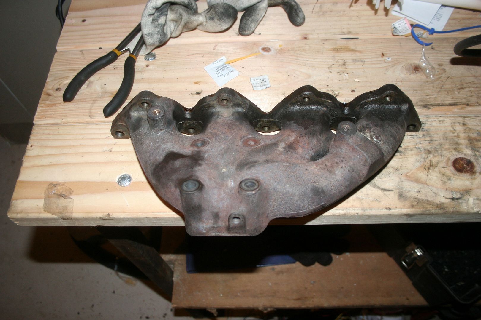

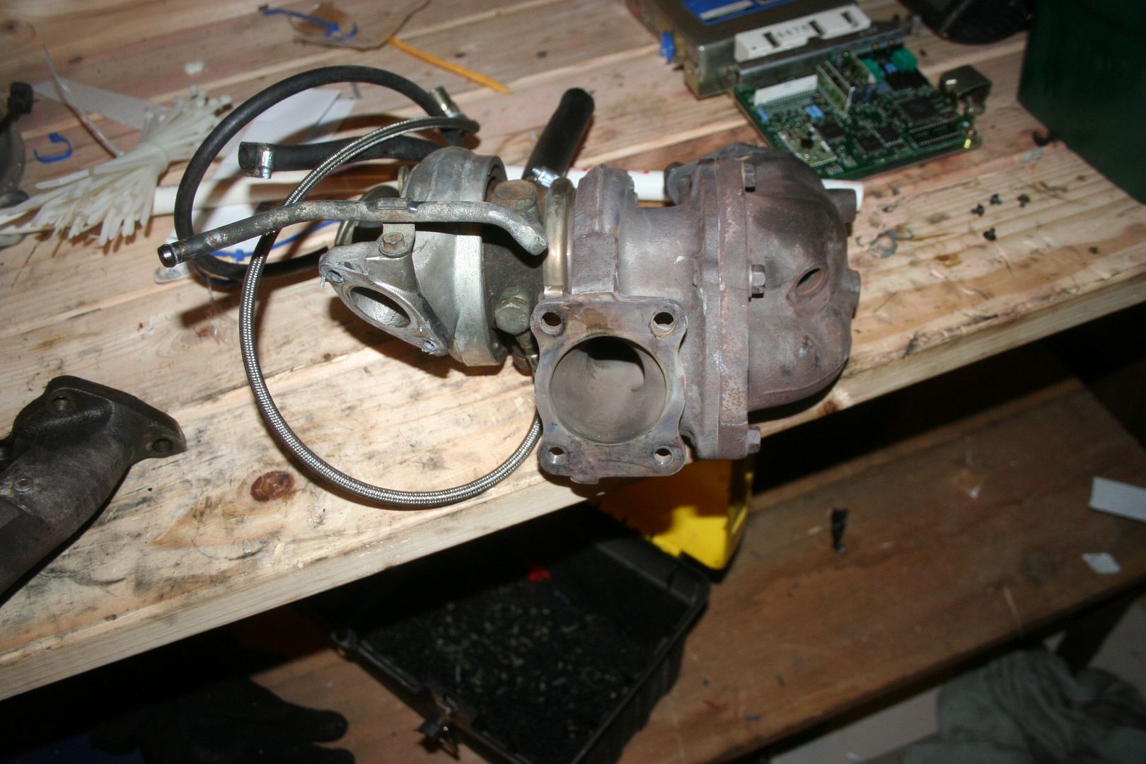

now to the new stuff. I have 90% of the parts to put a turbo set up on the car. I think it is funny since it is a oem 4g61t car and it has been a na car since I put it together even with the built engine and built head.
first off I traded off my zentronics wideband for a maft translator,extension harness and new gm mas and 400.00 cash

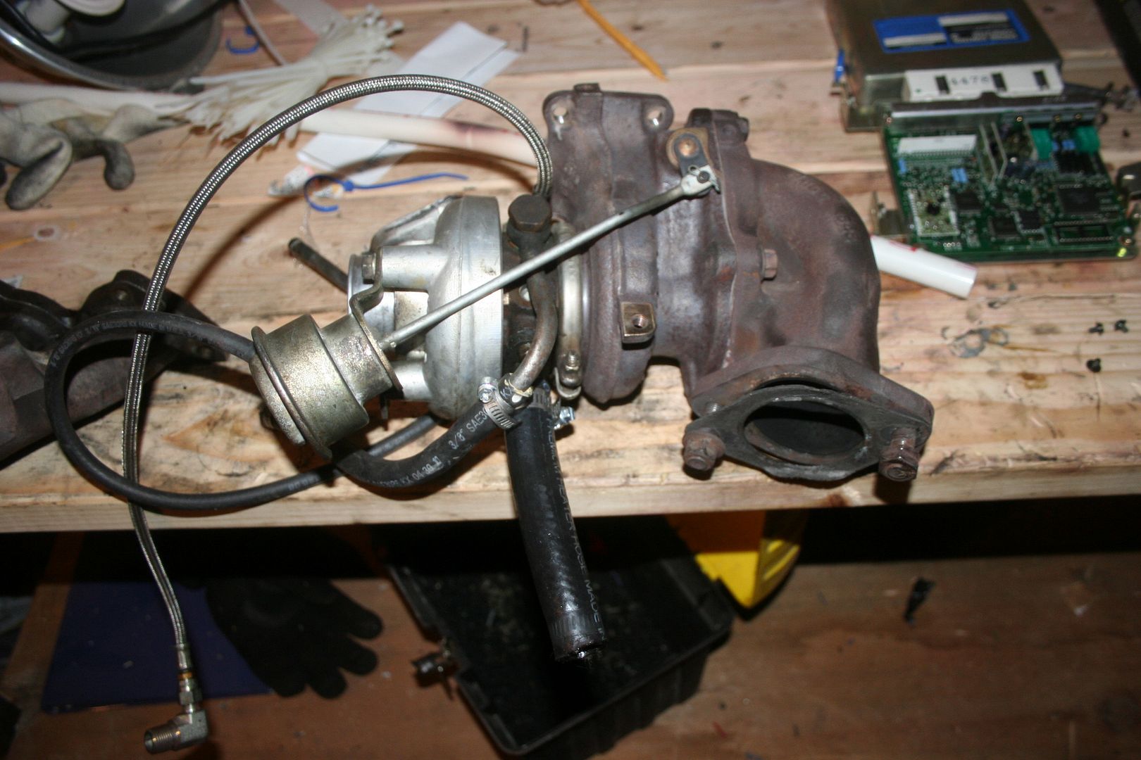

mhi evo 3 turbo and evo 3 o2 housing
evo 3 mani

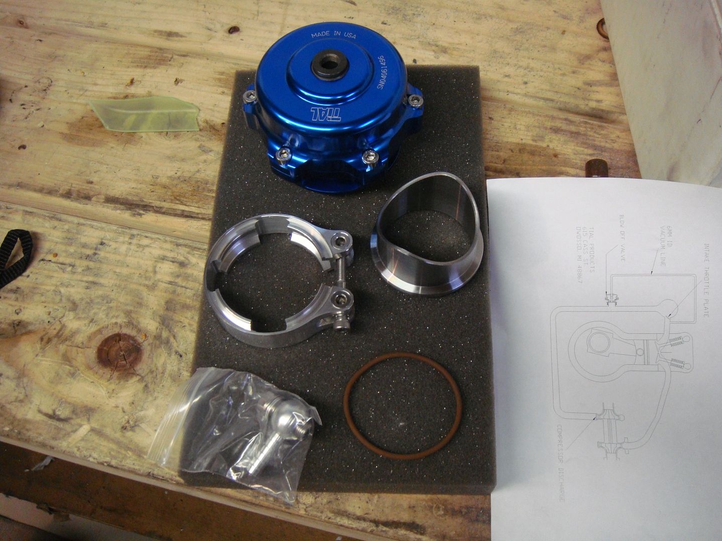

got a brand new tial bov for 150.00

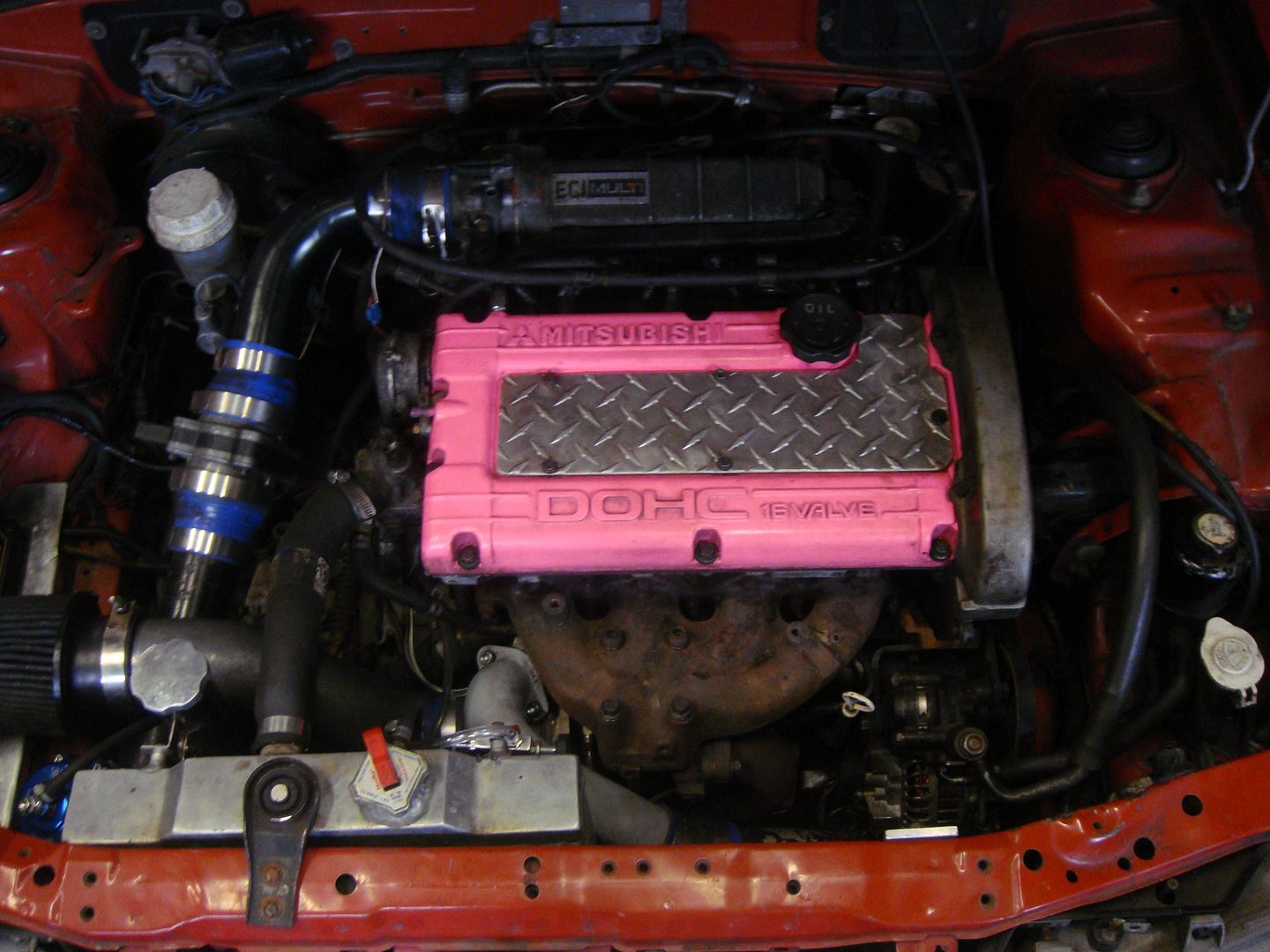

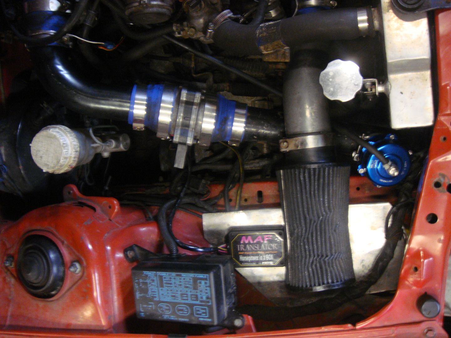

have had the turbo on the car for awhile
changed things up a bit with the car
db performance mbc
db performance custom eprom chip
dejon tool 3in intake pipe
k&n filter
new heater core,t.stat, and rad cap
fic 850cc injectors
put in a new pass side axel
put in a new alt.
new p.s. and alt belts
still have to put in the 255 wally pump and the buschur racing afpr and gauge when the tank is not full
used the shorty piping I made for the evo 3. just had to shorten up the hot side pipe.
Also had to totaly rebuild the FP j-pipe since it was for a 2g install kit.

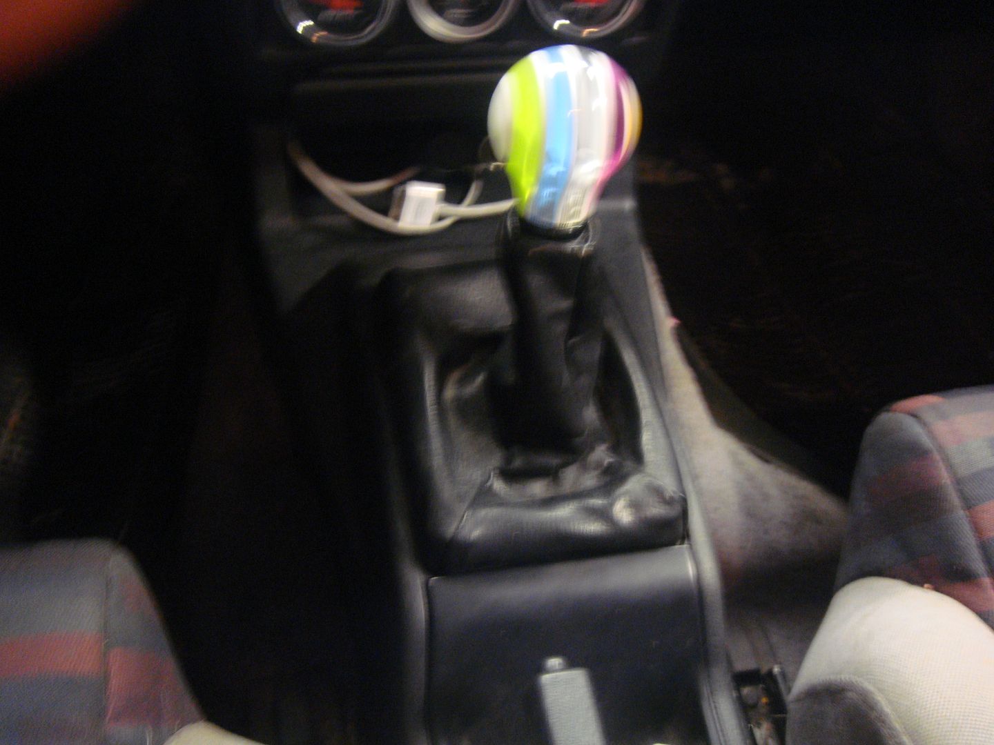

just used the boost gauge I found in the garage also found the shift boot for the car that I got last summer then lost in the garage.

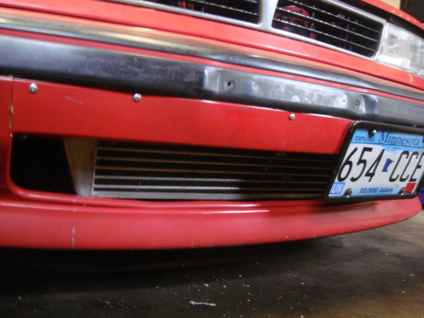

the fmic moved the lic plate to the side

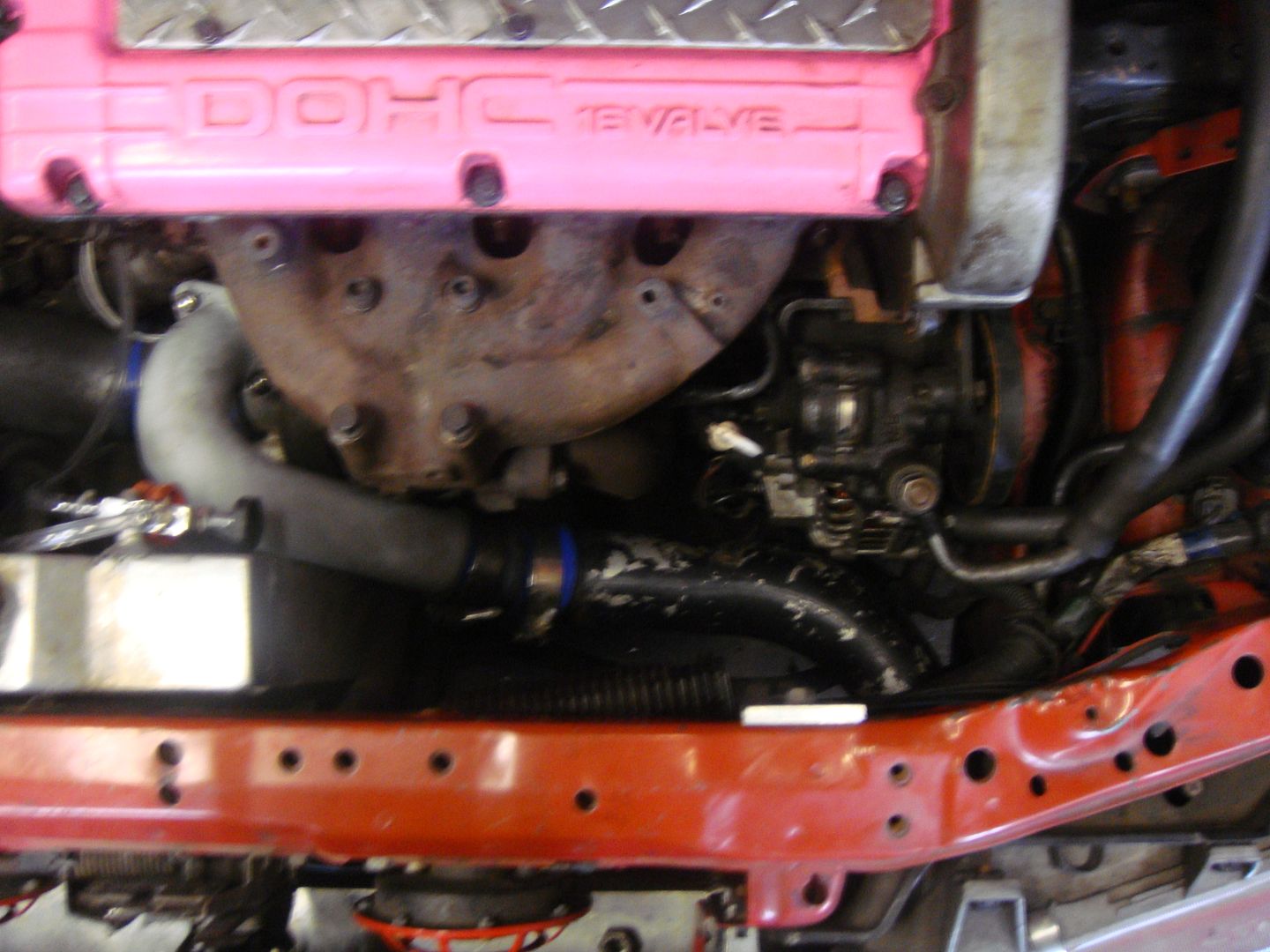

also put on one of the pink valve covers today
