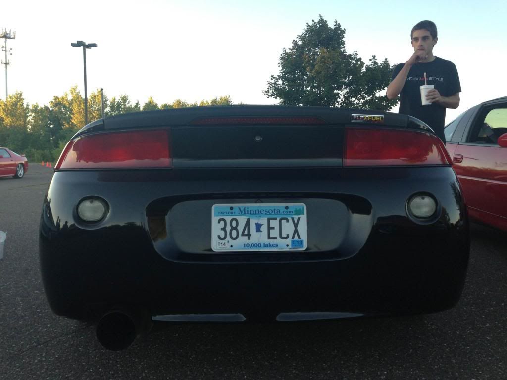

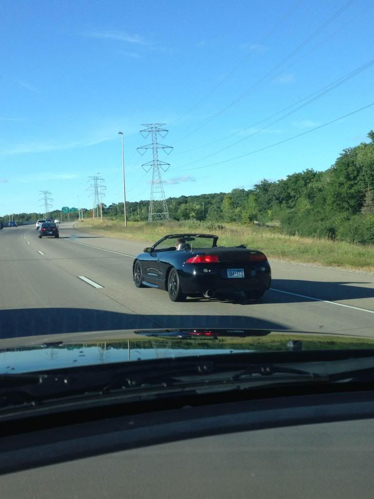

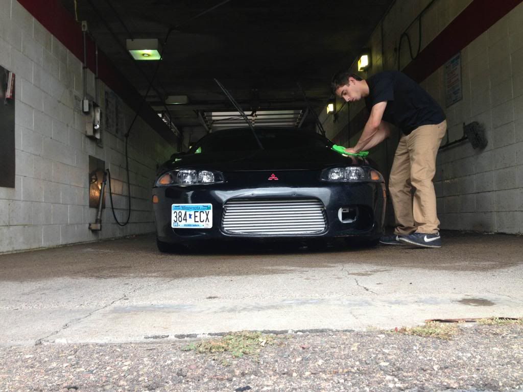

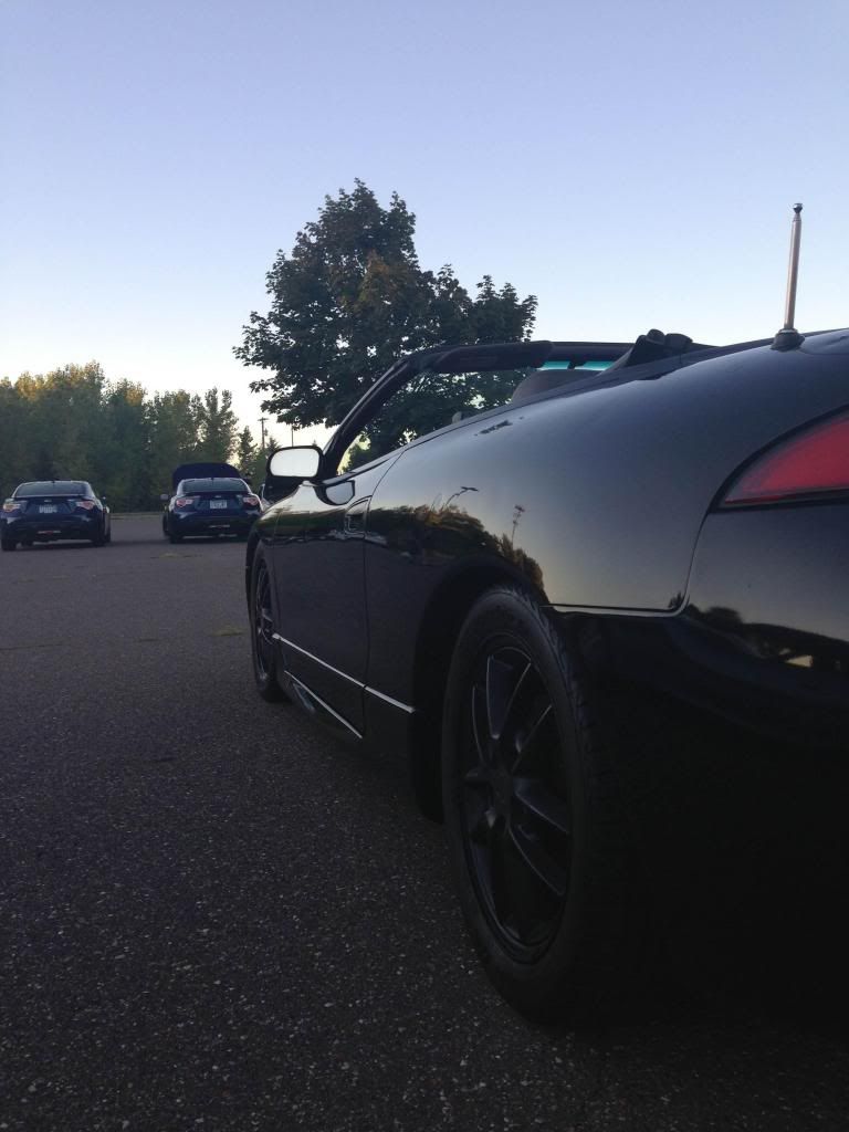

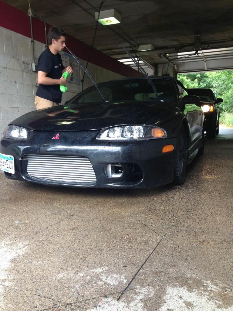

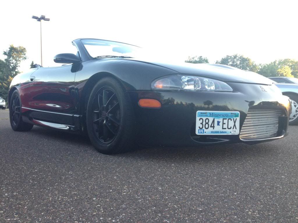

Hey guys, so far I have put 350 miles on the new clutch setup. Found out I have bad slave cylinder and am going to try to replace that tonight. Other than that, nothing but good news. The black top cas did in fact solve my knock issue. I did a few pulls at 23 psi, 11.8-12.2 a/f ratio, no knock, and only going to 5900 rpms and my link estimate was 450 hp/417 torque. Car felt awesome! Going to switch to speed density any day now, just need to replace slave first so I can get into gear. Here are some pics my buddy took with his iphone a couple days ago:

Car looks really good!

Very nice hood .
