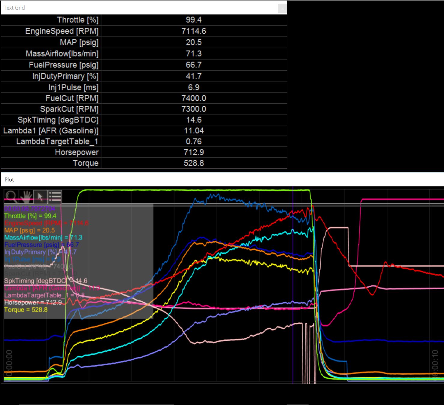

So we are starting to turn the boost up from the WG pressure (12psi) we were running before. Did a pull / log at lunch today and sent it in. I quick looked it over for myself. Looks like 24psi at about 4800rpm. Then boost gradually tapers down to 20psi as we reach a nice conservative redline of 7300rpm.
Car finally feels like it woke up too! I'm paying no attention to the HP / TQ curves on this graph, but it does look like we're starting to touch 70lb/min airflow out of this little 61mm (and still at lower boost levels!). Looks like he has the AFR pretty safe at 11.0 and timing is still pretty conservative (10*-11* most of the time in boost, but peaking at 15* at redline).
Anyhow, the fun part is finally underway!

You must have some real garden hoses to only be at 41 IDC!

Little Update. Got the updated tune in. He turned up the duty cycle on the boost controller and didn't make any difference at all. So I started to wonder what spring (or springs since these can have up to 3 springs installed) did I actually have in my WG. Looked in my tool box and found the 7psi spring that originally came in it, and I found the 5psi spring that I bought along with a 10psi spring, that I thought I installed together. Also found an 11psi spring that I didn't even know I had.
SO I pulled the WG off and cracked it open. Only one spring was installed (assume it's the 10psi spring). Damn, this whole time I've been thinking I had both the 10 and 5 in there so I had 15psi of spring in there. Dumb mistake
What I find very interesting is how it tapers down to 20psi, and they always say the general rule of thumb is you can only go about twice your WG spring. So that pretty much seems right on the money in this case.
So I'm going to hit up Vlad to see what he prefers I put in there. With the springs I have, I can combine them to make 15psi, 16psi, 18psi, or 21psi. I'd like to just throw the 21psi combo in there because why not I don't plan to boost lower than that. But I think Vlad wants less because he'd like to have a safe pump gas tune which would be closer to the 16-18psi range.
So Andrew you had asked why the boost is tapering the other day, this might be the smoking gun!

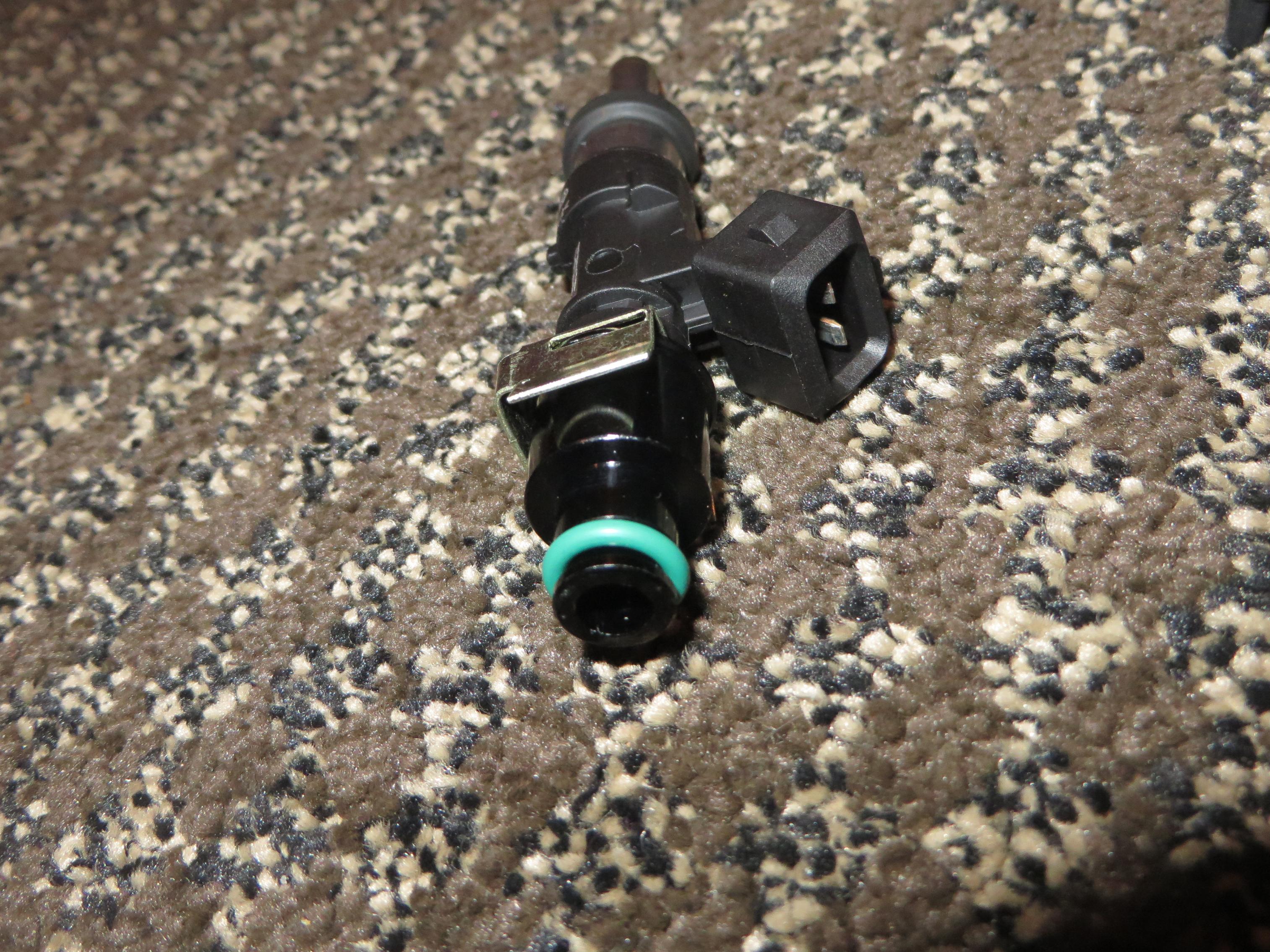

Got a couple pulls in today. So my latest tune we're now up to 25psi. Haven't done a pull with it yet but the car is feeling good. Too good cuz 3rd gear is about useless so I'm having to do my pulls in 4th gear (No Jail Preeze).
Also, got my new injectors today. FID 1600 high-z. Going to wait a little while to install them as I want to keep moving forward with the progress we're making on the logs/tune for now.
