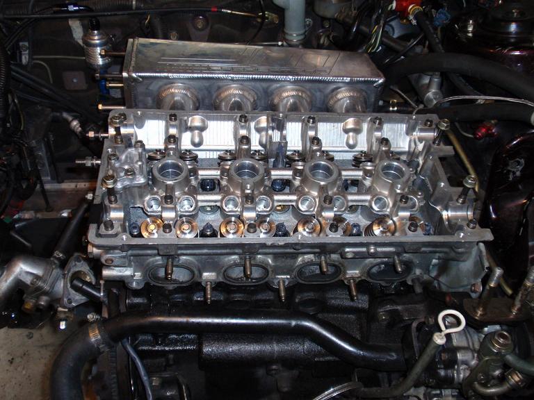

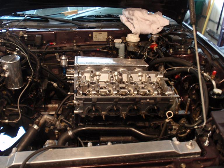

Got the head torqued on. I decided on 95lb/ft.
Got the cams in and torqed, kinda. I've tried to be real particular about placing everything into seperate plastic bags, but apparently I still managed to lose a singe cam cap bolt. If anyone has one, let me know.
Timing belt is on. Also put in a new tensioner pulley as well while I was in there.
Also picked up a new axle today. Thanks to Shane for hooking me up with an exchangable core.
That's it for today. Will continue on with some more tomorrow.
