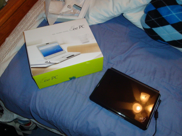

Just showed up this morning:
My Asus Eee PC Netbook! I already have Link V3 on there ready to go!
This thing weighs like 3 lbs with the 6-cell battery. It's tiny! I like the multi-touch touch pad. It has a N280 processor (1.66ghz, the fastest you can get right now), wireless b/g/n and bluetooth, 160GB HD, 10" screen, and it boots Windows XP really fast! I got this just for link lol, and internet browsing.
