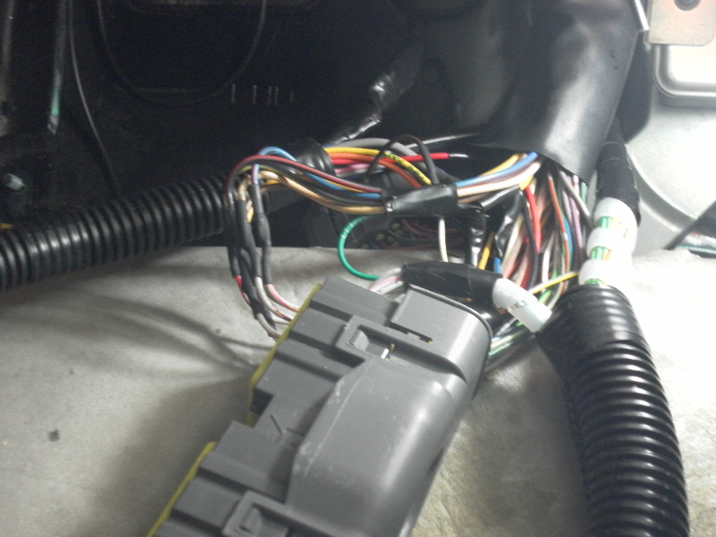

Started on Phase 2 of the MS3 install. The injectors and ignition are all wired up. I had to actually cut these wires, and solder and heat shrink them to the MS pigtail, since MS is taking over full control of them, stock ECU has no control of them anymore.
I need to run a vacuum line to it now for the MAP sensor, then get a base tune from Jordan @ Powersquirt, and another start-up video shall be made
